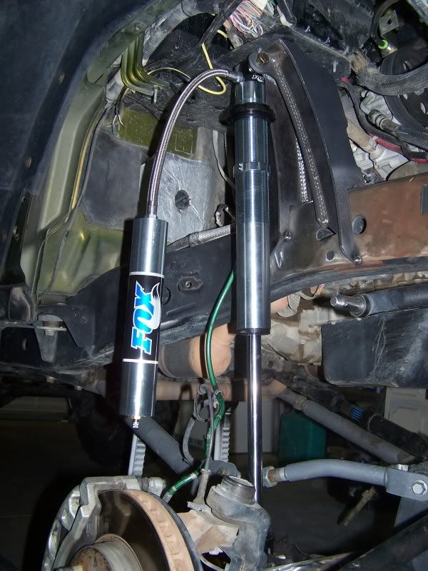

Well guys I was in the market for a Weld in Coilover system and The guys at Tribe 4X4 came through. I went form the Bolt on Coilover mounts to these so the teardown was very simple.
Once the old setup was removed. I found a good sawzall and a few good blades yeilded the best results to remove the factory mounts. ALWAYS CHECK CLEARANCE WHERE YOU ARE GOING TO CUT.
Here are some shots of the frame rails and axle all cleaned up
This is the pile of scrap that you will have when your finished....

Here is the initial fit of the towers. They fit almost perfect, just needed a quick kiss with the grinder on the rear edge to get them flush on the frame rail.
The lower mounts were welded on after the test fit with everything tacked in place and the suspension cycled a few times.
And here are some photos of the towers all burned in.

Im still waitin on a set of springs so im done for the evening. I will post some more pictures after paint and with the Jeep standing on its own feet

While im waiting on the other set of springs ill start the Poly Performance Rear Setup tommorow

All total I have about 5 hours to the point im at now.
I still need to piant the towers and frame rails, And install the springs.
I havent found a place I like the resivors just yet so ill play with it a bit more tomm

Why would you not paint most of the bracket before welding it in? Just leave the edges unpainted....now youre going to have to mask off half your engine bay and wont be able to paint the back side...?
And seond whats your reasoning on going from bolt on to weld on?
One step ahead of you I primed and painted the rear and top before welding.
The main reason i went with the bolt on setup was $$$. I have wanted to to weld on towers for a while and Tribe released these and i knew i had have them
