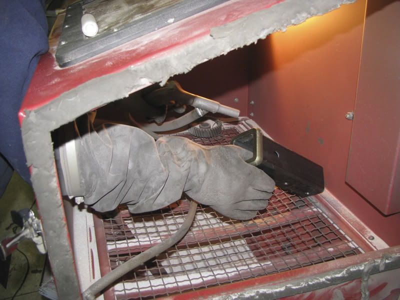

SANDBLASTING – Cool, Boring yet Satisfying

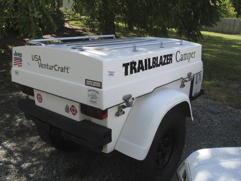

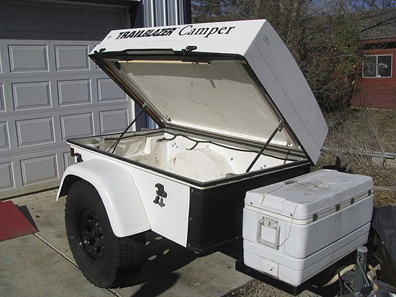

I began determining what I wanted to do with the camper. I decided that when Spring arrived I would paint it to match my Detonator Yellow 08 Rubicon Unlimited. With the painting figured out I started examining the camper and quickly realized that with a white or yellow camper I didn’t particularly like all the external hardware fittings being either dull aluminum or chrome. I decided that all fittings should be black. This left me with a problem and an opportunity. If I wanted everything to become black I was going to have to remove everything and sandblast the pieces prior to having them powder coated black.
I mentioned to my friend that I was going to remove all the hardware on the camper and take it all to be sandblasted. He told me that in the back corner of his garage he had a sandblasting cabinet. A sandblasting cabinet is a relatively simple device. It is essentially a box with an internal light source, a viewing window, and two holes for your hands/arms. Quite often the holes have permanently affixed gloves like you see on a baby incubator. Here are some photos of a relatively inexpensive (~$300) Sandblasting box. Harbor Freight has a Sandblasting Cabinet like this on sale starting January 1st, 2011 for $199.99.
You will also need an excellent air supply. Beyond that you don’t need a whole lot more. If you don’t feel like buying a sandblasting cabinet you can build one fairly easily. All that is required is a sealable box large enough to hold whatever you wish to work on. It must have a pressurized air line in it as well as a media (sand blasting material such as glass beads, walnut shells, sand, etc…) supply line. It must also have a grate in the bottom to allow the blasting media to drop out, be recollected and fed back into the cabinet. Finally, you will also need a light and a viewing window. Keep in mind that you can buy a commercial unit such as the one displayed in the previous photos for less than $300.
Before going any further I should state that if you are going to be sandblasting fairly delicate parts you should carefully experiment to make sure you don’t over blast, and hurt, the parts. You can pit, or scar, metal without too much trouble. Practice will really help. I should also state while sand blasting is relatively easy it can also be somewhat tedious. However, stick with it because the results can be amazing. I used very small grain glass beads for my sand blasting. They are inexpensive, easy to work with, and don’t tend to hurt smaller pieces such as the aluminum parts I was blasting. Here are some “before and after” sandblasting pictures where I then went on to powder coat the pieces in satin black (more on that a little later).

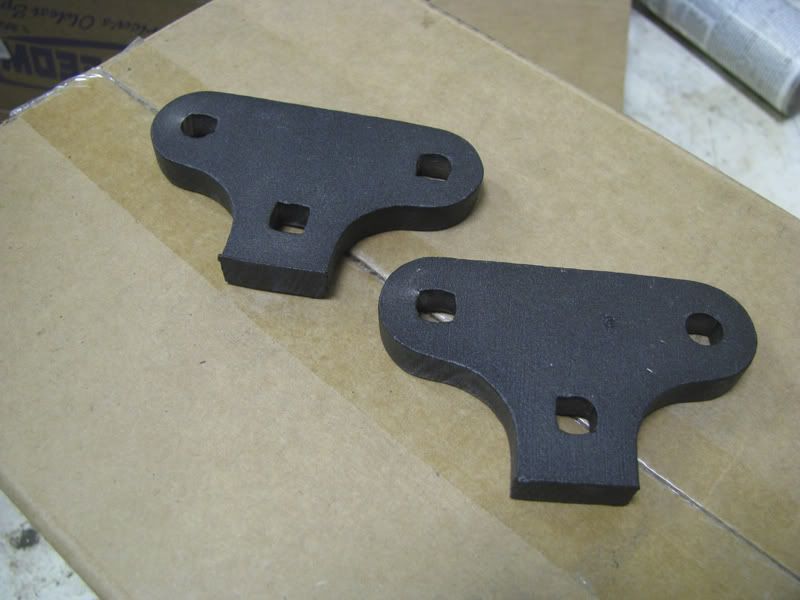

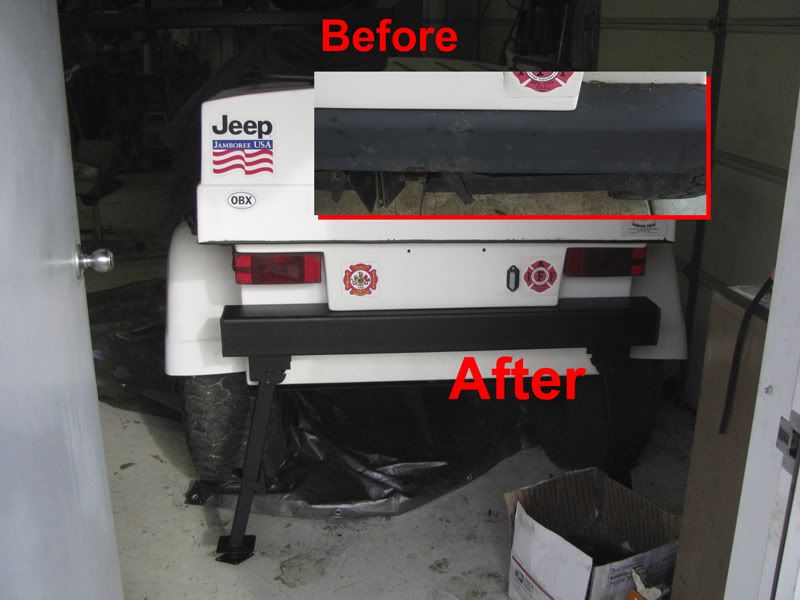

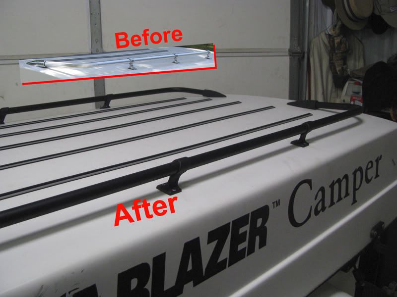

Lets look at a specific example of a piece “before & after” it is sandblasted. The piece in question is a 2” x 2” Receiver Extension that will be needed on the tongue of the camper.
Please note that in the picture of the newly sandblasted 2”x2” Receiver Tube I have committed a faux pas. My friend is hanging it in the oven to preheat it prior to powder coating (this is a required step due to its large size). The faux pas is you can see my fingerprints. Normally this wouldn’t be a big issue but if you are preparing for powder coating then you need to keep surfaces clean and oil free.
I had to sandblast several large items such as the rear bumper on the camper as well as the three skid plates that protect the underside of the offroad camper. When the items you wish to clean are large you will most likely need to utilize a non-enclosed blaster. This is typically where most people will want, or need, to go to a professional. It takes a lot of room and is seriously messy to perform non-enclosed sandblasting. This sort of sandblasting is typically done at higher pressures and with coarser sandblasting media. I did this in preparation for double powder coating those parts o give them an extra strong protective coating.

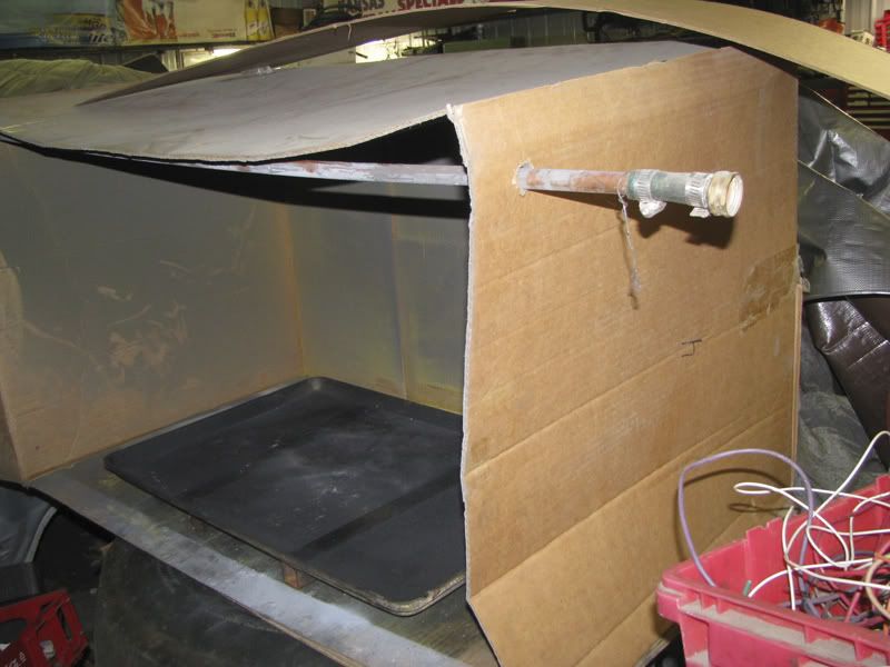

Now for the HOW? It does not require much space or money to perform powder coating. It takes a small amount of electronics, a special powder-coating gun, a bottle of powder coat, and a powder-coating chamber. As you can see in the following pictures, I have created the lowest cost powder-coating setup possible. I purchased the powder coating electronics from Harbor Freight for $60. That price also includes the powder coat spray gun. I also bought a container of black powder-coat from Harbor Freight for just $4. I created my powder-coating chamber from an empty cardboard box and I used a copper plumbing pipe as my negatively charged metal rod. My total cost was $65. I plan to build a Masonite chamber after the start of the year.

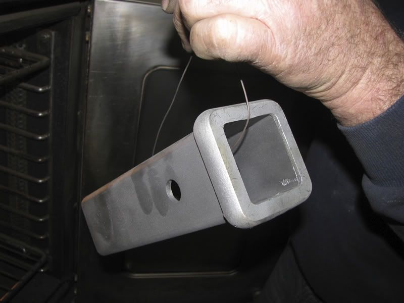

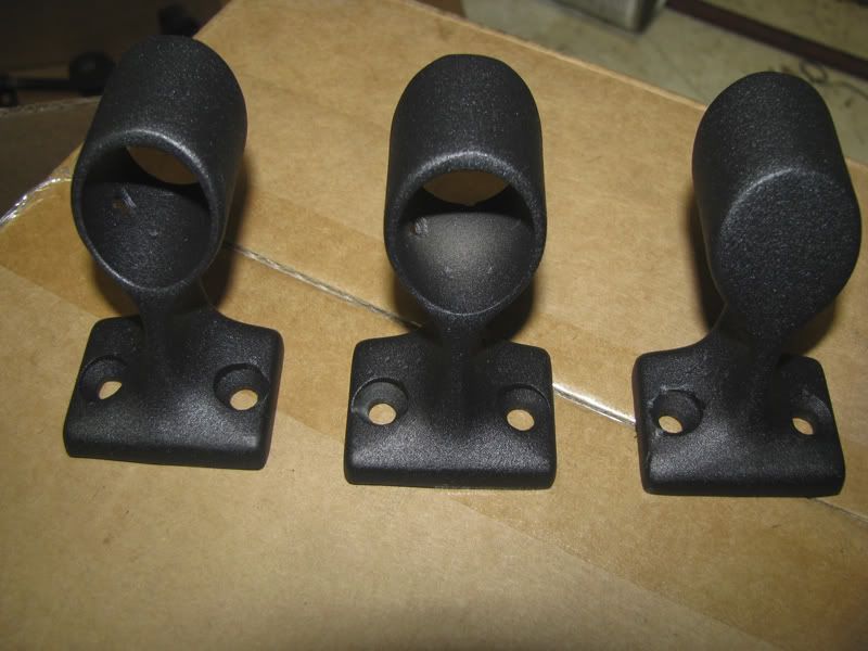

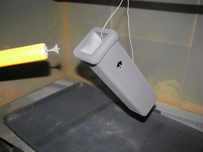

To start out, connect a lead from the electronics to the metal rod in your powder-coating chamber. Then take bare metal wire using it to create a hanger/hook to suspend your clean metal parts on the charged metal rod. If you have fairly large, or thick, parts you will need to put it in the oven and pre-heat them before powder-coating. The pre-heating is done to ensure the parts will quickly reach 400 degrees F when placed in the oven after being powder-coated.
Now connect a lead from the electronics to the powder-coating spray gun. This will cause ionized powder-coat particles to be blown out of the gun where they will electrostatically adhere to the parts hanging on the charged metal rod. Here are a couple pictures of what this looks like. Please note that if you get the spray gun too close to the parts you will cause an electric arc to jump the gap between them. Avoid doing that.
Once the parts have been powder-coated they must be carefully moved from the powder-coating chamber to the oven. It is critical that you do not touch, or accidentally brush against, the parts while you move them. The slightest touch will remove the powder coat, which is only held on the metal by a weak ionic bond. I see people who appear to have an easy time moving parts without touching them. I am not one of them. If you are dexterily-challenged like me then you might want to take some precautions. I avoid touching coated parts by using a pair of pliers, rather than my fingers, to grasp a part’s wire. I lift parts off of the negative rod (copper pipe in my setup) and carefully walk them about three feet to where I hang them in the 400 degree pre-heated oven.
You can powder coat items of any size, assuming you have a spray-chamber and oven of sufficient size. Most people will have limits on the size of items they can powder coat due to the size of the oven they have. As seen here, my friend’s oven came out of a grocery store that was being torn down. He got it for free and it allows him to powder coat items up to the size of a couple of toasters (sorry, I couldn’t think what else to use as a common reference).
The only requirement for a powder-coating oven is that it needs to be able to sustain a heat of 400 degrees for 20 minutes. I have seen a lot of personal powder coating that takes place in ordinary home ovens, which have been moved into garages. This may seem obvious but it is extremely important to use care when removing parts from the oven, especially if they are larger parts (they will hold heat for a long time). I have found an infrared temperature gun to be a fantastic tool. They can be bought for less than $40 and can save you from a serious burn. This is especially true after you have removed parts from the oven but aren’t sure how hot they might still be.
Here are some samples of the parts I powder-coated during the process of cleaning up the camper…

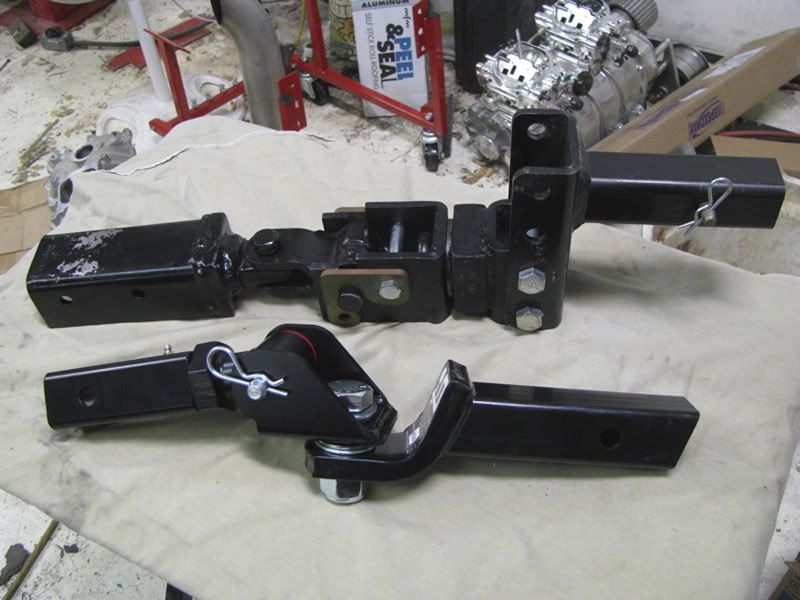

HITCHES – HITCHES - HITCHES
In the process of purchasing the camper I commented to the previous owner that I was going to need to find a Pintle & Lunette since the Ball hitch wasn’t going to work for off-road use.
2008 Rubi Unltd • RR Roll Cage - Limb Risers - Evap Skid - Diff Covers • PolyPerf HD Ball Joints • Reid Hi Steer Knuckles • RK 3.5" Triple Threat PRO Longarm • Rebel F & R Coil Overs • sPod Mini • Shrockworks Rock Sliders - Rear Bumper w/ Tire Swing • Xenon Flat Flares • ORO Onboard Air • BD Dual Battery • 5.13 Gears • 35" BFG KM2s • Warn VR12000 Winch • Safari Straps Everything • Tuffy Security Drawer •
Hemo is offline
post #5 of 25 Old 12-29-2010, 03:44 PM Thread Starter
Hemo's Avatar
Location: Kansas
Posts: 214
Send a message via AIM to Hemo

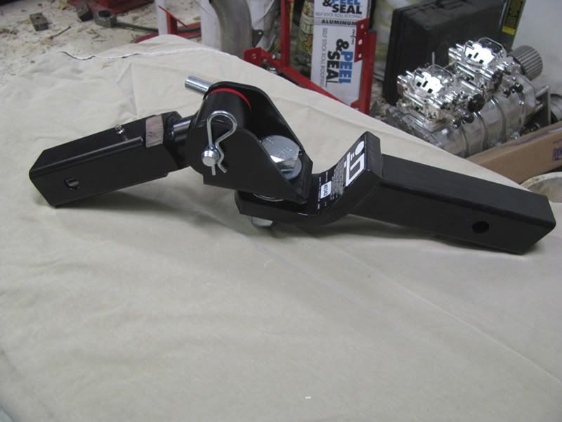

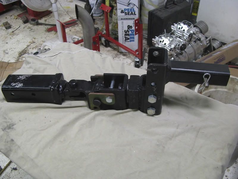

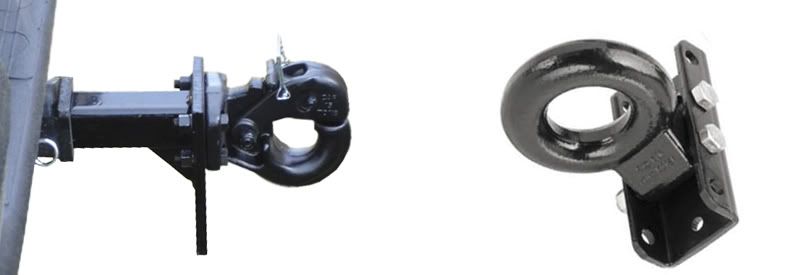

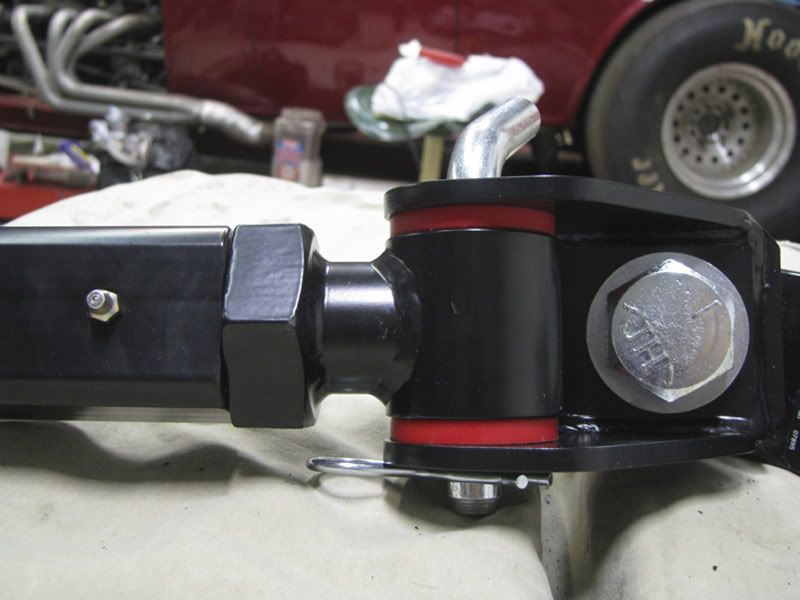

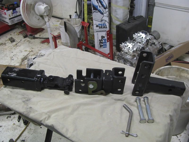

He informed me that I did not want to use a Pintle & Lunette since they are very loud & clunky. He pointed out all the clunking is really lost energy and shows up in the form of frayed nerves and poor gas mileage. He suggested a company by the name of Lock-N-Roll (http://www.locknroll.com/index.aspx). He told me about their unusual hitch that allows movement in numerous directions. He said he was planning on purchasing one prior to deciding to sell the trailer. I visited their web site and found the limited pictures to be interesting but there really wasn’t sufficient info to answer the questions I had. So I called the folks at Lock-N-Roll who were quite nice & patient. They explained all about their unique hitch system. The descriptions sounded intriguing and I found myself ordering one shortly thereafter. The hitch system showed up about a week later. I was surprised at the weight. It is BIG and SOLID. Actually, that is an understatement. You quickly get the feeling, based on weight, you got your money’s worth. It is a very unusual design and I was looking forward to installing it. Unfortunately a number of other projects got in the way.
Fast-forward a couple months. I was aimlessly looking through various Jeep-related browser links on my computer. I have thousands of links associated with Four Wheeling, Jeep equipment, Trails, etc… As I was looking through my links I decided to look at Kilby Enterprises (http://www.kilbyenterprises.com/). I wondered if they had finished going out of business. I had always liked their products and was always impressed by how often Brad Kilby’s name showed up in association with various Jeep events. I went to Kilby’s site and when it loaded I immediately noticed it was under new management. There was a link at the top of the page that said to click there to discover the latest news. It jumped me to a page and THERE IT WAS! It was a vision! It was “THE MAX COUPLER”.

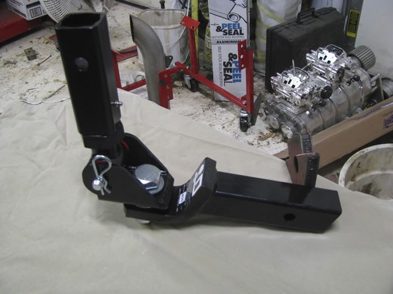

I was immediately struck by the thought it was superior to hitch I had already purchased. I found myself staring at what appeared to be an incredibly well designed off-road trailer hitch. The more I stared at it the more certain I was that this was the hitch I should have bought.
As I muttered a number of expletives to myself regarding missed opportunities I called Kilby Enterprises to order a few air fittings from them. The secretary told me she needed to put me on hold and that she would get someone to take my order. A pleasant gentleman came on the phone and took my order. He said he was pretty certain he had most of the items but wasn’t sure about a few of them. He said he was still trying to get a handle on his inventory. I immediately inquired if he was the new owner, which he was. I spoke with him for a few minutes and was quickly struck by his passion for the new business. I casually mentioned that I wish I had known a month or so earlier about him. When he asked me why I told him I was highly enamored with the Max Coupler. He informed me he was the designer of it. I congratulated him on a fantastic design. He asked me again why it mattered that I hadn’t seen it a month earlier. I said I had bought a different off-road hitch. It turned out he was familiar with the hitch I purchased.
To make a long story short, after listening to him for a while I became excited about how much effort, time & passion went into the design of the Max Coupler. I knew I had to buy it, and I did!
When the Max Coupler arrived I tore into the box. The first instant I held it in my hands I knew I had made the right decision. The design is outstanding. Here are some images to help you get a better feel for it.

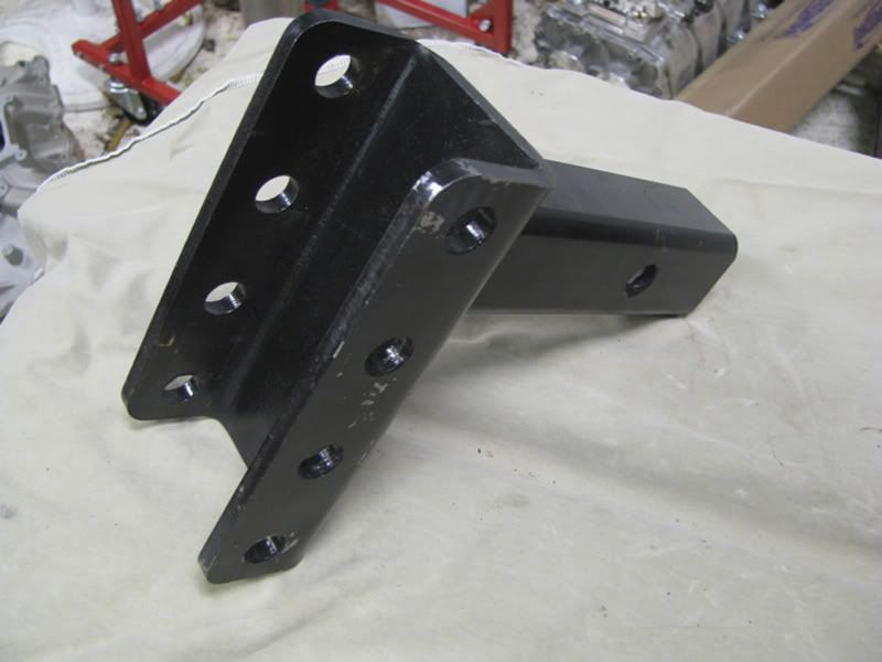

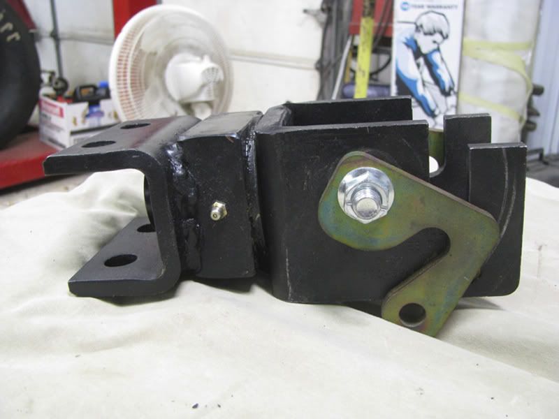

While the Lock-N-Roll is likely a decent product there is no question in my mind that the design and operation of the Max Coupler are superior. Here are images of the Lock N Roll.

I would like to stress that the things I have been writing are my beliefs. I leave it up to all of you to draw your own conclusions. For all of you who are considering the acquisition of an off-road camper I hope this information might help you to make appropriate decisions right from the start. Here are images of both systems together.
There are two areas where the differences between the two hitches are easy to see. The first area is the overall size and weight. The Max Coupler is significantly smaller and lighter yet has a 6000pound rating. The second area is the fit and finish. The Max Coupler has a very polished appearance where the Lock N Roll has much more of a rough appearance.

Those are some ugly welds on the lock and roll.
