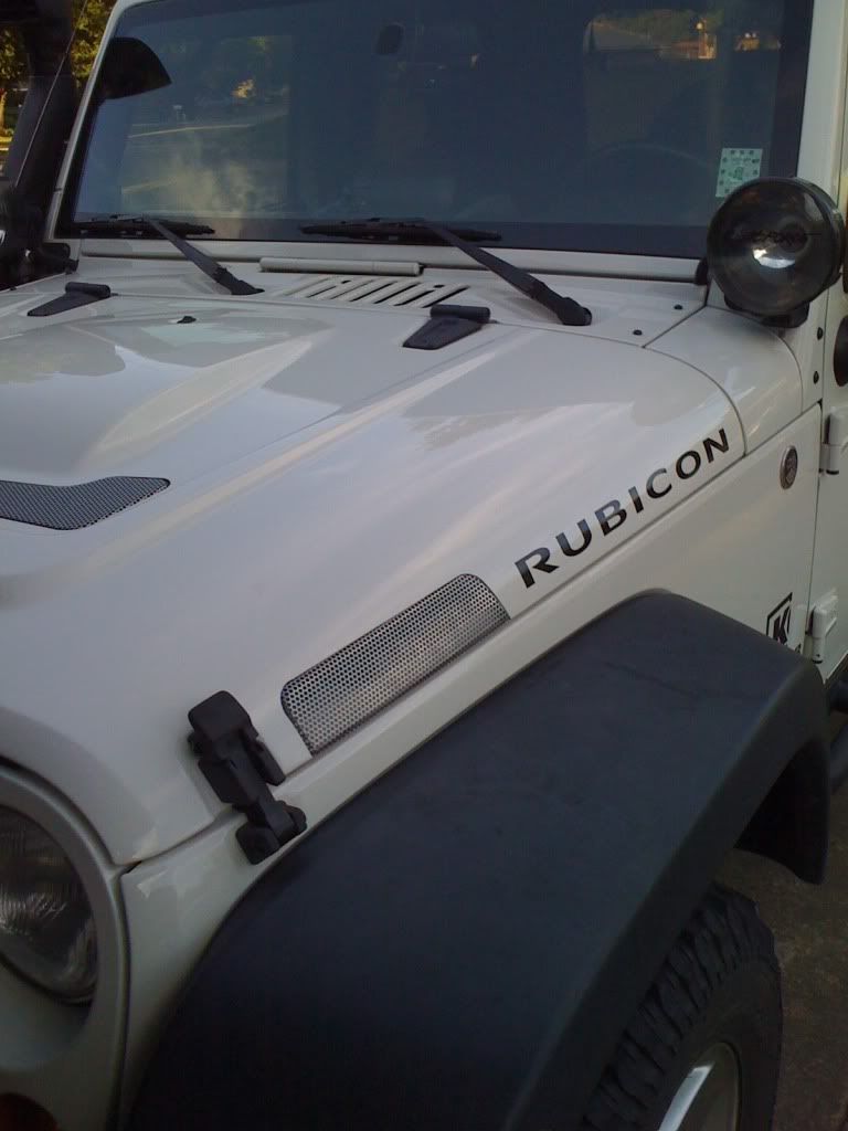

I just did the door side of mine
And both sides of the hood hinges

those look good I need to do mine may be after this winter, as mine are still ok, You did a nice job.
