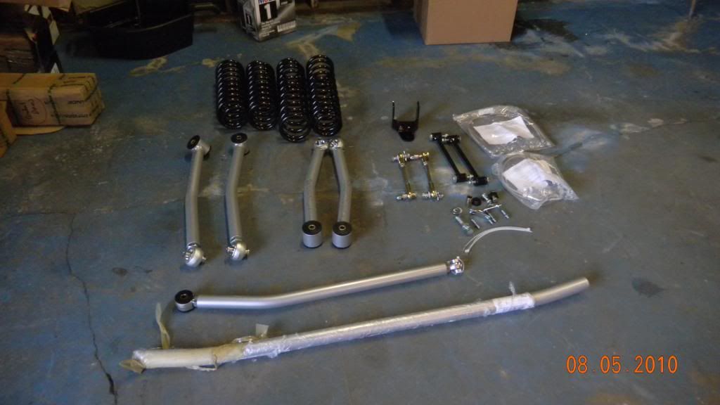

Rock Krawler Suspenions 2.5 Max Travel Pro Mid Arm System
Here you can see what you get:

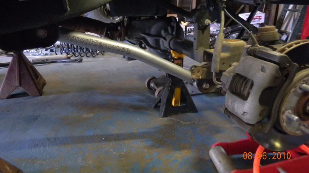

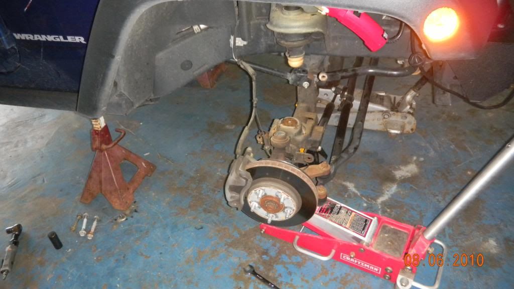

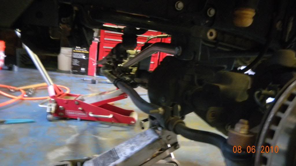

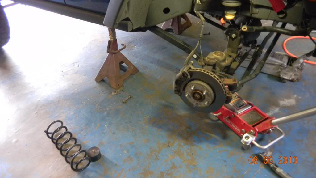

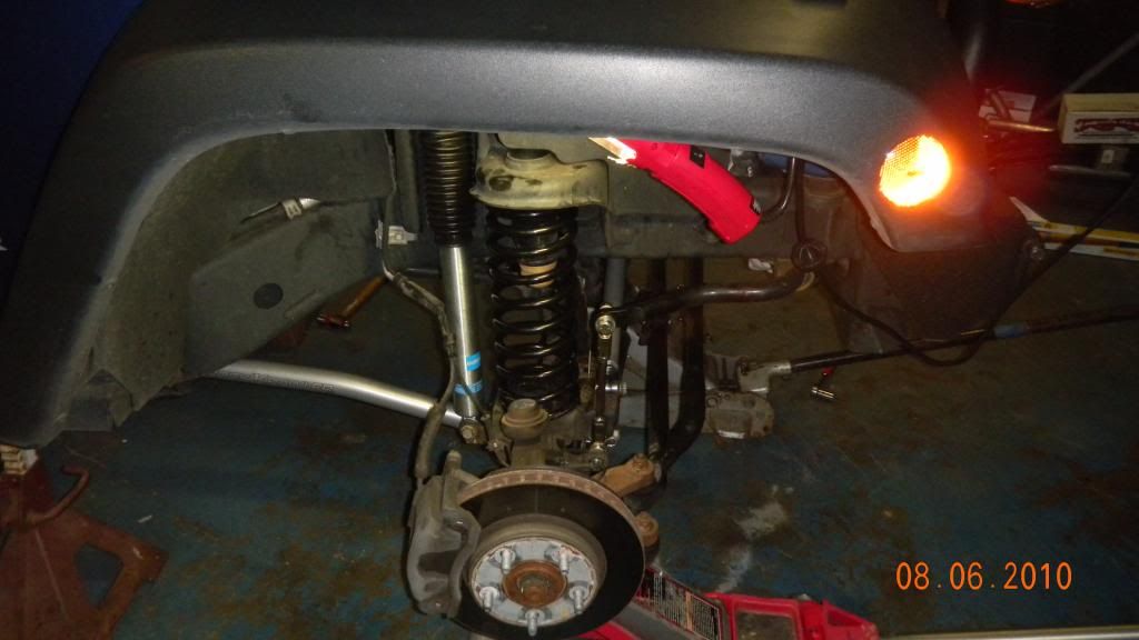

Set up the rig on jack stands and remove the front sway bar links, tracbar, shocks and springsin that order, will help)

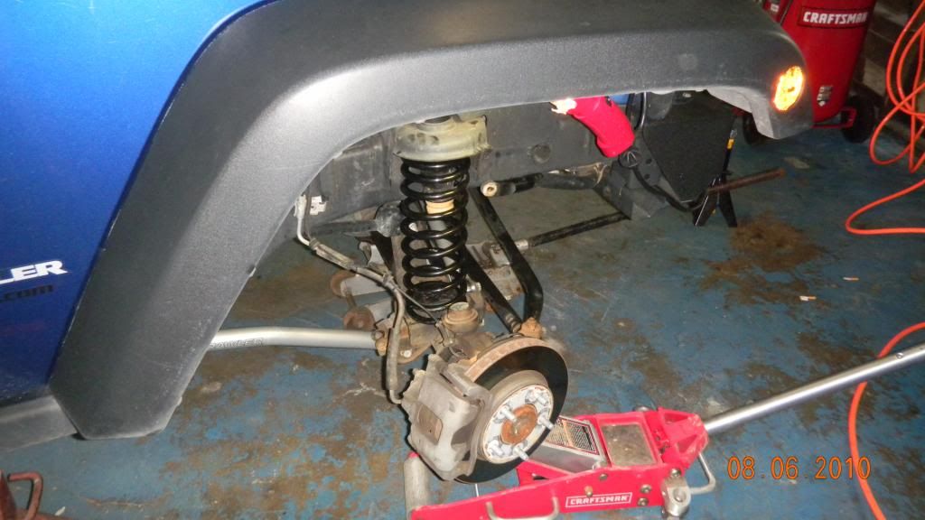

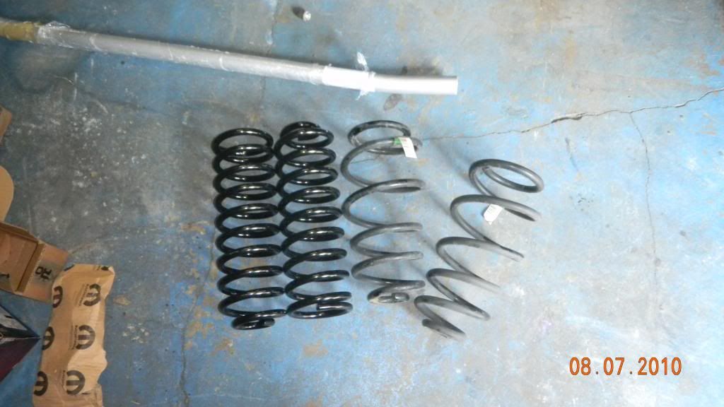

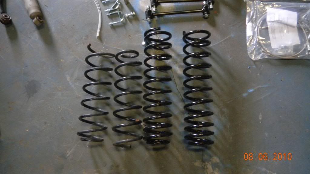

Here is a side by side of the front springs, stock vs RK. :

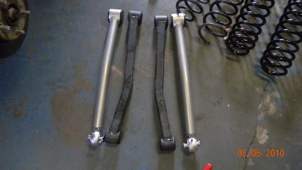

Then remove the lower control arms:

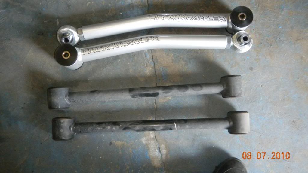

Heres a side by side of stocvk LCA's vs RK's, pretty friggin sweet huh:
Install the RK LCA's
-RK's LCA's do not use grease, they are so tight that all is needed is some WD40. Either sprayed all over em if your on the trail, or remove the little allen plug and shoot some in the hole. I did that before hand. The jam nuts, crank em down, dont be a wuss...there huge. Red Locktite is also to be used. No more than 5/8" of threads should show after locking em down.
Install the heavy duty RK front trackbar:
-again, huge jam nuts, no pussy shit...crank em down keeping an equal amount of threads on each side.
Install the front springs:
-watch the seat, make sure there spun into the seat all the way, so its hits the stop.
Install your shocks, and sway bar links. Although I have the auto disconnect, I chose to use RK's quick discos cause I like even 2wd disconnected, and the little disco motor takes up alot of room where my sunken winch will be one day, in other words its out eventually.
At this point I lowered the jeep onto the ground and tightened that trackbar and lower control arms. I had also took the 10mm bolt out of the frame to sag the brake lines. So those were also put back. This kit comes with stainless brake lines. Rolling solo, I wont be doing mine until next weekend when I get someone to push the brake peddle in for me. I hate those pump deals for bleeding, never got em to work right.
There is also a heavy duty tie rod, you need to purchase mopar ends for it, which I ordered a while ago, and im still waiting on. So, being that its a popular upgrade in itself, ill do another write up on that when I get the ends in.

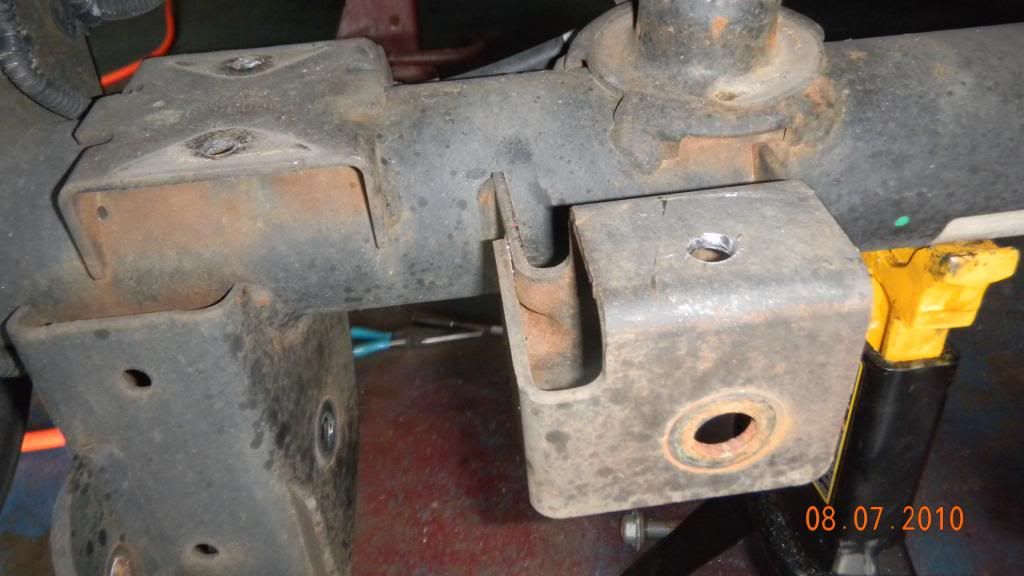

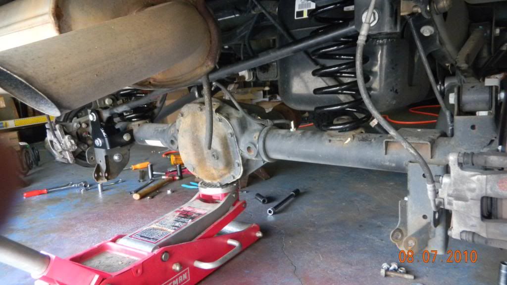

Ok, onto the rear, you need to drill, and weld(before offroading it, couple days on road is fine). I drilled....but need a 220 outlet still, so well get back to that in a sec.

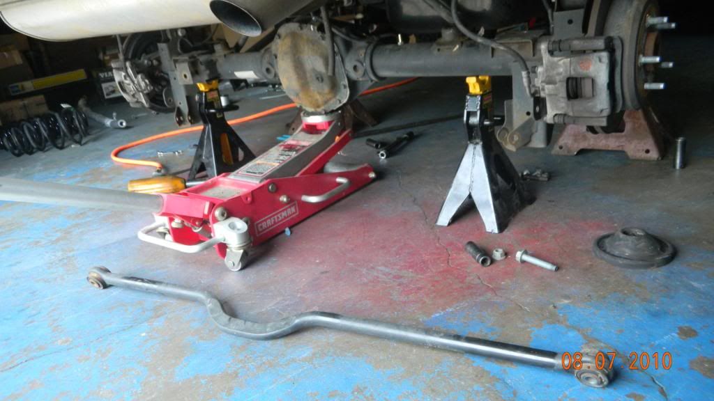

Support your rig again so you can drop the rear axle, remove the sway bar links, trackbar, shocks, and springs:
I only removed the bottom nut on my swaybar links. I then just pushed the bar and links way up out of the way. I chose to use my links cause there adjustable. RK supplies really thick nice ones set at the height you need, the bar is pretty much at 0 degrees which is where you want the rear. (i like the rear at 0, and the front at about -5)

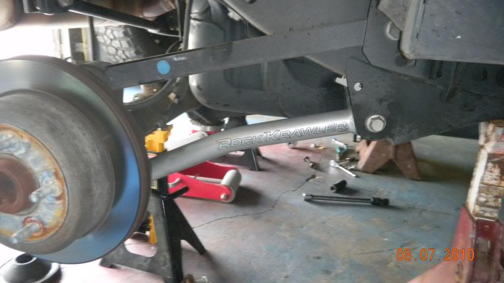

Then youll remove the rear lower control arms. Here is a side by side of the rears, stock vs RK:

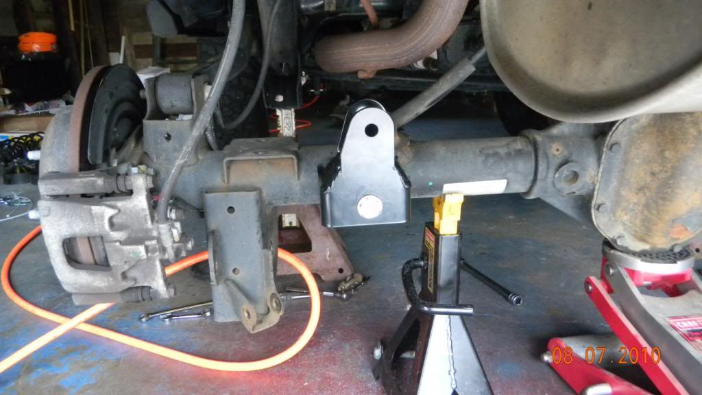

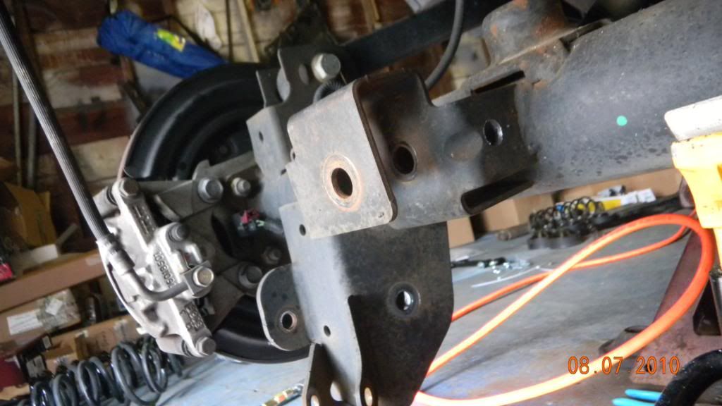

Now we go check out the super fat rear trackbar relocation bracket. This is what requires drilling and welding. Youll need a 1/2" drill bit, and a 10mm drill bit. There are two holes youll drill in the factory mount, as follows:
one on the side here:
i wish I could draw an arrow, its the hole closest to the axle tube
and then the 10mm hole on the top, like this:

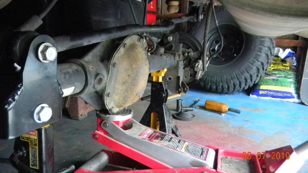

Then were ready to bolt on the new mount RK supplies:
WHen you do this, you will see the mount cradles the axle tube. There is also a little bit of space between the tube and the mount. Had the mount gone all the way to the axle tube, it would hit the factory welds and not seat correctly, so this is normal. When you weld it, the space will be filled easily.
Then I put in the trackbar:
Next, LCA's:
Then rear springs:
stock vs RK
in there:
you can also see the trackbar side hole good here
Then you install your shocks, and sway bar links. Rear stainless brakelines are also supplied, for next week I guess.
Put the tires on, lower it onto the ground, and tighten the tracbar and LCA's.
Its done, pretty easy install, myself in about 4 hours total. While drinking massive amounts of beer, so my test drive happened today, it was perfect. Goes and stops straight, the ride is.....well night and day better. I also cant feel the curb I run over getting into my driveway now. Im very very happy, and wil have some forklift flexy shots tomorrow when I go back to work.
