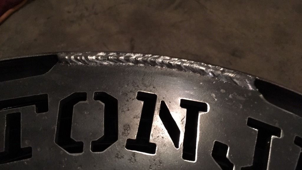

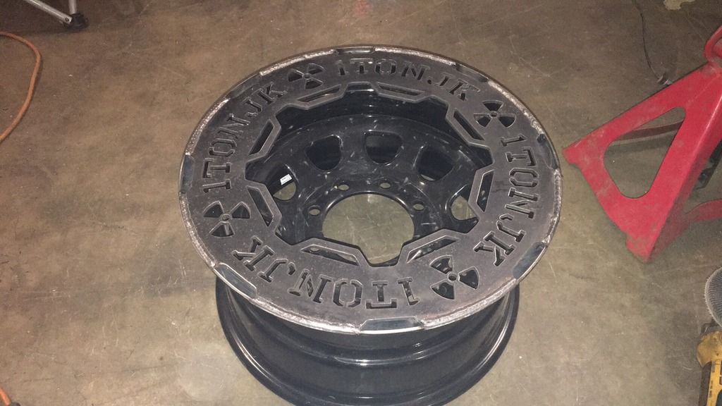

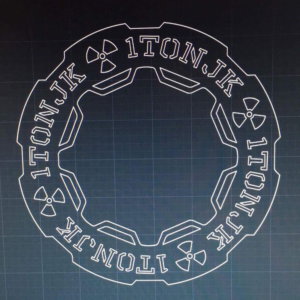

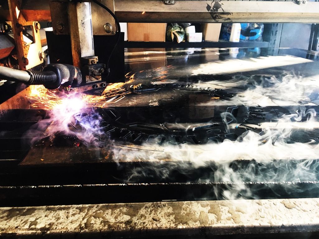

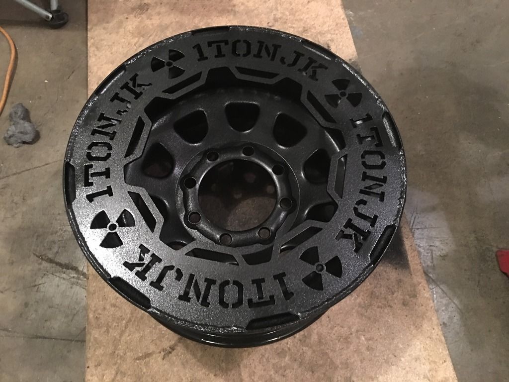

Okay. Made more progress. I ordered up 17" D window steel wheels, made some custom rock rings, and installed Inner Air Lock bead locks, and a set of 40" ProComp MT2's.
I got into a minor accident, and sheared my steering box sector shaft. So, since insurance was paying, I took advantage and installed a PSC hydro assist kit. When installing, my Metal Cloak tie rod was too close to the diff cover to install the end of the ram. So, I swapped it for a Synergy setup.
Have to say, it is gorgeous lol. The steering weight is much heavier, but you can turn the wheel with a pinky, while in 4x4 and on dry pavement.
Some pics to follow....
The rock ring design
After I welded them on:
And painted with bed liner:
