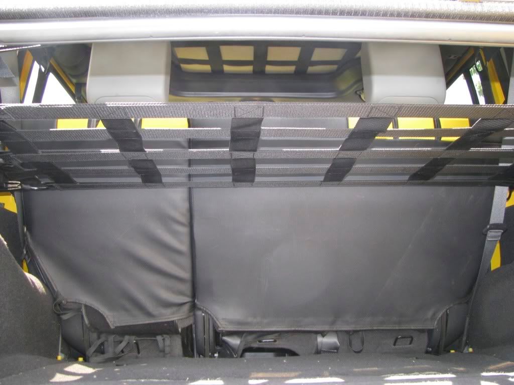

2) Here is a shot from the inside of RumbleBee looking out the rear once the Safari Straps are installed.

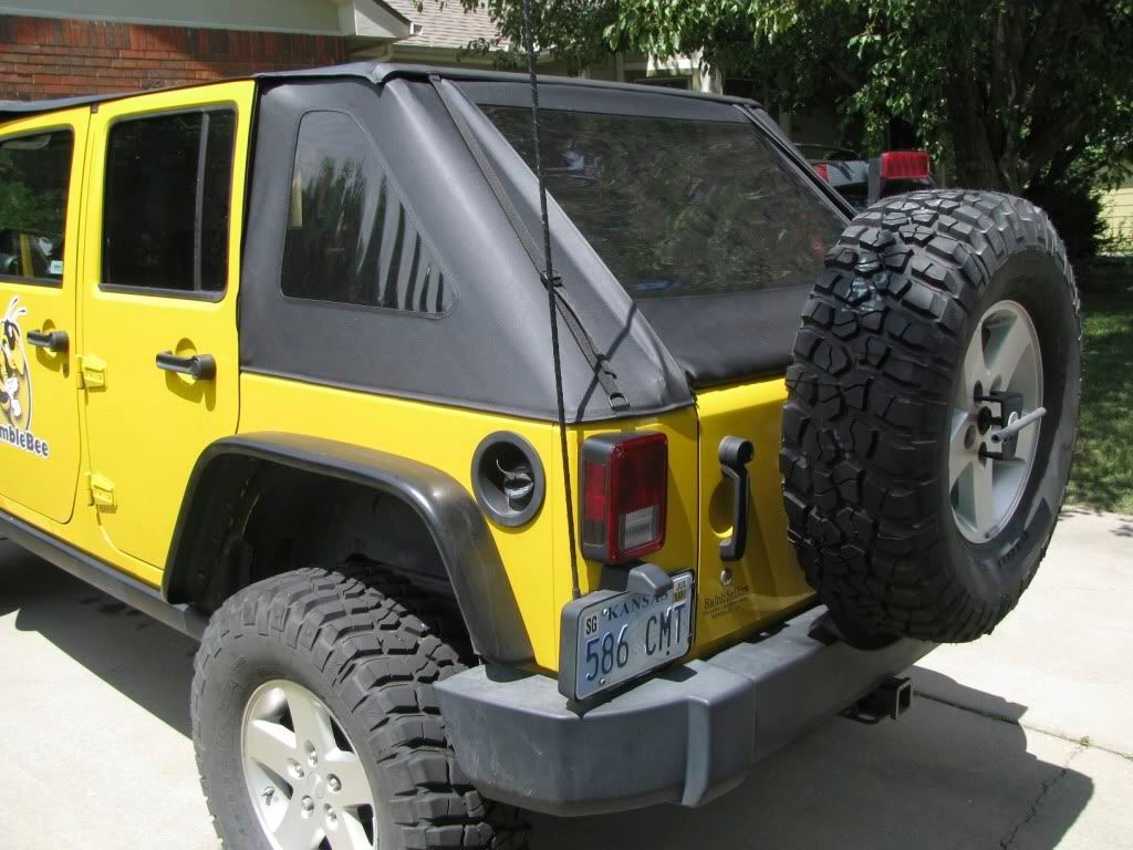

4) Here is a shot with the cool looking Off Road Heros soft top fully installed.

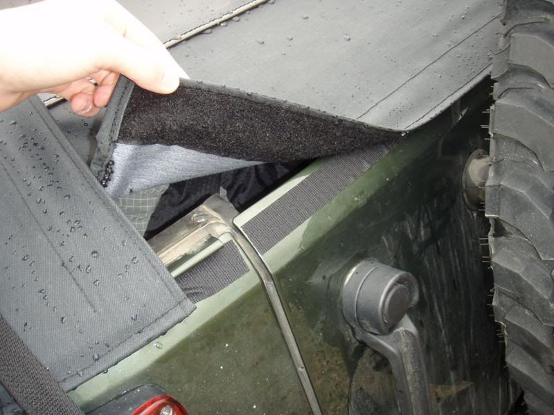

6) Normally the Off Road Heros soft top attaches to the tailgate by way of velcro. This makes it very smooth but also means you must unvelcro the bottom rear of the top any time you wish to open the tailgate.

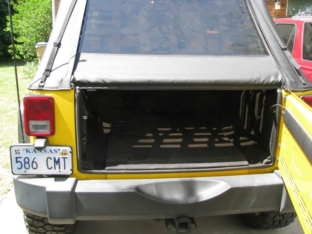

8) This is a shot with the tailgate open and you can see how the Off Road Heros top has been velcroed to the tailgate bar and still works great.
