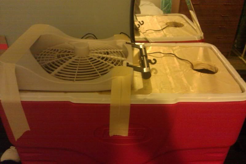

This is a quick post more for zjr than anyone. I might do another more in depth write up later. This though not a direct Jeep mod, might still be useful to some or at best entertaining to others.
Take any basic cooler and remove the lid. Next take some everyday insulating styrofoam and using two layers cut one panel for the ID (inside diameter) and other panel at the OD.
1. Using duct tape connect the two layers so the the OD layer works as a cap and the ID layer forms a inner lip to the cooler.
2. Using a 12v fan that can be purchased @ any auto parts store or Wal-mart, cut a hole the diameter of the fan. Tape to secure.
3. Now repeat the process using 2" plumbing, a single threaded connector and a 90 degree elbow. Tape to secure
4. Now for a cold source, a bag of ice or preferably frozen 2 liter bottles.
5. Plug the fan in, and enjoy.

Thanks. Between when I replied to the last message, and now I took the cooler out of the attic and built this...
Didn't have to spend a penny...
It pays to have a cooler and a fan already. I used 1" fiberglass duct board (I repair and replace a/c's so it was sitting around), and my output will be the ram air from my snorkel, while running the fishbowl up in the woods...
P.S. It is a battery or plug in fan...

I have the same exact fan, but it was too big for the cooler I had on hand. Great idea using the ram air from the snorkel...

Here is my question. If the fan is off or on, obviously the inside of the cooler will be taking in warm air constantly. Please tell me what is wrong with my idea because I dont know much about this stuff.
Take this same concept except:
-Use battery powered fan or drill small hole in cooler for fan wire and ue grommet to fill rest.
-Make brackets and mount fan completely inside cooler.
-Use pipe the same way, except a piece that you can find a cap for and cover when fan is not in use.
I could easily be missing something but to me this would eliminate drawing in warm air. This would keep it more like a cooler when not used as AC, but allow AC function when needed.

Not really... It has to take are from somewhere to replace the air moving over the ice and out the exhaust. This usually comes from the hot air source outside the cooler. I have the top from the cooler handy, and use it for beer all day, replace the ice and then a/c all night.

You would need an intake port as well. You have to draw air in from somewhere. The diameter of the intake should be at least the same size of the exhaust. You can cap the both of them off when your not using it. Or you can do what these guys did and take off the fan lid and put the original lid back on when not in use.

Actually an alternate design I have seen and even contemplated testing out is using a larger cooler that has a drain plug. Insert a piece of tubing through the plug hole and attach it to a small submersible water fountain pump.
Then using a small tranny inter cooler and a fan, you can essentially create a working loop just like what you see on a vehicle. As the cold water runs through the inter cooler it cools it off and the air from the fan is blown across the inter cooler and is cooled.
This design uses more electricity so its not as camp friendly, unless you have a power source in camp, but at that point, you might as well just bring a small window AC and call it done.
