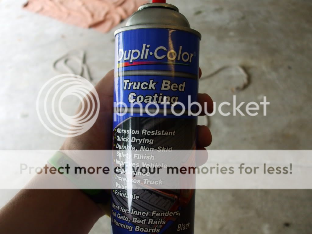

first thing you want to do is read the directions on the can.

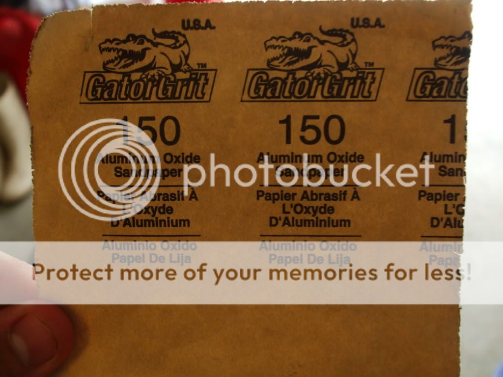

sand the item so it has a nice surface to cling to.according to my can it was in between 120 and 290 i think i used 150.

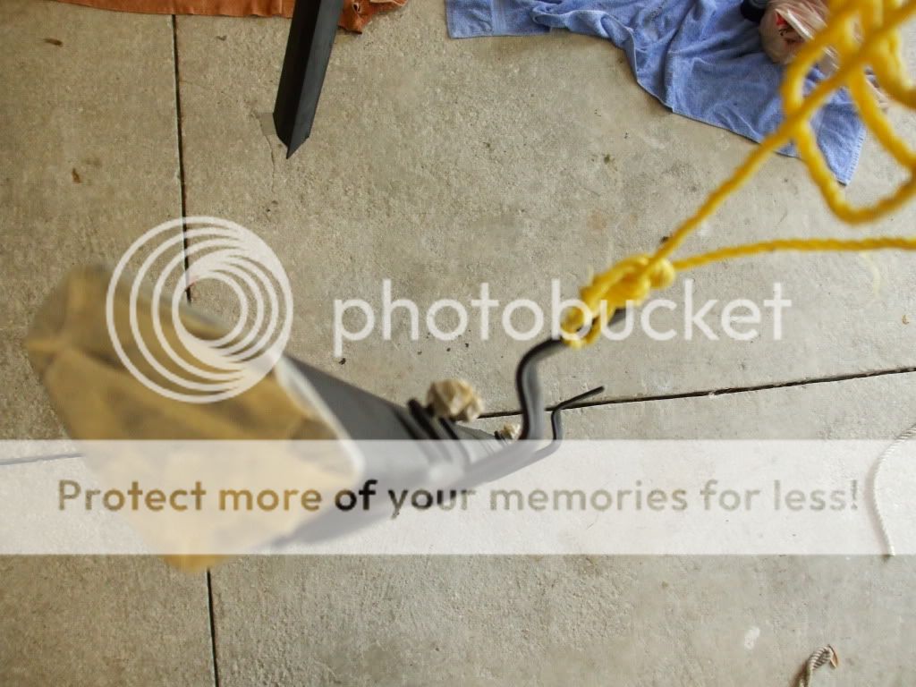

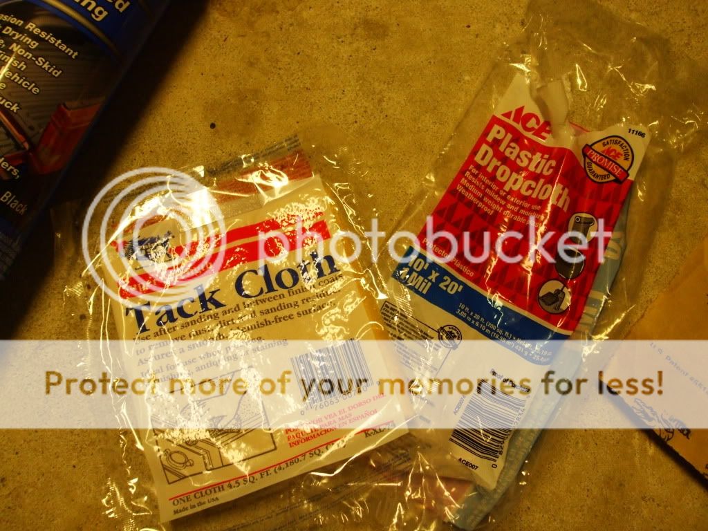

use a tack cloth to get off the remaining grease and grime.(do this after you hang them up if you want to hang the item)
mask off any areas you dont want to be bedlined with tape

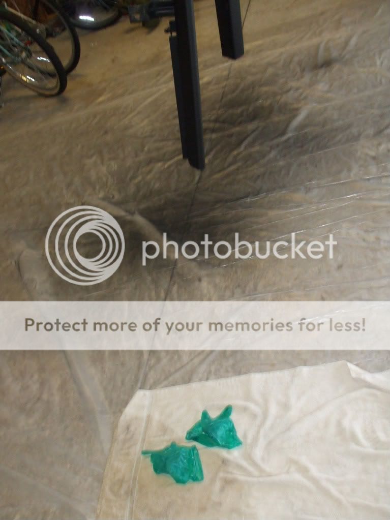

lay down a drop cloth or something so it doesnt get on the floor.

start spraying off of the item and then go on to the item so you dont get a uneven build up.
spray in one pass top to bottom if possible.
hold can 6-8 inches away.
