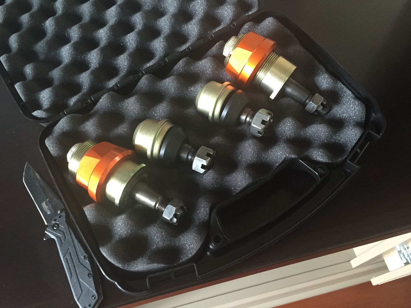

In the past I have installed a set of Mopar BJs and 2 sets of Synergy Balljoints, both of which came wrapped up and stuffed in a box. Rare Parts, however, is so influenced by quality that they ship their product in a gun case, with what other than a big ol' "Proudly made in the USA" sticker stuck right on the front. It just goes to further show that they've put so much time and energy into making these things, that they don't want anything happening to them between their shop and our door. Kinda reminds me of when I used to race motocross and the suspension company would send us a rifle case to ship the front forks in.
