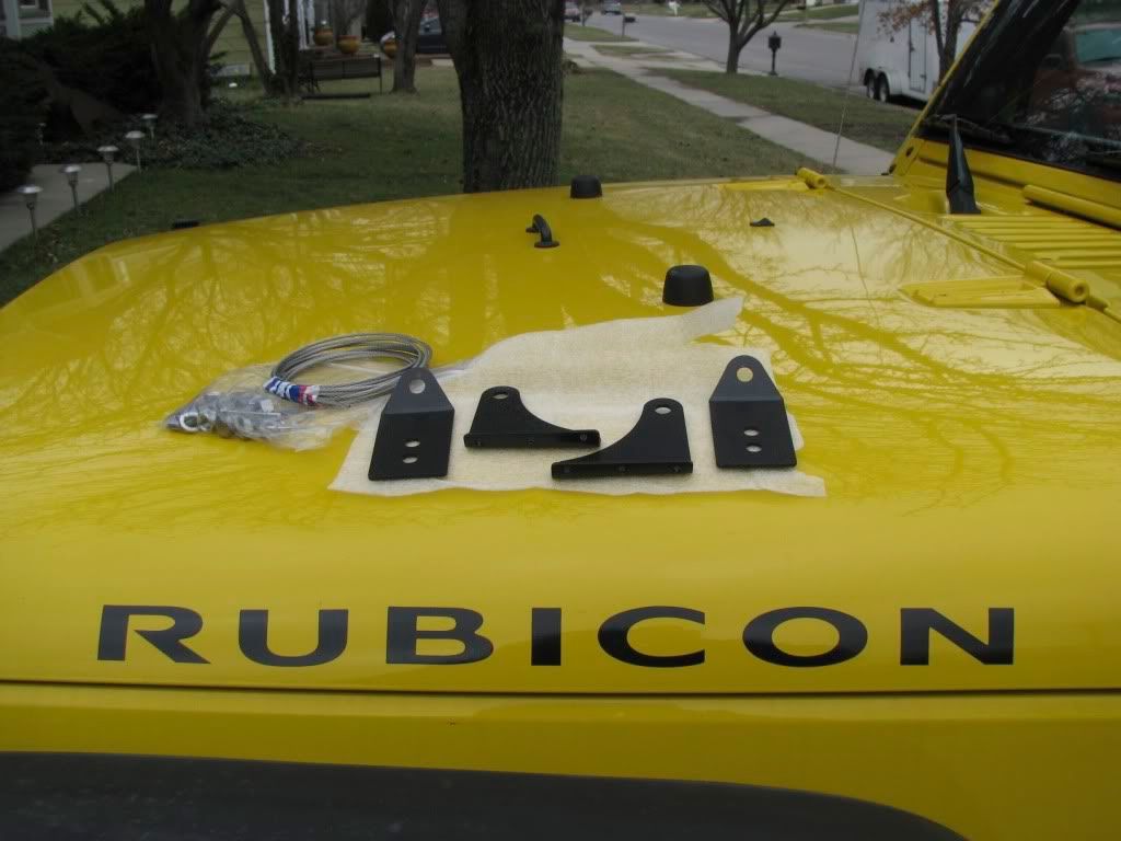

Here is what comes in the River Raider Limb Riser kit:

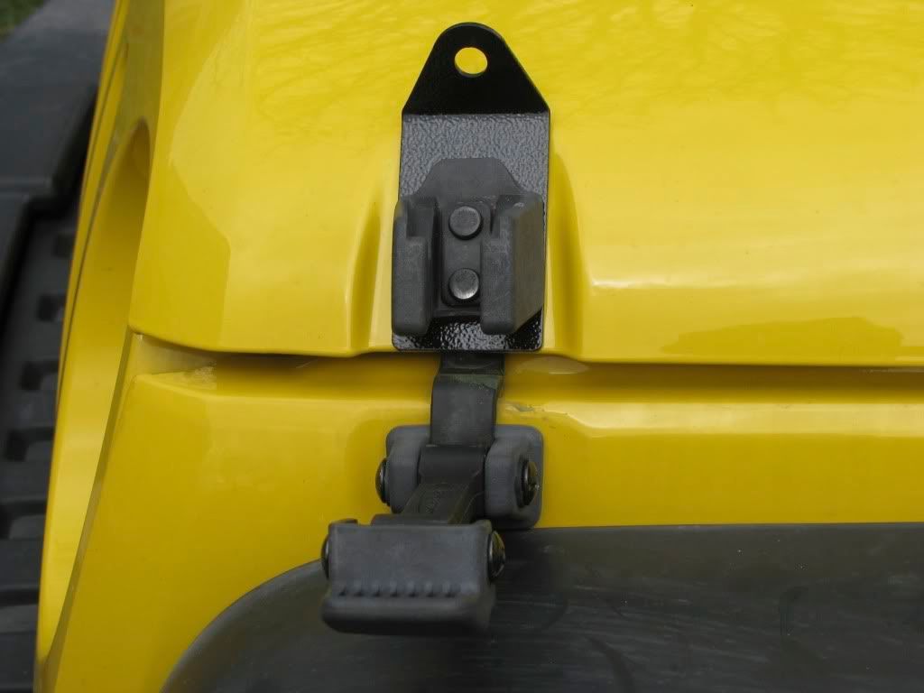

Unlatch the Hood Catch:

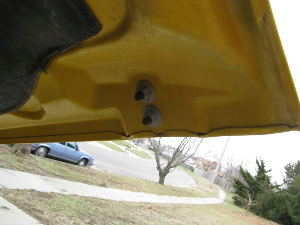

Remove the two bolts you find under the hood. You need a 10mm socket or wrench:
Clean the surface before you proceed to the next step:
Place the new plate onto the hood surface:
Reattach the hood latch:

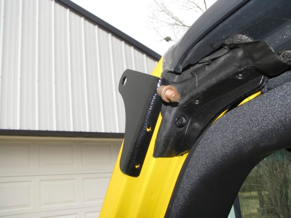

Now take the upper brackets and prepare for the only part of the process that is a little more difficult:

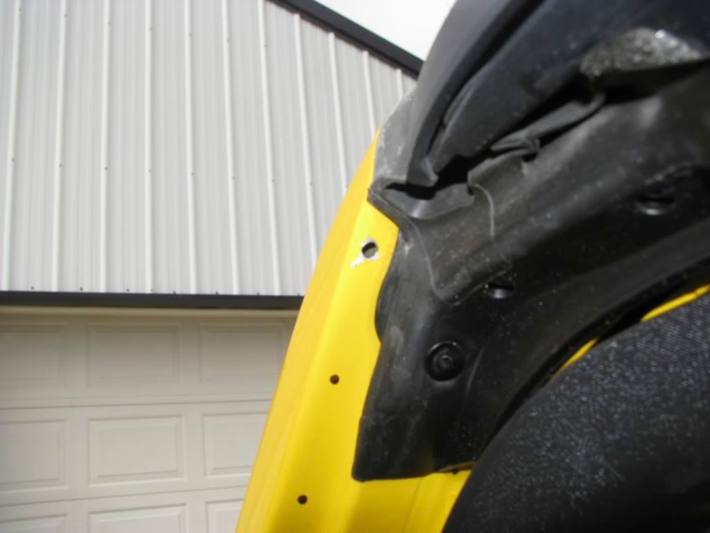

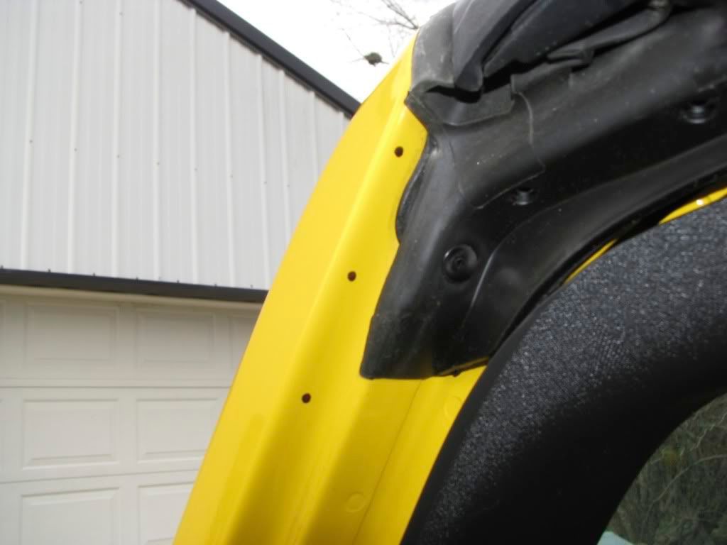

Place a bracket on the edge of the windshield so that the upper edge of the bracket is touching the rubber. Make small marker dots in the center of the three holes:
Remove the bracket and make sure the small marker dots are visible. Then use a center punch to make an indent on each dot:
Okay, that is the end of PART 1

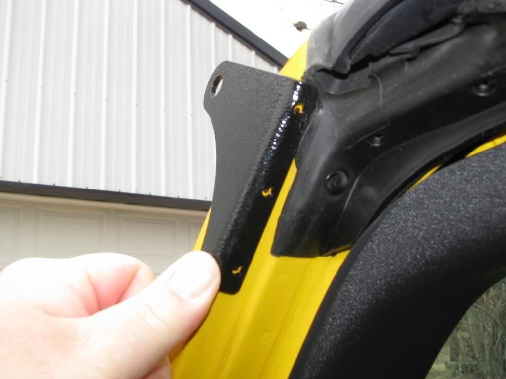

If you happen to have clecos then use one to hold the bracket in place and then drill out the other two holes. On the lower two holes you will need to drill through the outer sheet metal and then drill through a second piece of sheet metal inside:
Then using the supplied stainless steel pop rivets attach the bracket:
You can now close the door with your new upper bracket in place:

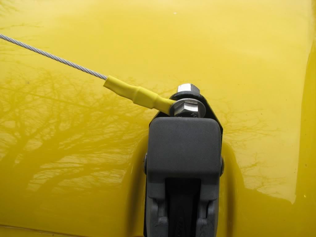

Now you can begin putting together the cable assembly. Start with one of the supplied bolts with a hole drilled in it:

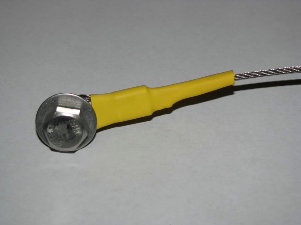

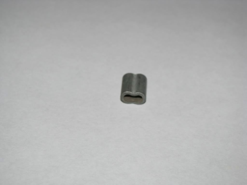

I decided to enhance the kit a little. I wanted to create a cleaner way of anchoring the cable. The normal method is to simply put the steel cable through the hole in the bolt and when you tighten down the bolt it will hold the cable taught. I chose to use a cable clamp:
Part of my approach to a cleaner cable was to use a bit of shrink-tube. I decided to use yellow so that it matched my Jeep:
To get the cable ready you first slide a piece of shrink-tube on it. Next thread the cable through one side of the cable clamp. Then put a washer on the and bolt and thread the cable through the hole in the bolt:
Bend the cable back around the bolt, feed it through the other side of the clamp. Crimp the clamp (I smacked it with a hammer a few times). Then slide the shrink-tube over the pieces and heat it to shrink it up:

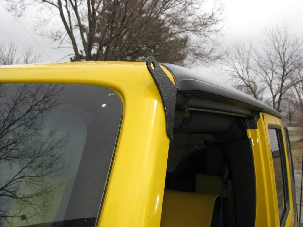

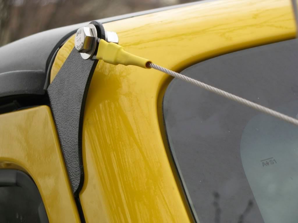

Then place the finished end in the upper bracket and do the same thing to the other end of the cable. However, before fastening the other end you should place the bolt in the lower bracket. Pull the cable taught. Bend it around the bolt and thread it back through the clamp. Take the assembly off the Jeep and crimp the clamp. Heat the shrink-tube and you have a completed cable. Now attach it back to the two brackets and screw it down:

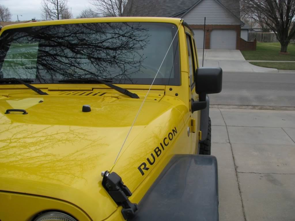

Repeat the process on the other side and you will now have a great set of Limb Risers on your Jeep. They be easily removed by simply unbolting the cables when you're not on the trail:
Enjoy your pretty paint job while your Limb Risers do what they do best - keep those limbs off your Jeep.
