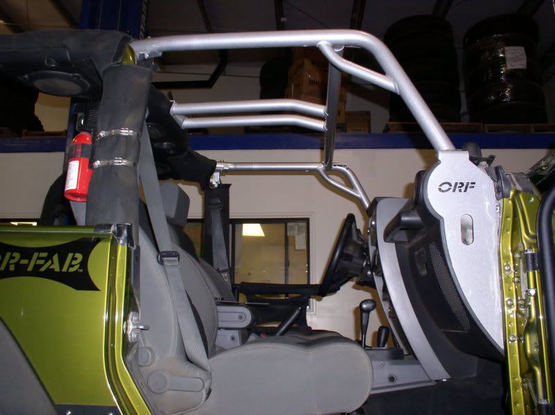

Factory pictures:
Floor mount:

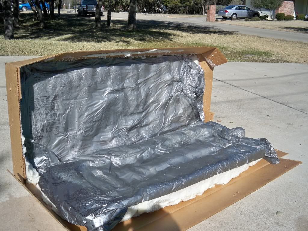

Work in progress. I am downloading some pics as I go!
Inspection of the parts complete: Unlimited Front Cage/ - Optional - Floor Mount/Rear Streamer
- They packed it like they were saving a kidney for a transplant. No scratches on heavy steel.
- The parts are welded very well in every area of both flat and tube.
- The material is heavy duty! Much thicker steel than it appears in pictures.

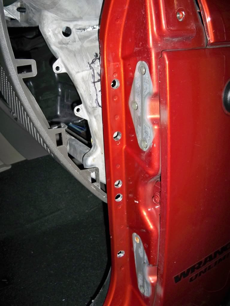

NOTE: The template for drilling is metal. I found it in the box after reading the instructions thinking this was a paper template!!!
The hole on the left in this picture is the bottom hole. The template can be put on upside down.

A lot of the pictures show the passenger side but the process is very similar on both sides.

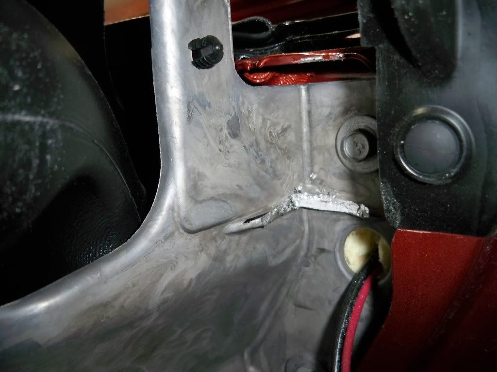

I took the glove box and speaker out on the passenger side. Several folks warned me that in the cutting process on the passenger side they cut some of the wires and that taking out the speaker was much faster. There are only 3 screws holding it in. Two from the side and one on the bottom. There is a little panel under the glove box that just pops off so you can see that one. I don't remember the directions saying anything about removing the hinges but they are in the way for drilling the pinch seams.
This edge is trimmed but is not visible when the plate is on.
I put one side in then the other and put the bars going across in afterward. There is enough flex while it is still unbolted to the pinch seam to get everything to come together.
Test fit.

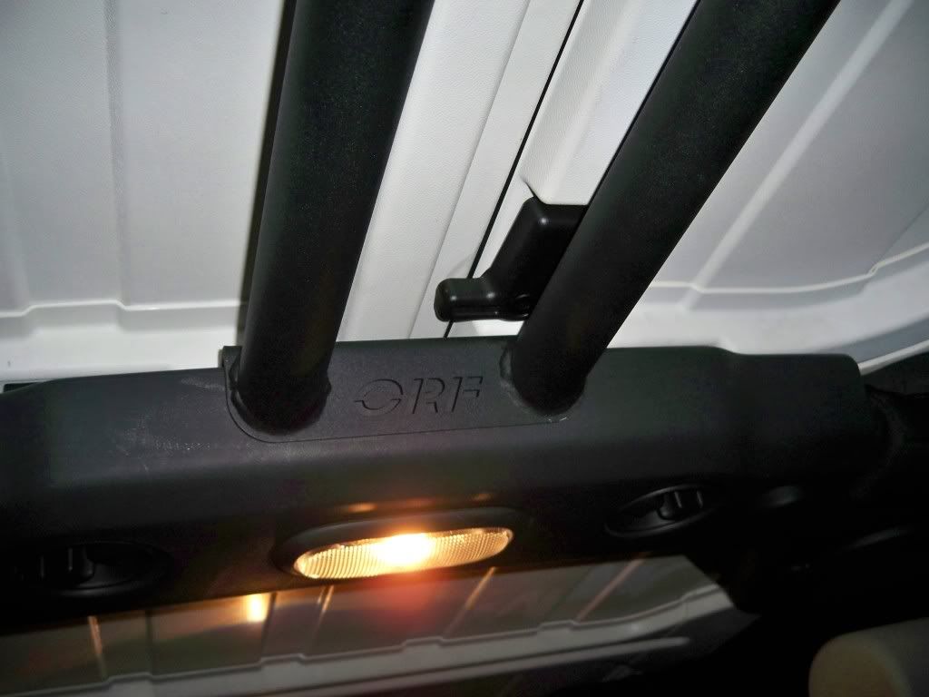

Update: Done now!!I don't have the rear done or the pieces of plastic trimmed on the A pillar/windshield /door sill.
I chose to put the padding back on the bar. The view with the bars in does not restrict the view of the driver at all. I am very pleased with the product and the design. I recommend this cage but hope I never have to test it. I have rolled a Jeep once and that is enough.

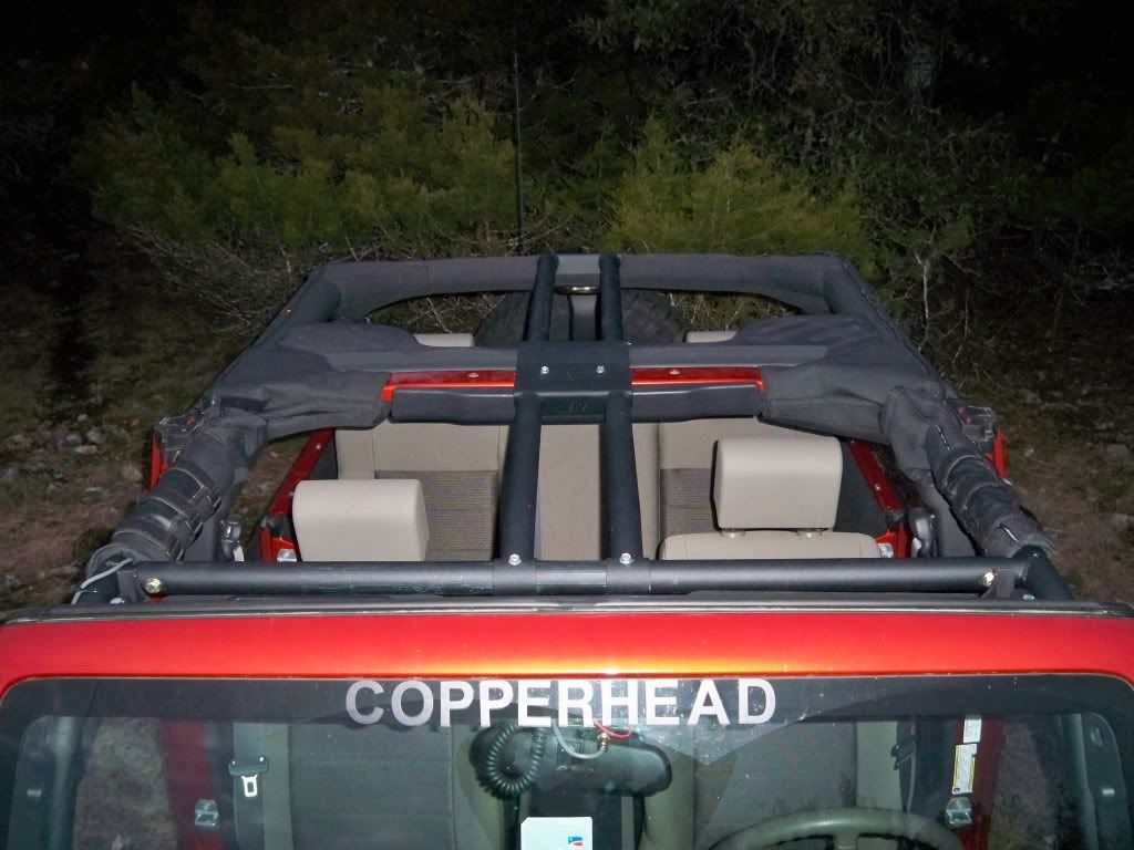

All finished now and I love the new protection, but hope I never need it!! I think it looks great but most people will not notice something added. I think they will believe the Jeep just came this way. That is a good statement about it's design!
