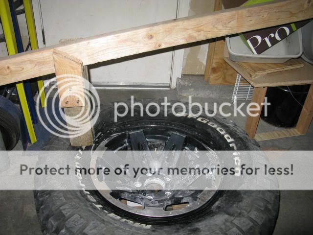

I mounted 35" BFG KM2s on Rugged Ridge wheels with Staun internal beadlocks and will post a write up someday. It was difficult getting the stiff new tires on - definitely no fun.
I have tire irons from Harbor Freight but aluminum wheels scratch/dent real easy. Rugged Ridge ships the rims with a plastic edge protector - but it required too much force with the irons and it would slip off. I also had the potential problem of the internal beadlock tubes getting holes from the tire irons.
Frustrated, I came up with this idea - works great - a ten foot 2X4 as a lever placed on a short 4X4 (with a couple short 2X4 side pieces to keep it centered). I put the end of the 2X4 under my heavy bolted down workbench (otherwise would lift up)- also tried it under the Jeep.
Nice Trick, it will make a great bead breaker too.
