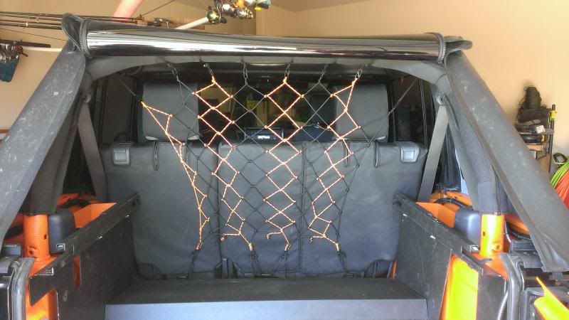

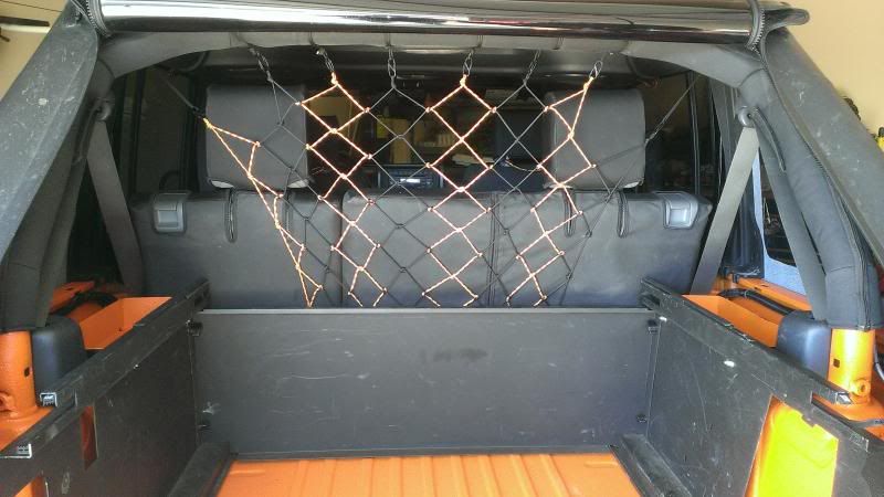

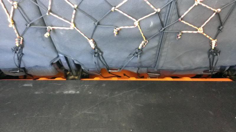

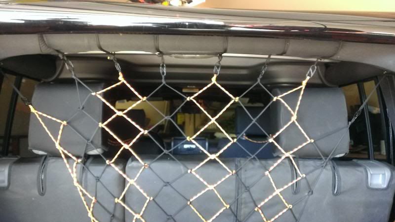

It works great to keep the dog/cargo in the back. I pack the back pretty full against this thing and it doesn't budge! I used the S-biners and rope tighteners so I could remove it anytime I wanted. You can just tie it on the rollbar or whatever you want if you aren't going to remove it. The first one I tied one was not removable, it stayed on the Jeep for over a year with no problems. Just looped some 550 cord around the rollbar and hooked a Nite Ize metal s-biner on then hooked the other end of the S-biner on a loop in the middle of another string of 550 cord about 10' long. It took 8 loops around the rollbar and 8 hooks and 8 ten foot pieces of 550 cord. Then just start tying square knots every couple inches with the cords that are beside each other. Doesn't take much to figure it out. Connected the bottom to the car seat restraint loops with 4 Nite Ize rope tightener.

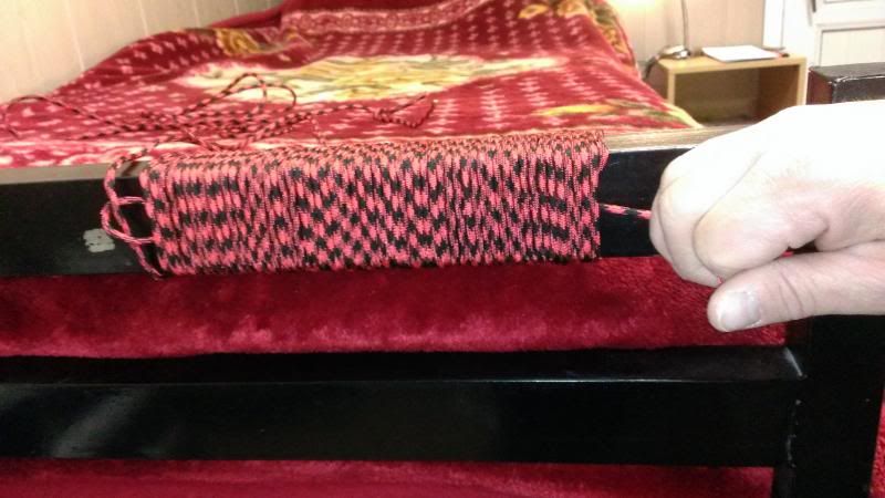

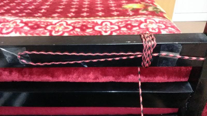

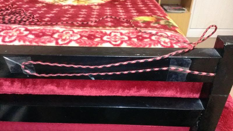

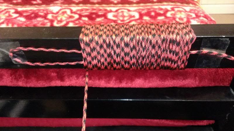

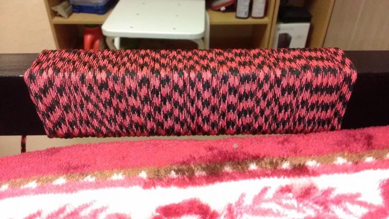

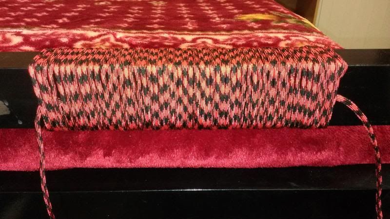

I'm not around my Jeep right now so I'll try to show you on my bed frame. From the back side of your handle put the tail on one side and make a loop on the other side. Tape helps here. Back at the tail side and start wrapping the cord around back towards the loop. When you reach the loop and have all the wraps you want, put the end through the loop. Keep the wraps tight and even. All you have to do now is pull the original tail and make sure the end going through the loop goes under a couple wraps. Some of the handles aren't flat on the back side but you can find a spot that will keep it tight. Last, just cut and burn the ends. Just be careful with the flame. I use a little butane jet lighter. It is pretty precise. Here are some pics of the sequence. Hope this helps!
Here is the front side
