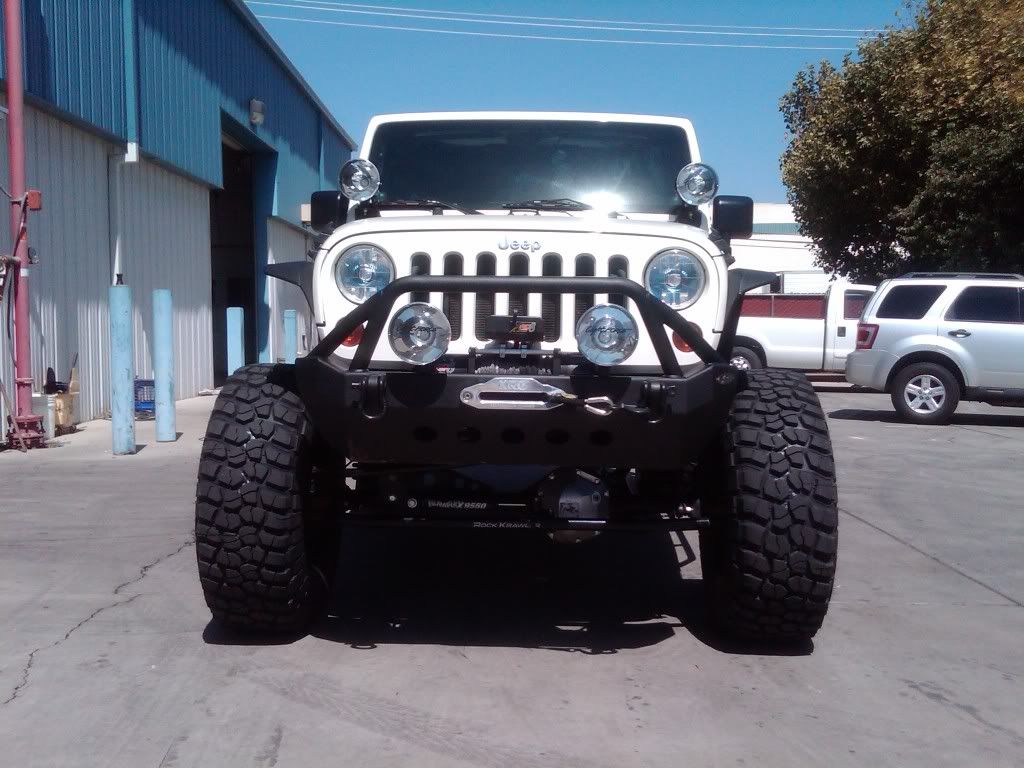

I run the 345's. New they measured 36.5ish their on a 16x8 wheel. Your other options are 38 inch toyos, 37 inch iroks, or 38 inch nitto mud grapplers. My next tire will be the nitto's since i want a little more height.
The day I mounted them up

I was wondering how well the 345/75R16 would fit on 8" rims ... So looks like the fit fine ????
Yes sir. No issues. 8's on 13.50's = poor mans beadlocks
