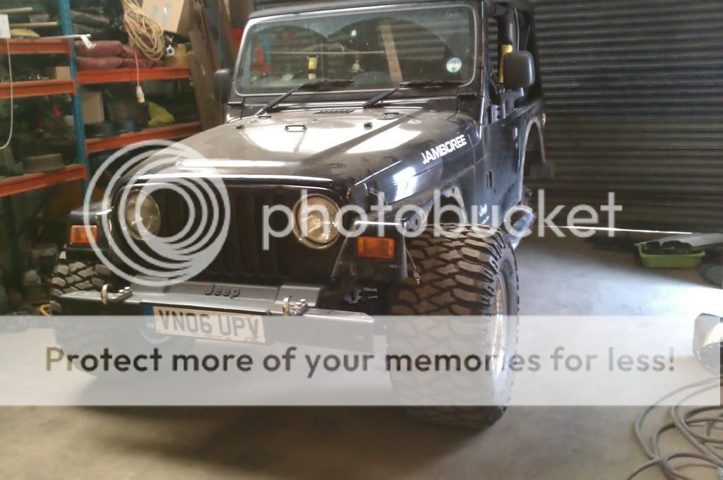

< here is that same size in a Mickey Thompson...geezus! Just a bit too wide for daily driving!
