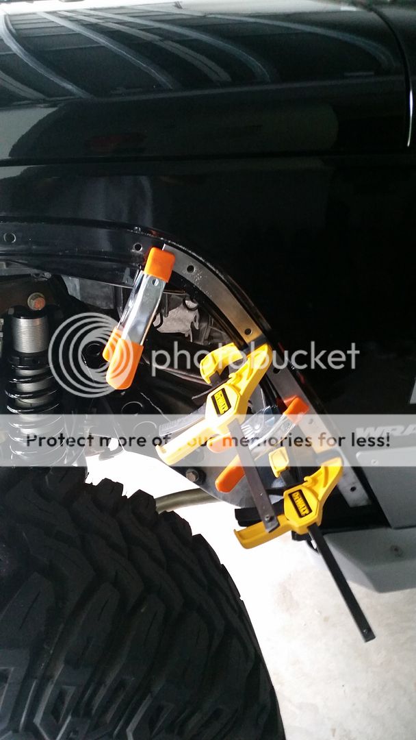

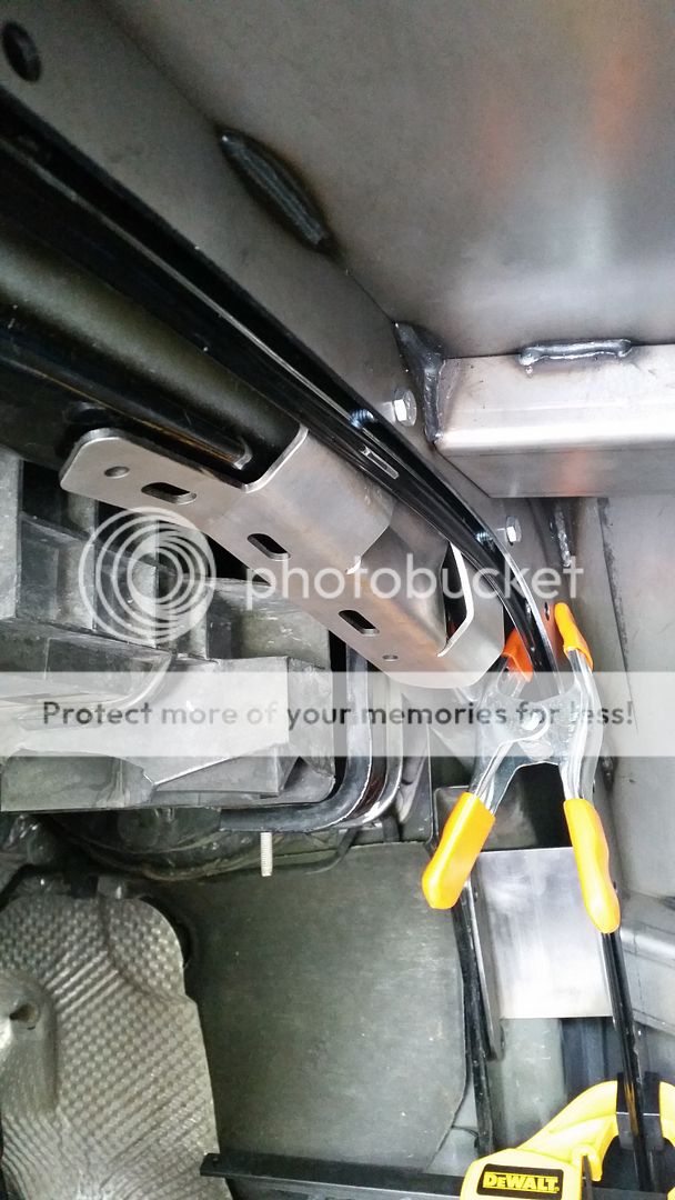

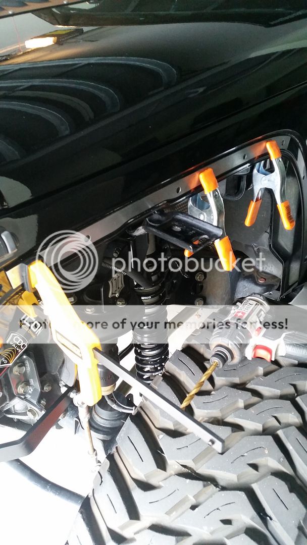

The install went pretty smoothly, considering no directions were included but this isn't rocket science and there is really only one way these get installed.
They sent a template for the extra 3 or 4 holes that needed to be drilled. I just lined it up with the existing holes, clamped it down and drilled.
Then lined up the inner supporting braces to make sure everything lined up and drilled where needed.
These fenders do not install with nutserts but with nuts and bolts. Which should help keep the strength in the long run. Also everything lined up perfectly to existing holes. Artec seems to have excellent quality control at this point.

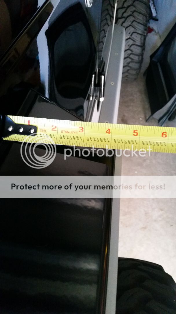

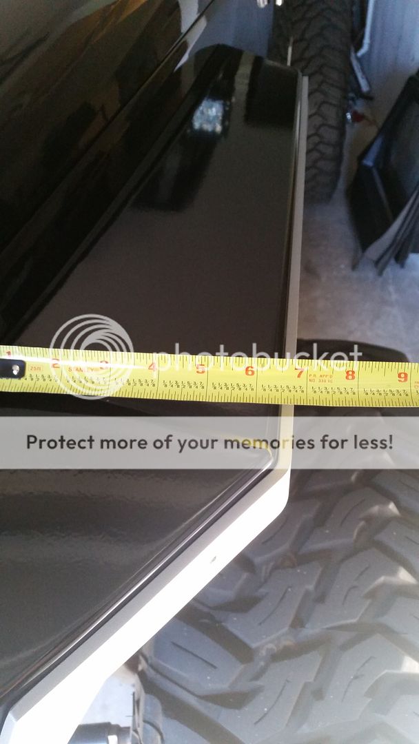

Those things are mad! Would look awesome with my VKS sliders. Hard angles.
I can't tell from the pics, and you're wheels, or axles,mseem very wide.
What is the width on those things?
How do they compare to stock width?
They appear narrow, but I can't tell.

My front axle is a prorock 44, stock width but the wheels are ATX slabs with 3.5" backspace and the Cooper tires are 13.5" wide so it has a slight bigger width than factory.
Originally Posted by RedRubiconLJ View Post
Do they keep the inner fender liners? How wide are they, Front and rear.....
Not sure on the inner fender liners as those were thrown out long ago but I don't see a problem keeping the stock ones, if trimmed, and or aftermarket ones.
The rear I don't have as those haven't been released for the 2 door.
The front fenders are almost 7" at their widest point near the front area, and 4-1/2" at their shortest point all the way back to the slider.
