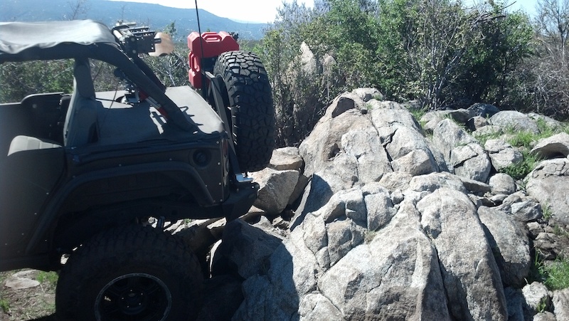

Got it figured out Love it, such a clean install and hardly notice it's there. Super convenient and very happy!
zachsch is offline
post #25 of 31 Old 07-13-2015, 10:47 AM
Join Date: Feb 2015
Age: 27
Posts: 4
Sorry for the massive pictures...that's what I downloaded from google photos :/
