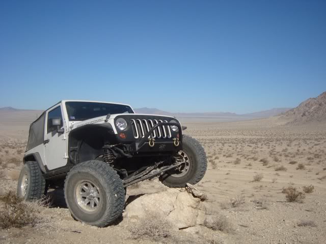

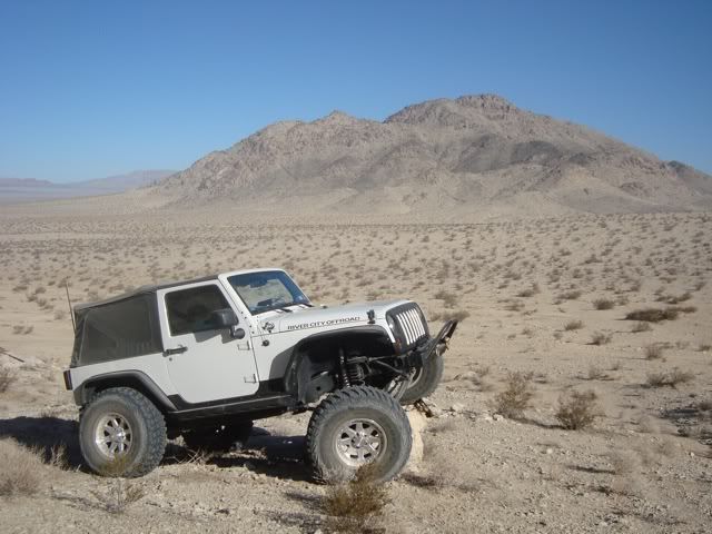

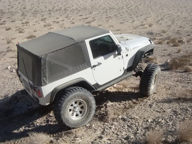

For comparison's sake here's an RK 2.5 Max Travel on 37s. The shocks are 4-6" Fox 2.0s and I was running RK lowers and stock uppers in this picture.
No, I don't have CTI numbers on mine, but if we are posting in the field photos I think this is a decent comparison. I want to know as much as the rest of these guys what makes your arms ride, flex, and operate so much better than what we are running.
Thats what Im trying to find out. They make some bold statements about their products that I hope I will agree with after all is said and done. But I guess you cant go wrong with a money back guarantee
