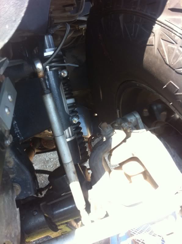

It just can't be good for them. I've over compressed mine dozens of times. But after 2.5 years my RadFlow coilover shocks haven't lost any psi. And my fox shocks on the rear are still fine also. So I used to worry about that a lot but shit, after all the wheeling I've done with no issues I don't worry anymore. Pic is an example of what has to be over compress, tire is stuffed into the driver front and pas rear. So bottom line, I don't advicate not running bumpstops - just saying it hasn't been a prob for me!
