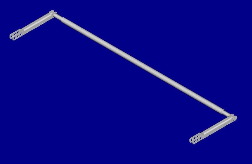

We are working on this for the rear as a direct replacement for the OEM...

Posts: 4,715
We will be testing it from the spring through the fall. Fatigue and cycles are most important with a rear sway bar.
