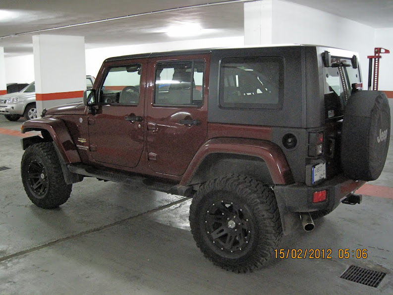

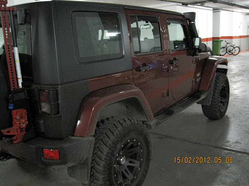

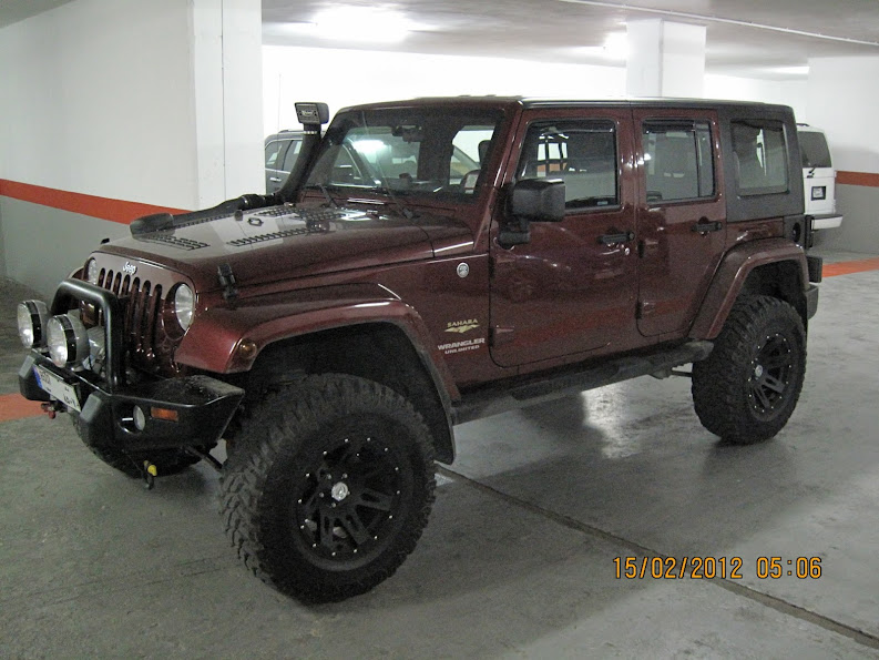

The HEMI jk is home!

Sexy Jeep. Not many jacking poiints on it to use that HiLift jack. That Hemi is just plain sexy!
And dang, you got some great toys
post #4 of 11 Old 02-14-2012, 09:26 PM Thread Starter
Rafic's Avatar
Location: Beirut, Lebanon
Posts: 153
Send a message via MSN to Rafic
I have 2 jacking points in the ARB front bumper, you cant really see them in the pics. As for the rear, I use a couple of heavy duty hooks attached to a chain. I hook them up to the two holes in the hitch receiver. Works great only if the rear spare tire is removed! And thx for the comments! Right now, the Hemi is my favorite! That V8 sounds INSANE!!!

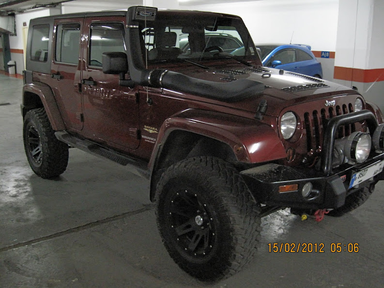

quick question on your setup... i see a snorkel on the outside of the hood, yet you have a CAI underneath... did you have to get rid of the snorkel for the HEMI swap? just curious

Paramaniac, I installed the snorkel prior to deciding on the Hemi swap. I never got around to have it fully functional even with the 3.8 V6. And now it just sits there with no functionality as it wont work with the Hemi setup. I am looking into fabricating an aluminum box/enclosure for the CAI and connect it somehow to the snorkel. Still a work in progress. Unless Volant steps up and releases a Hemi version for their underhood enclosure! Come on Volant, I like your snorkel the best!
