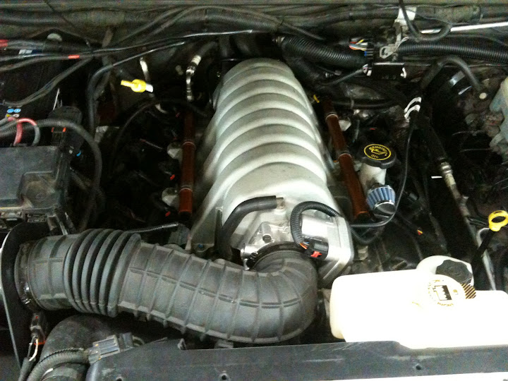

Then came the HEMI!!! 6.1l pullout from a 2008 Grand Cherokee SRT8. Bought the engine 3 years ago from a local scrap yard. Engine had only 18k km on it. The scrap yard guy had it lying around his shop and told me he has no customers for it and he would only sell it to me as is with its A580 tranny attached to it along with every conceivable part on it. The engine came with all its options (AC compressor, power steering, starter, alternator, even the OEM wiring harness was intact). He let the whole thing go for $4K. He was asking for a stand alone 5.7 Hemi with nothing on it for 3500$. I ended up with a spare A580 tranny lying around. The 5-45RFE tranny was also sourced from a local scrap yard 3 months ago. And that too was in great condition. It was on 2007 Ram or Durango. Switched the A580 for that at no extra cost

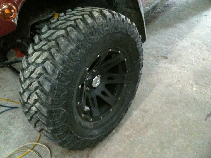

The kit I used is the AEV premium kit. Very well designed kit. Everything was easy breezy and bolted on great. Along with the Hemi kit I got 17" Rugged Ridge matt black wheels, 35" Cooper SSTs, Synergy hood louvres from Poly Performance, Alloy USA 4.88 gears, having the front ARB bumper resprayed in wrinkle finish matt black to match the AEV corner guards.

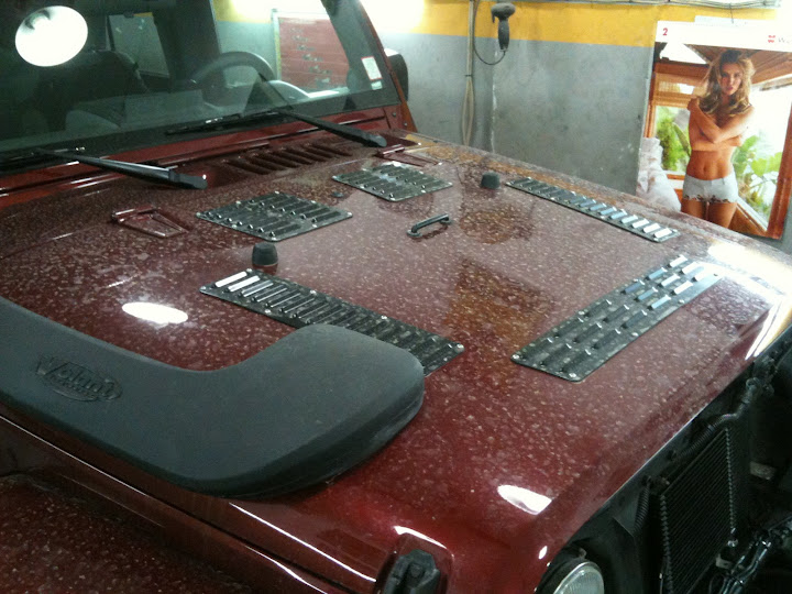

The JK is still under the knife at the moment because the paint supplier guy messed up on the delivery of the paint supplies so got pushed till tomorrow. I managed today to get the hood louvres cutouts done. Only thing left is the front bumper.
Dunno if I forgot some things to mention! I will post detailed pics of the Hemi build later on when all is done. It has been a hectic month doing the build. I enlisted the help of a local premium body shop and a friend mechanic to conduct and assist with the difficult parts of the Hemi build. Swapping an engine is no easy task! I am no mechanic but I know how to twist a screwdriver! I helped in every way possible in the swap process to the best of my abilities. And when it seamed I would mess things up, the guys at the bodyshop and the mechanic pushed me aside to correctly install/setup things

Nice hood work
Thx!! Measure twice, cut once! The way we did it, we measured and aligned the louvres. We drew their outline/diagram with painters tape. The hood looked like an architect's drawing! Then we kept them in their correct place with some painters tape. Then we drilled out their mounting holes and installed the screws. Later came the cutting of the openings under them after we marked out the cutting outline/area using the perturbing screws as a guide. This way me made sure of where to cut and how much to cut using the screws' outline underneath! Removed louvres, drilled consecutive small holes with a small drill bit along the outline of the soon to be cutout. Then smoothed out the edges into a straight line. This way we removed the risk of bending/deforming the sheet metal under the pressure of cutting disc.
