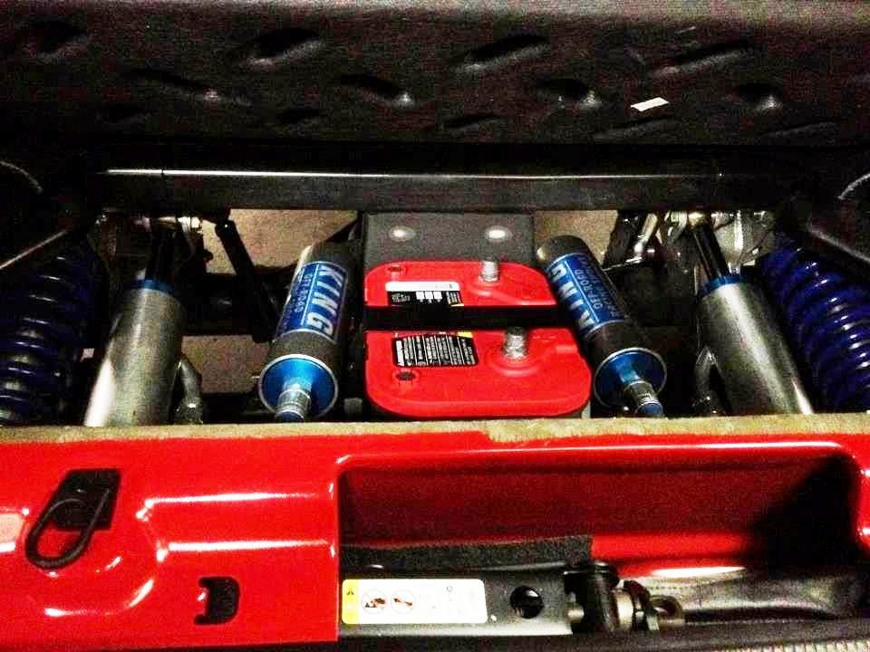

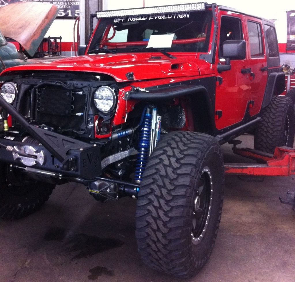

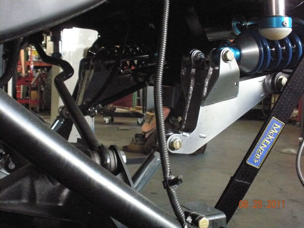

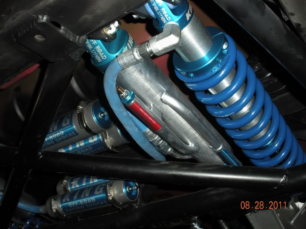

If you are concerned with damaging the shocks, you could look at EVO's system....Double Throwdown front and back. The rear coilovers are horizontal and the system works on a cantilever system. No part of the shock protrudes below the axle. Here is my setup.
This is the rear.

Yes the EVO system is a little pricey, but it performs very well. Over half the vehicles that ran the JK Experience this year had this system on.

You forgot one thing tho it's not quiet it is probably one of the noisiest lifts out there

Hey TopGun, meet me at Hangar 24 and I'll tell ya all about cycling suspension to get every quarter inch of travel out of your shocks. I ran kings on my last race truck, and once I dumped the piss out of em that king calls oil, they worked amazingly well. Easy to work on too.
A lot of noise comes from the bypasses. It sounds like I was banging my wedding ring against the cage x 10 the whole time I was driving it. But in all honesty, I liked it.
Canti setups are complicated and sweet looking, and can work well if the shocks are dialed in.

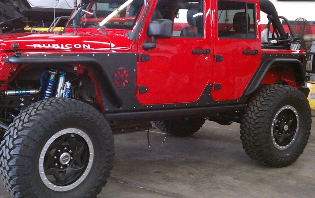

I forsee tires hitting on those when flexed, here is my setup with frenched frame. For the front tribe4x4 is by far the strongest setup out there

Not too bad, my axle is 69.5" wide. Still, I'm going to redoe it once I get the garage cleaned out and have the space.
