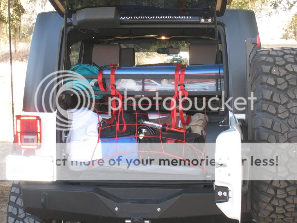

Went to Ocala to test new mods.
Here are some pics....

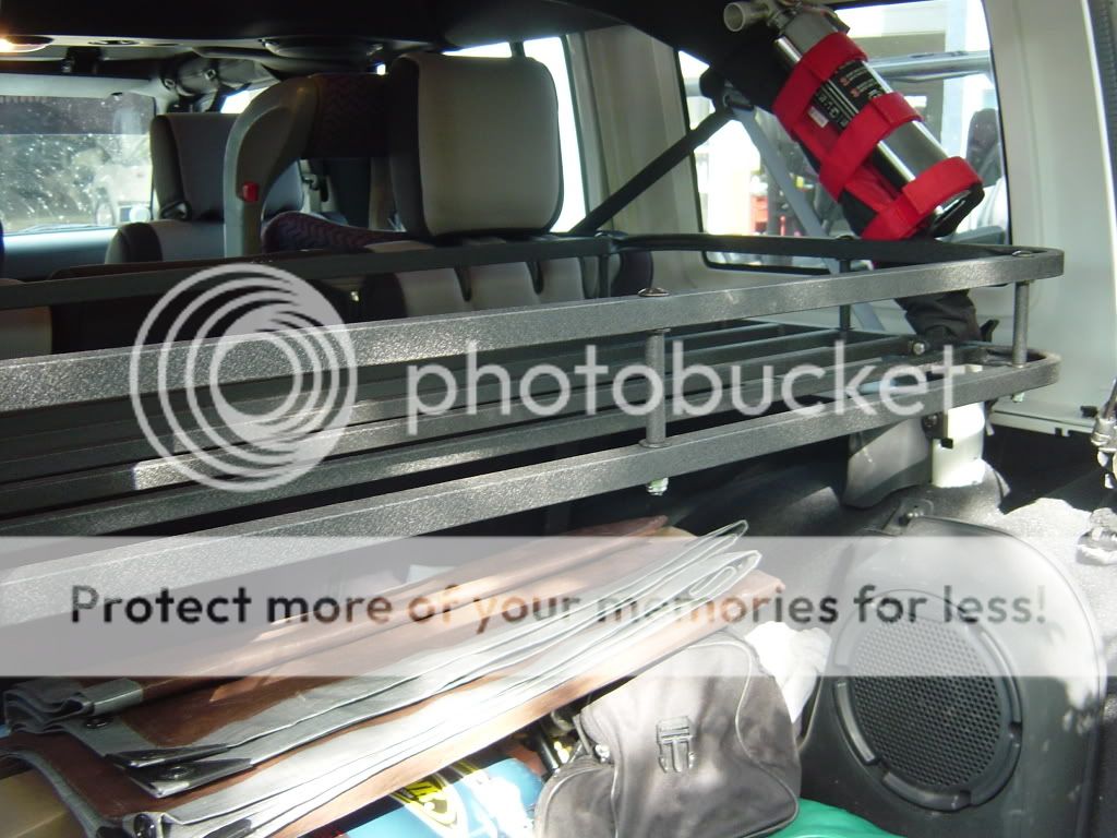

Rack empty..
Rack in use and new bumper...

The way Olympic engineered the rear mounts (closest to the tailgate) was for two bolts to go thru the rack, then thru a spacer and then a C-clamp on the outside of the rollbar. When weight was put on the rack it did not support very well. I used their spacer and mounted it vertical and then drilled two holes thru the rollbar. Rack is very, very sturdy now. Here is a pic...

Very easy to take out, would not swing up. You can see in my picture above that each side has two knobs and then there are two right behind the seat (left and right). Would take 10 minutes top to remove/no tools needed.

Mine came with all of the hardware but I did have to cut one bolt that was freakishly too long (like 5 extra inches too long?). Now that I have it done I might grind doen the extra threads protruding down out of the rack.
