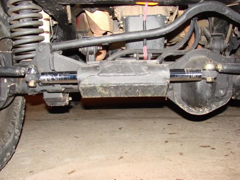

You will need to replace the factory unit no matter what.... unless you switch to full hydro steering which is technically illegal on the road.
Hydro assist, is just that, an assist to the factory power steering.
Phil (there may be others, I just know this one for sure) has a hydro assist which will help drive those 4ds. But I'd wonder how up to snuff the factory D44 is to that size of tire and weight.
I run Hydro assist on the Isuzu and it makes a HUGE difference! But it also makes it easy to rip things off too.

Why full hydro isn't legal on the road...
Typically and this is in general speaking terms, a full hydro system isn't
A) relational and variable in input vs output. ie your factory power steering provides a "feel" for the road and applies turning power variably depending on speed.
B) doesn't return to center, meaning if you let go of the wheel the wheel does not "automatically" return to driving straight. This could be catastrophic in the event you can not input to the steering wheel and the vehicle continues on the course of your last input.
C) if your hydro system fails, you have NO WAY to control your vehicle.
Ram Assist or Hydro Assist, does just that, assist the application of power to the input you or the RTC is providing to the steering system.
Now a full hydro with backups and RTC and variable ratio is legal and is in fact on several very large on road commercial vehicles.

That is what I have, a stage II kit. Works great and Matt at West Texas Offroad knows his stuff. The factory pump seems to work just fine with it, but I am going to add a small cooler and if I can find space a filter.
Driving on the freeway is great, it acts as like a real high pressure stabilizer. Haven't done much off-road yet, but will give it a good workout in a couple of weeks.
As is pretty normal with this kind of setup, steering is a little slower than normal and if you want to move the wheels quickly it will take a little more force than usual, but it is not really noticeable.
When off-road I think it is also remembering that just because you can turn the wheels, you may not want to. The ram will often prove to be stronger than your tie rod ends. A good rule of thumb is that if you need more than one hand on the wheel, then it is most probably too much.

The same PSC Jeep JK Cylinder Assist Kit that is available through PSC for $1,700 can be purchased through Poly Performance for about $1,558.
http://www.polyperformance.com/shop/...t-p-16888.html
PSC also has an upgraded steering box for the JK, for those that might not want to go all the way.
http://www.polyperformance.com/shop/...s-p-16889.html

1.5"
What size tires are you running.
37's. I was planning on going to 40's, but I've decided to stick with 37's for now.
Did you do the power steering pump mods that West Texas does to increase hydraulic pressure and volume?
West Texas Offroad did it and got it setup very nicely.
I plan on adding a cooler too.
I added a small cooler, which drops the fluid temp by 15°.
On the street it works great, very happy with it. Off-road it is excellent, being able to turn the wheels and put them exactly where I want them is a big plus. Extremely happy with off-road performance.
For the money, I think the West Texas Offroad offer a great kit.

Do you think it's a good idea to replace the drag link with either the Poly Performance or RK unit?
The stock drag link bends easily, I used to bend my just slightly every wheeling trip. A stronger drag link is a good idea, and any high steer setup is going to reward you on the highway too.

Hey Phil, it's been a while now since you've done your hydro... any issues? Also, could you post some pictures of your mounts.
The lack of steering is getting obnoxious IMO... it's so bad we even stopped in a field for lunch this past weekend, I went to move out of a tight situation of parked Jeeps and couldn't turn the wheel at all, even when getting the rpms up. Let alone on rocks with the front locker locked...

Ok, now that I have seen a couple kits I am clear... thanks. None of the ones I am looking at are full hydro.
I beg to differ. I have full hydraulic steering and you can still steer it when the motor is off even though it's tough.
It doesn't return to center just like stock steering but it DOESN'T stay where you let go of the wheel at, it does come back on it's own some what but just not all the way.
This just sound like a excuse for the non experienced. Drive a 08 jk with full hydraulic steering and you will see that there's not a big difference in FEEL.
