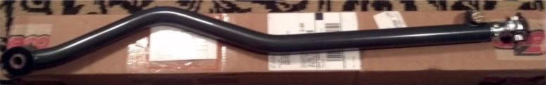

As usual.... super fast shipping from Poly. Ordered it on Friday and it was here the following Tuesday.

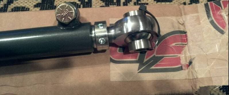

It was off by a little over .5" to the passengers side so I shortened it to what I thought was about .25 and put it in. Buttoned everything back up and took it for a spin figuring that I would measure it after a run around the block and then dial it in... seeing how it is adjustable and all. First thing I noticed was that the steering wheel was off to the drivers side about a quarter turn... no big deal - I can dial the steering in. It seemed "flighty" at speed (~40mph) and wanted to pull to the passengers side. I didn't take it any faster and went back home to do some measurements. It is still off by a little under .5" so I need to shorten it some more. What sucks is that the adjuster sleeve is hard to get to inside the Poly track bar bracket.... you can only turn it a fraction of a turn at a time and even with the pinch bolt completely loose it is a bitch to turn - am I missing something or is this typical?
I am running the Poly Track Bar bracket with cam bolt:
Here is the adjustable rod end (structs say to use a 1/4" punch for adjustment):
Worse case I will just pull the end back off and make the adjustment by spinning it back in but figured I would ask first before fawking with those bolts again.
