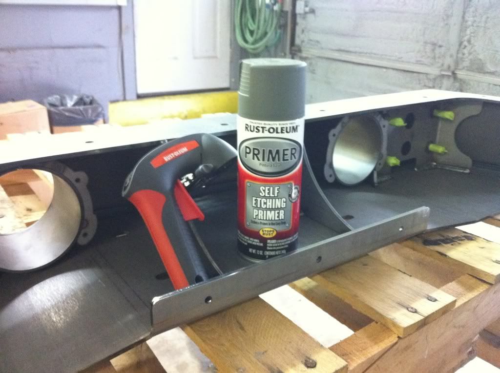

wanted to try a new approach and run without a bar this time around and fill it full of lights (sort of ATX JK styling)

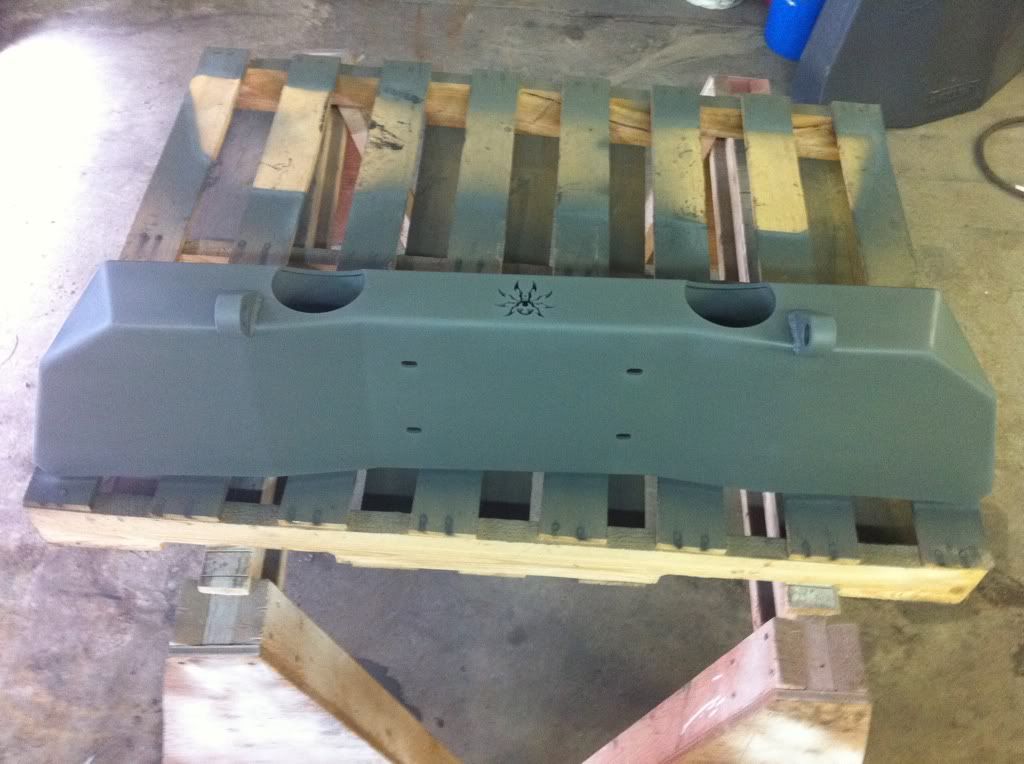

5/20/2011 Friday
Let it begin...
weather was crappy that day and primer went on thick... (old man left for a vacation to the Florida Keys for a week) so this is currently sitting in the shop for a week getting a good cure.
After priming the bumper I head over to the shop to pick up the Jeep and my old tires with a friend of the family. Load his truck up with my old tires and hop in the Jeep and head on home. About 5 miles from home going about 50mph I hear a loud BANG and see something shoot out in front of me. WTF? So I pull over quickly thinking maybe I just broke a wheel lug.
Walk the road about 200 feet and find a clip on wheel weight. I had told the shop SPECIFICALLY not to use these on my wheels (either outside or inside) as I would rip them off on trail. I only wanted stick on weights or beads. Closer inspection reveals that the stick on weights were used and these clip on styles too (ON ALL 4 WHEELS) and to top it off... my wheels are all gouged!!!!! .
So I drive home carefully not knowing how out of balance the tires may be and get it home. Get a ride back to town from my friend and pick up the cherokee and head over to the shop. Walk in and hand him that weight, his face got white as I said "remember when we had the conversation about these?" he acknowledged me and then went on to say he told the other shop not to use them. Proceeded to bring me into his office while he called the other shop to inform them of how pissed I was. Still... this is an extension of HIS SHOP! I informed them both I would not be paying for the tire service. I call the other shop once I left and he said he would do right by me and that my shop never told him to not put those on and that his machine wouldn't be able to gouge them like I explained, said he had noticed the gouges while installing which took an hour per tire. I learn a few other things too... which I'm currently working on and will update.

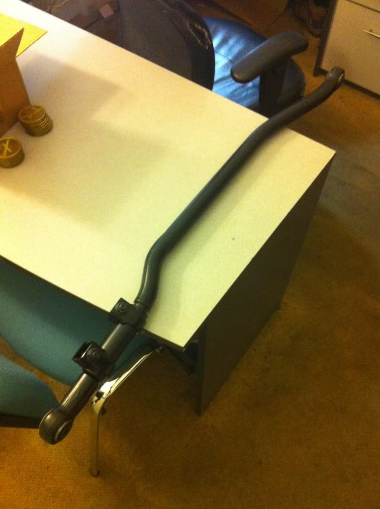

Posts: 5,420
delivery just now 5/26/2011 (you'll appreciate this Nick)
This ladies and gentleman is a Teraflex Forged Rear Track Bar (DAMN THIS IS STOUT!)
The original LCG track bar stripped out at the johnny joint last summer during the Northeast Maine JKO Invasion run, and paramaniac came to the trail fix rescue with a plan to get me off trail, and then I had welded it for a permanent fix after. Well I wasn't in much of a hurry since the beast was getting put away for the winter but now I need the axle straight as I didn't get the positioning correct before welding and it's off... So I discussed it with Joe at Teraflex and finally pulled upgrade

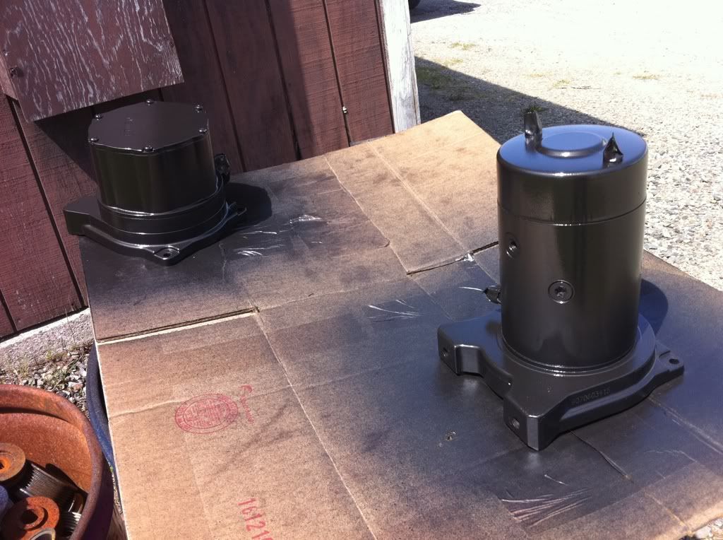

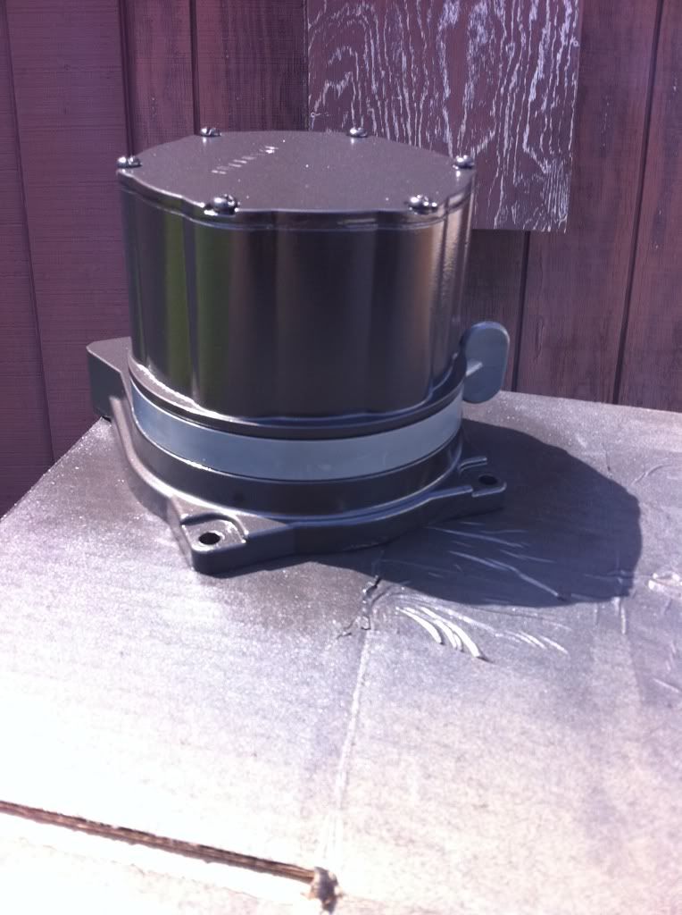

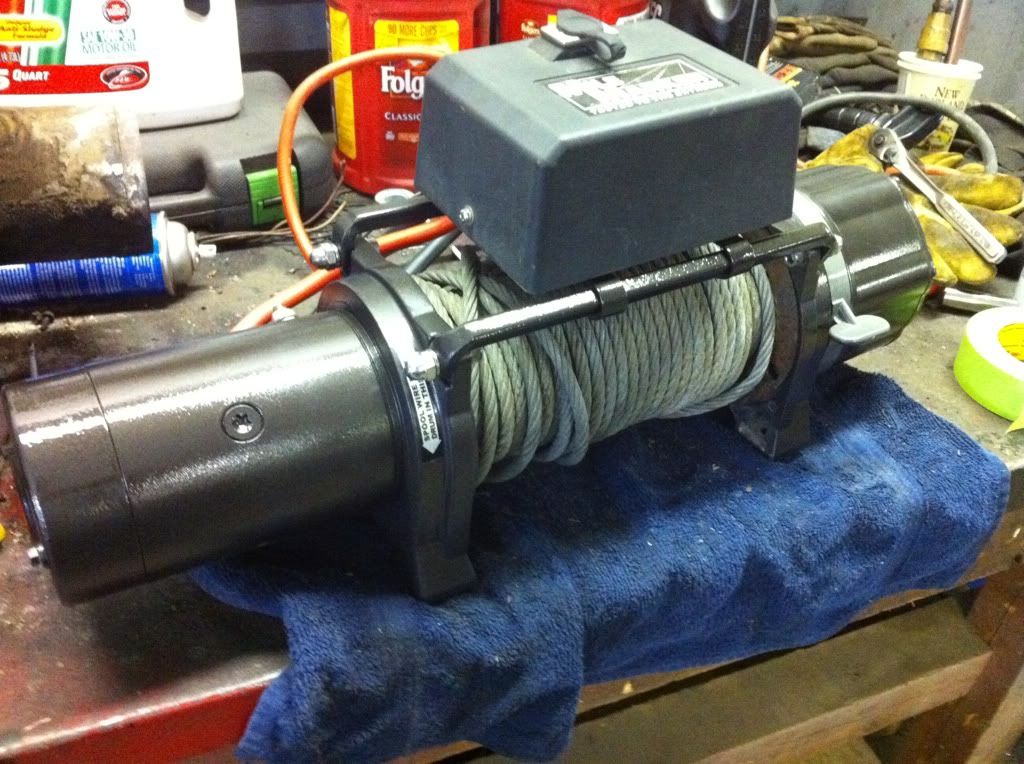

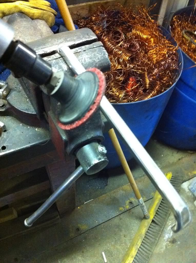

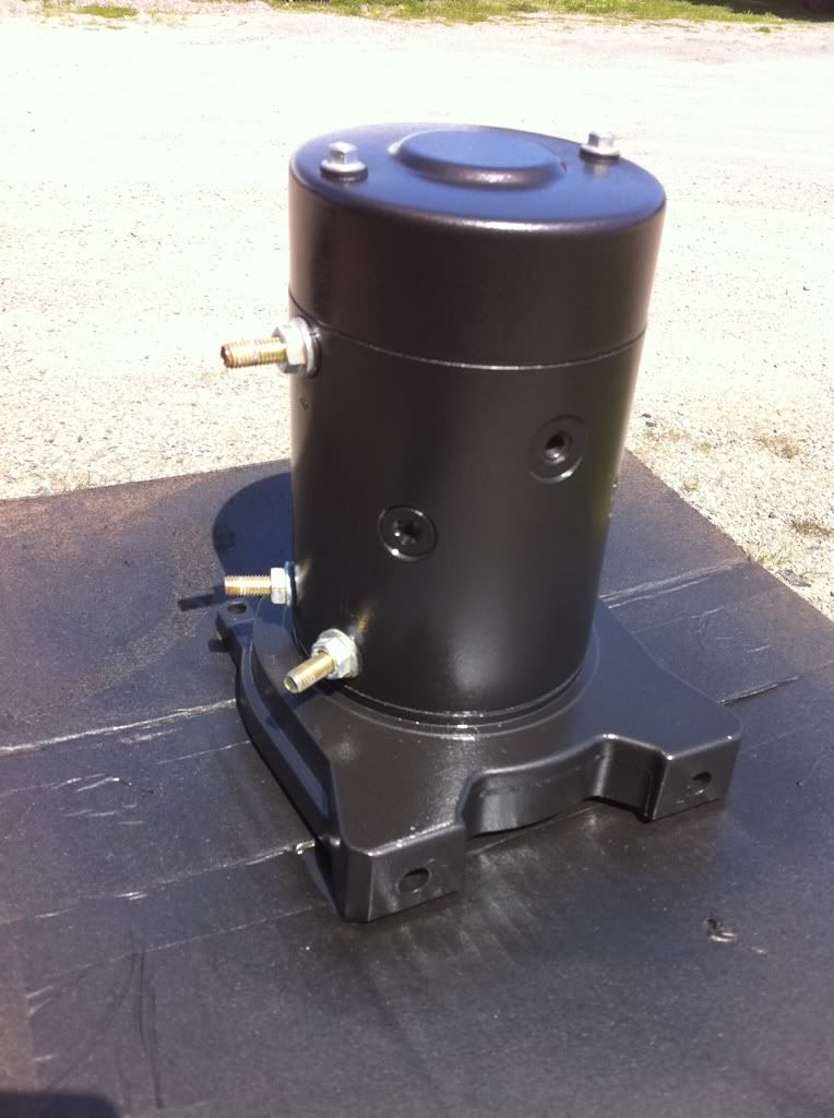

The winch was lookin a little rough after this past year's use so I decided to clean it up a bit...
This is really a very easy task for anyone contemplating this. I took a picture of the wiring just to have, but you can see the rust on the solenoid cross braces and bolts. A few rough spots on the winch itself too which is the overall reasoning for my touch up.
disassemble...
hit the cross braces up with a grinder...
pick your poison... I went with hammered paint by Rustoleum. Rustoleum also has these new designed spray triggers that I highly recommend getting if you don't already have one like this (wicked comfortable!).
-taped up the winch sections
-sanded them with a scotch brite pad to take the shine off the old paint (take your time with this as you only want to have to do this once... this is the bitch work part IMO)
-then cleaned it up with some lacquer thinner (outside for ventilation, this shit makes a mean migraine)
-and set up a nice spot outside...
hit em with about 6 light coats to build up a lighter hammer look (plus this paint is known to run fast if hurried and sprayed heavy)
then pull the tape...
reassemble...
Prior to slapping it back together I checked the grease situation and just made sure to spread it around the gear teeth a bit more. While I was at it I went to the hardware store and got new STAINLESS hardware.
Hooked it up and tested it and the drum and gears fell into place and spin clean.
(overall project time approx 4-5 hours allowing paint to dry)
Still not sure if I like the cross braces painted, will probably pull them and clean them up and shoot em with clear. Also looking at next painting the solenoid cover... I have a few cans of OEM rescue green that may be sacrificed. Going to have a local sign shop make new Mile Marker decals for me as the old ones are faded and torn.
