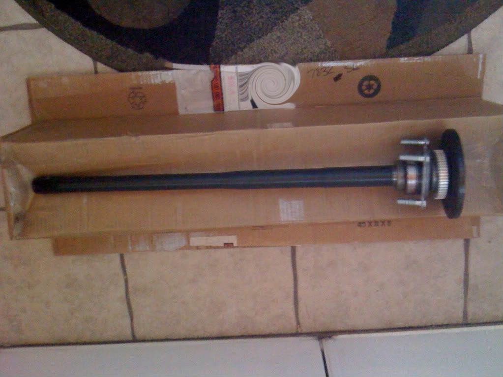

Last week I started getting a squeal from my rear passenger brake. With Jeep Beach this week I decided to do a once over and make sure everything was good to go... I figured my rear pads were starting to go.
I pull of the tire and to my surprise I've got a decent amount of seepage around the axle seal. I clean it up, put the tire back on and give it a shake. Its got a slight movement, but nothing tremendous.
Shafts are Superior Chromo Rubi 44's
Here's my questions:
1. Can I get replacement bearing, seal and collar at a local autoparts store?
2. Is it a good idea to drive the 1000 mi round trip to Jeep Beach on it? (pretty sure I know the answer to this one)
I've got a spare shaft I can throw in, just tight on time. If I can get the parts, I can drop it off down the road, have them press it all together, throw it in, and I'm good to go.
My other thought was to bring it with me hoping one of the vendors or shops down near Daytona would have a bearing/ collar/ seal I could buy.
Joe -

So I think I found the problem... dont know why I didnt notice this when I installed the shafts.
I pulled the shaft tonight to find the bearing installed backwards (compared to stock). the whole base of the bearing is very loose. Could this have caused it to deteriorate so quickly?
I picked up a replacement seal and bearing from AAP. Bearing is a slightly different style then the original... its all one piece rather then a separate race. Would this have any impact? Its the same dimensions/size as the OEM.
Taking to the shop down the street to get it all pressed together tomorrow.

So got the shaft pressed together, put everything back together. Pull out for the test drive and I've got ESP going off and some popping coming from the rear.
Working on pulling the shaft back out.. see whats going on.
Anybody got any ideas?

well it all came out today... the race went in backward and slightly cockeyed... thats why it took so much effort. Grooved the tube prety good too. It ended up requiring an oxyacetalyn torch heating the tube and the slide hammer to get it out. I've still got to put it back together tomorrow, but hopefully that will be uneventful.
this teaches me one very valuable lesson: TAKE YOUR TIME
There's only one person to blame for all of this. The race was put on backwards, I knew it as I was putting it in. I decided it ran like that for about a year, it could run like that a little longer... in my haste to get it back together I caused all of this. stepping back and taking a little extra time to either insure the race was seating correctly, or better yet, taking the shaft back would have saved me a lot of pain.
$170 later (Mobile Mechanic, new bearing, new seal, etc), its almost fixed. lesson learned.
