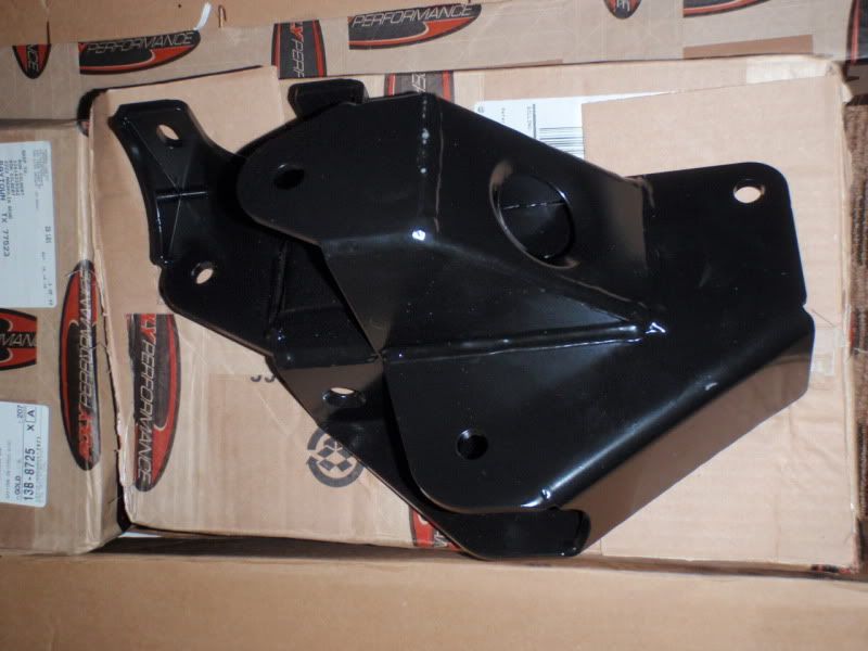

Everything was shipped out the next day and arrived at my door packaged very well.

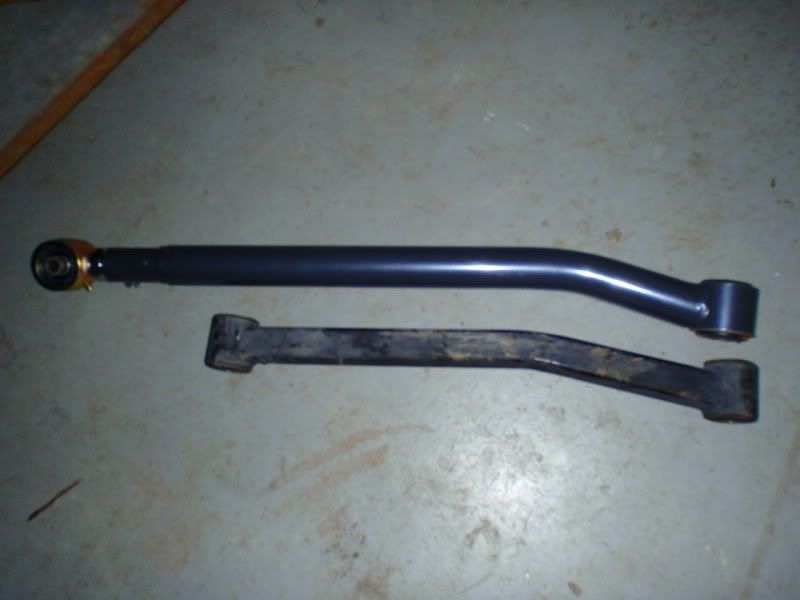

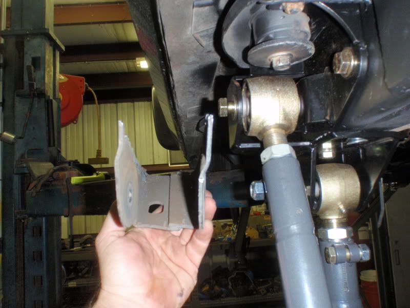

At a glance I was impressed with the construction of the parts, the powder coating was nice and thick and everything was well protected for shipping - and this stuff is heavy.

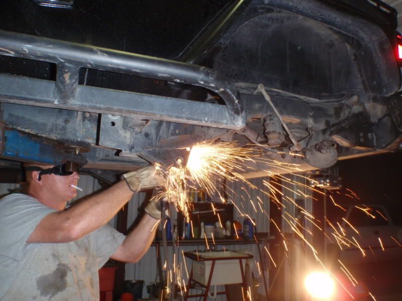

Tear down took a while - this could be done in your driveway but I would not recommend it, its a lot of work with a lift - we used a plasma cutter to start off but there was still quite a bit of grinding to be done.

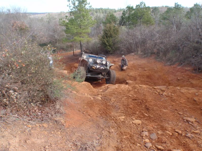

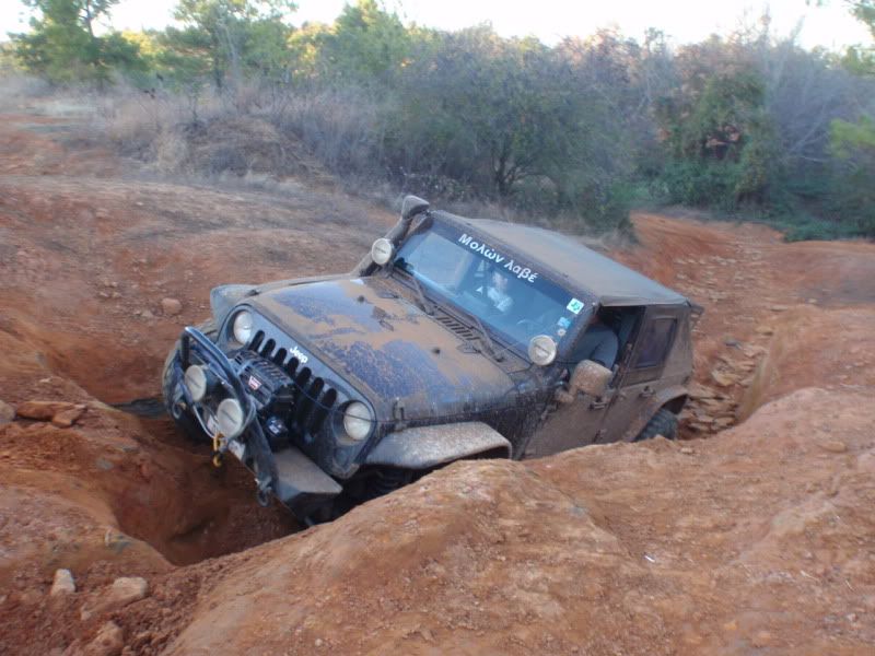

My first chance to wheel it was new years at Barnwell Mountain (BMRA) just outside of Gilmer, Texasd. This was a learning experience to say the least. I had not wheeled in almost two years due to a back injury... during which time I worked on my build list and gathered the components to build my rig just like I wanted it. This was the first test with the Synergy kit as well as the 37s and locked front/rear. I spent the first half day (I got there early) just doing some trail recon to get re-acquainted with the place and to map out the trails that I wanted to hit during the next three days of wheeling. I looked at several trails that were rated 4 and figured "no way" from the looks of them. By the end of the trip I had ran the toughest trails that the park had to offer. We looked at Dewoody from the top and bottom because I really wanted to try it. The trees up top have been chewed up pretty bad from the winch lines and I didn't want to do any more damage to them and really didn't trust any of them.
We ran Houston Creek, Shake Rattle and Roll, Saturday Night Live, Venom Loop, Weenie World and the tough trail on Scorpion Pass. All trails that I said "no way" to when looking at them on day one.
I was completely amazed at how well the rig performed - it crawled everything that I pointed it at.
We got after it for three days and there was very little picture taking.... I had a few snapped on Twister right before dark on the last day.

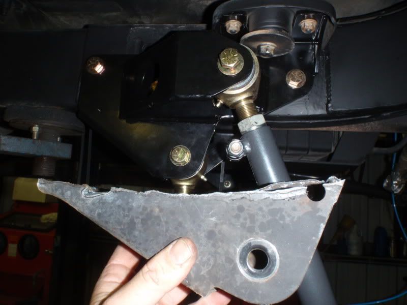

Everything held up perfectly!! I broke in the RROR skids as they had several gashes from the rocks. The Synergy CAs took some direct hits as well and held up just fine. After a weekend of hard wheeling nothing needed replaced, tweaked or tuned.

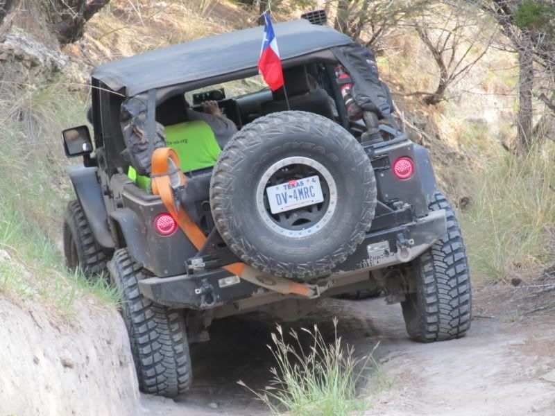

The next trip was to Hidden Falls Adventure Park in Marble Falls, Texas as part of the WFTW run during the weekend of May 7th. I had more confidence in what I could do but am still learning the capabilities of the new setup. I signed up for the "extreme" group and ran the toughest trails that the park had to offer and again - it crawled everything that I pointed it at. There were a few sheer walls that I didn't run after watching some buggies struggle but we tackled every tough one out there including No Name, Wildcat Stairway, Bronco Buster, Penthouse, Carnage Canyon, Wet and Wild and Baby Back to name a few. Zero issues and didn't even unspool the winch or strap.
Edited with a few pics:
