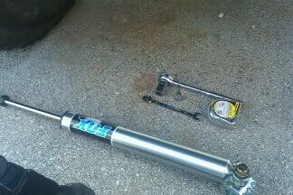

My stock stabilizer was going bad (or so I thought*)... So I ordered a new Fox 2.0 and tie rod clamp.

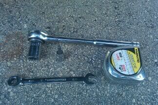

The tools:
Notice that there are 4... Two sockets for the ratchet, a wrench, and a tape measure.
OK, I lied... I needed the new parts also:

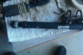

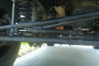

I removed the old one, and since I already had a relocation bracket from my TrailMaster lift, I didn't need a new one.

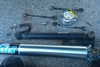

Then I compared them on the ground...

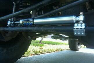

I installed the new one, and this is where I used the tape measure... I had to put the clamp 4.45" shorter than full length.
*This is why I THOUGHT mine was going bad...
I was wrong. It was so dry that it couldn't even shed a tear while leaving the Jeep.

Interesting. How do you figure on the measuring?

Half the full stroke of 8.9".

Is 8.9" the full stroke of the stabilizer? Or, is were you trying to acheive a desired affect?

I got the 8.9" stroke. Mounts very close to the center of the diff when everything is straight...
