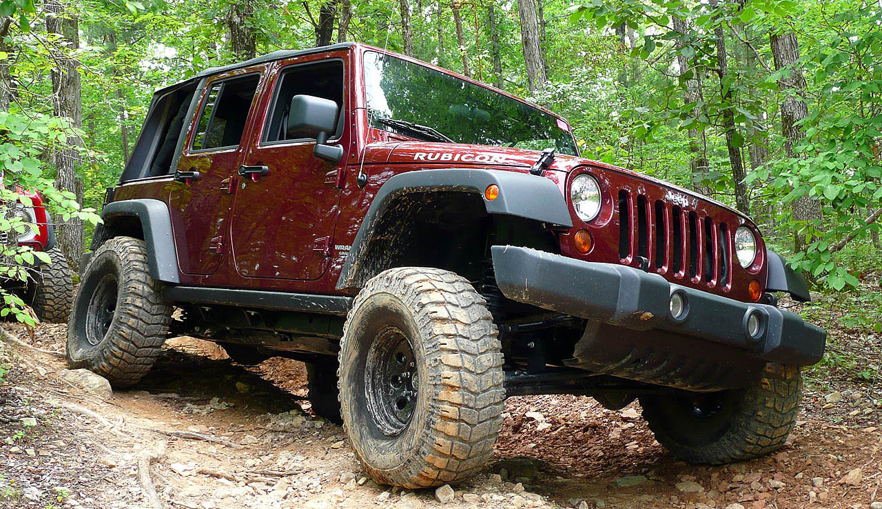

Brand: ProComp
Model:
Extreme 7189
Height/Width:
17 x 9
Backspacing:
4.75
Wheel spacer:
None
Tires:
Irok Radial 36x13.50x17
Related mods:
4" Lift, 1 3/4" front spacer
Fitment comments:
Trimmed seam at front of rear wheel well. Tires rubbed hard in the front wheel wells at full flex, so added additional 3/4" lower bump stop spacer. Tires rubbed hard on front RockRunner control arms at full lock, so adjusted steering stops.
