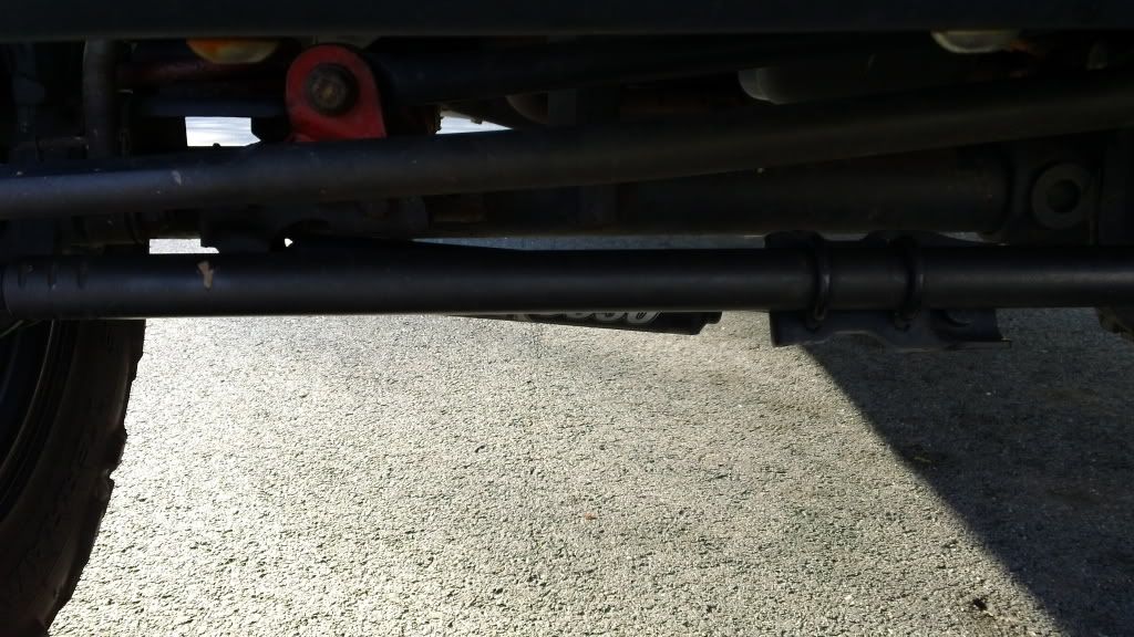

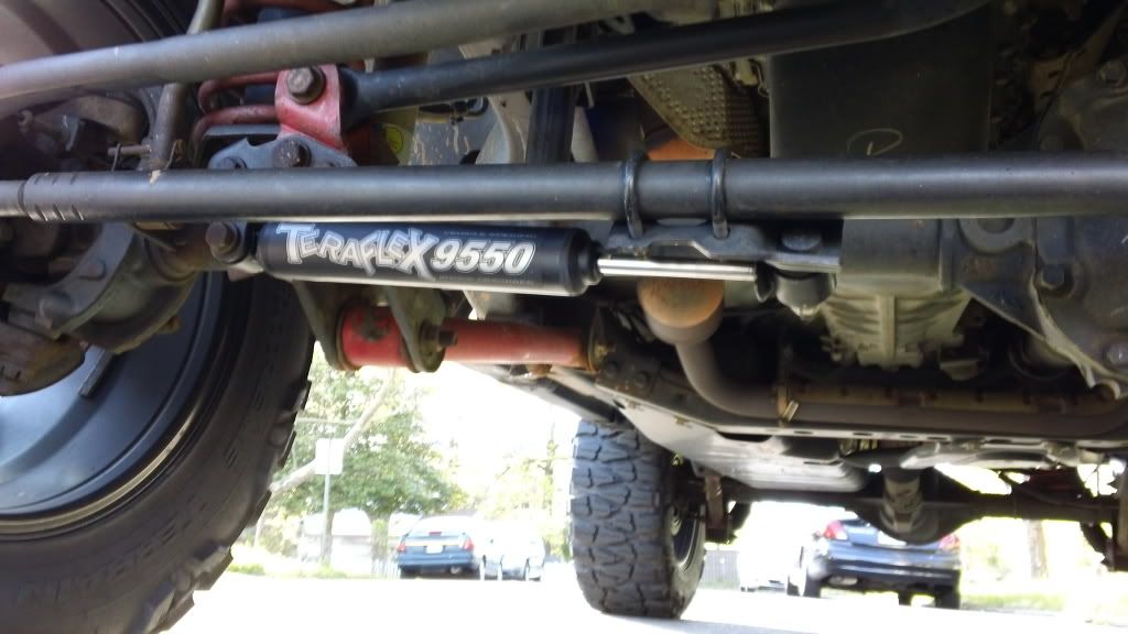

does this look right?

That looks right. I would recommend getting the flip kit for it if you take it off-road. It is in a bad location on the bottom and is likely to be smashed. The flip kit is easy and moves it up and out of the way. I have the JeepSwag.com but there are others.
