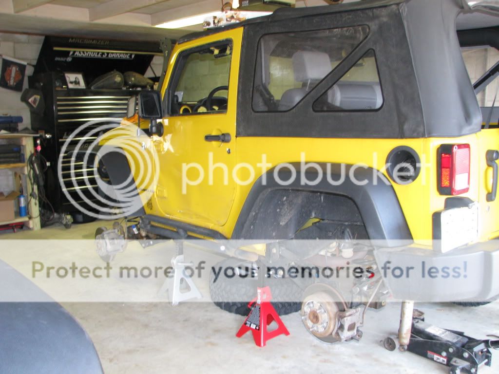

My before & after shots:
Dancin Dan is offline
