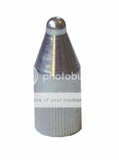

When I search for Dynatrac ball joints, the ones that come up have a grease fitting where the hole is at the bottom of a cone shaped depression. Is that what your Dynatrac ball joints have on them?
If so, the needle fitting isn't the one that should be used. That type of fitting requires a rounded nose on the adapter.[IMG][/IMG]

That one will work as long as it doesn't push directly on the ball. The ball should be moved only by grease pressure.
The really sharp ones will wreck the ball return spring.
