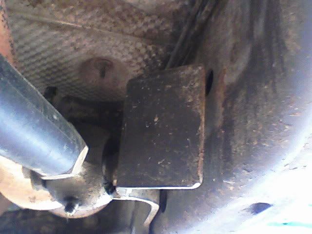

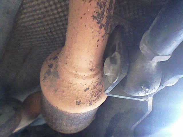

So I've had a rattle for a little while now and for the life of me couldn't accept this to be a cracked manifold (just being outside of warranty) but 99% of me knew it was exhaust sounding the cause, so the other day I started the "find the rattle" game and started up at the engine and worked my way back.
here's what I found...
BINGO!

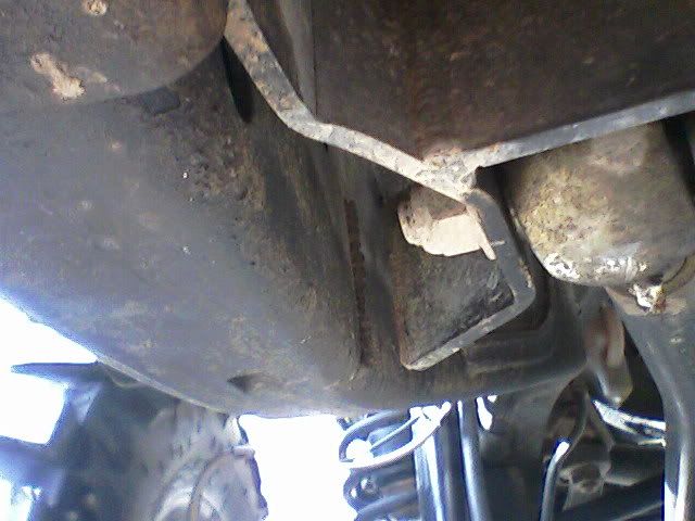

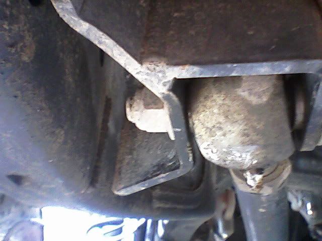

but now why the hell would the control arm bracket and the exhaust be touching you ask?
well...
OUCH!!!! snapped the bracket off at the weld where it meets the frame.
in further examination I found that the upper control arms had also been installed backwards (driver on passenger/passenger on driver). the Teraflex arms have a slight bend to them and with them installed backwards this put excess pressure on the bracket which eventually led to the weld snapping.
boy did I get lucky! this could have been wayyyyyyyyyyy worse had it snapped completely off while driving! not to mention how clean of a snap this was, so an easy repair. so into the shop it goes today.
moral of the story (listen up newbies) and the reason I put this in the Modified Section, no matter what work you get done and no matter how reputable the shop may be, always fully examine the work done. I thought I had done this but the bend in the upper arms is such a slight bend and when laying on your back under the rig it looks "almost" correct. for this reason I cannot fully place blame on the shop that did this. It was installed over a year ago.

Man that sucks! It probably wouldn't have been too catastrophic down the road with three other arms there, but it's certainly NOT GOOD!
Glad you got it caught and can straighten it out. Are the arms labeled?
funny you mention this... YES! actually upon first inspection after the lift was installed I found the driver side tire to be rubbing on the front lower control arm. after checking it out closer I found the font lower control arm to be installed upside down! a sticker on the control arm reads "this sticker faces up". no biggie, chalk front tire, remove control arm, flip, install correctly.
like i said... i thought i had checked everything else out after that but obviously i missed these (again these have a slight bend to them and when on your back under the rig the look "almost" correct)
