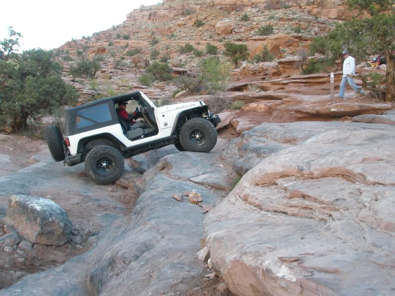

You can easily run 37s on a 2.5" BB, 1" BL, and flat flares.
Then, you can allocate funds towards drivetrain upgrades next (chromoly axle shafts, sleeved and gusseted Dana 44 front axle or a ProRock 44, regearing, etc.).
After all that is done, if you want to do more to the suspension you can--although it isn't necessary.
Here is my write-up on this:
https://jkowners.com/forum/showthread.php?t=31183
Here is what you can do with a 2.5" BB, 1" BL, and flat flares on 37s:
