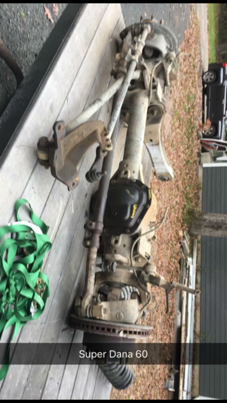

Found a "super" d60 from an 06 F350 for $350
Used a combination of plasma cutter, and cutting disks on my grinder to cut the bullsh*t off, This is a tedious chore.
After a few Bud Lights and too many hours to count, got her looking like this.

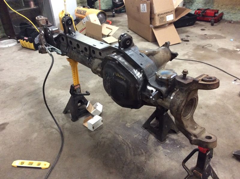

I decided to buy the Artec kit because I didn't want to mess around with trying to get everything lined up perfect. I'm not a Fabricator, I'm a Diesel Mechanic so why not go with something proven?
VERY pleased with the Artec kit. Didn't have to grind ANYTHING and it fit pretty well. For those of you looking to buy and weld this kit on yourself, I would suggest grinding the top of the pumpkin completely smooth. There is a small ridge that I did not grind, and my kit would have fit a ton better if I would have taken an extra 20 mins and ground it smooth.

I had a little fitment issue with the Artec kit, I set the pinion at 10* and the upper control arm mount fits but the bolt hole contacts the caliper mount bracket and I really don't want to cut or grind that... might have to rotate the pinion angle down more to make the bracket clear.
