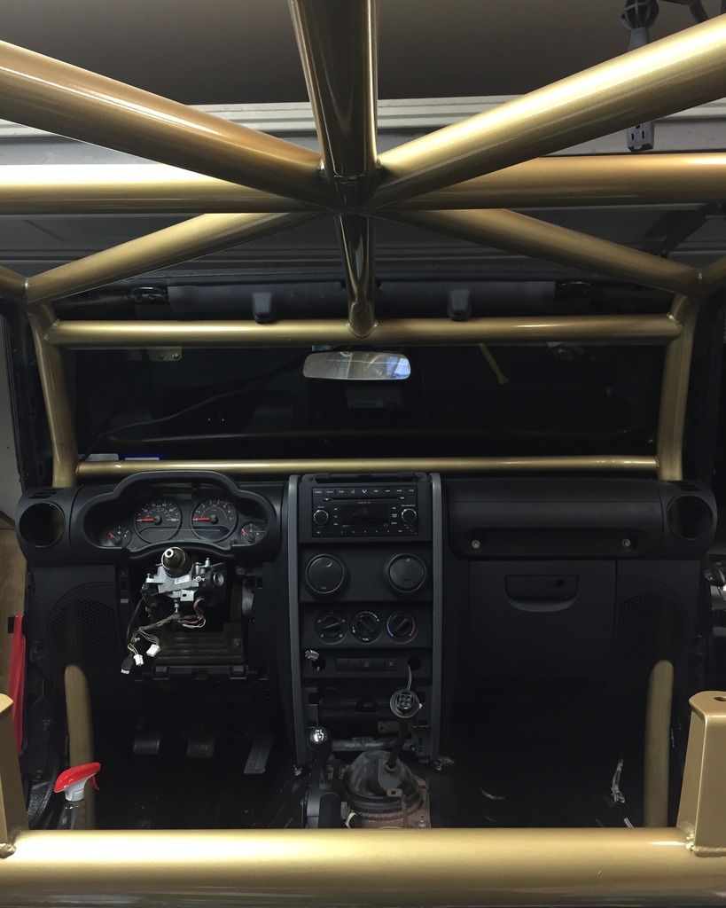

Here is mine before paint. Tied into the frame at 8 points. All 2" tube. Front seat tie ins.

That cage is nice RedRockJeepin! I like the integrated seat mounts, looks strong as hell, Thanks for sharing.

All 2", how much does it weigh? What thickness did you use?

The only part that isn't 2" are the seat tie ins, grab handles and windshield bars. It's all 1/8" wall thickness. Based on our estimate of amount of tube used vs what we took out we figure it only gained around 200 pounds
