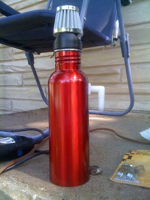

Usually too much fluid. I've seen someone overfill an ARB diff cover, it built enough pressure to leak out of both side seals. You can always add a catch can to the vent line. We use these on our KOH race car for every thing. Psc motorsports builds them. Here ya go. Adam
Hey that looks sorta like my homemade one, cept mine is just made for catching any excess

post #12 of 13 Old 07-15-2010, 08:53 PM
andrelopez99's Avatar
Location: Uvalde, TX
Posts: 2,364
THAT's TOO INOVATIVE! nice job.
