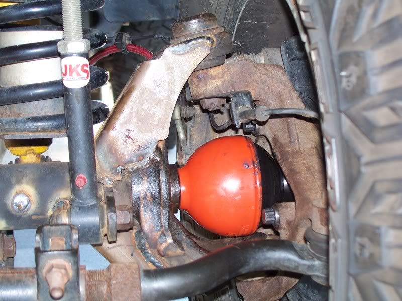

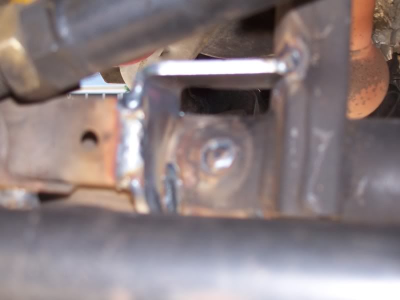

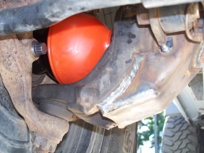

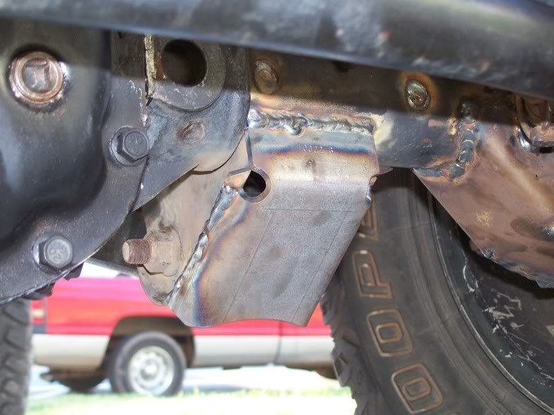

Well, I finally got my jeep back out of the shop. It's been a long time coming. After I trashed my Dana 30, rather than go ProRock or whatever, I decided since the tubes and housing were in good shape, that I'd just beef it up a bit. While I was at it, might as well regear too, right?
So, after much time collecting the parts I finally sent her off to get it all installed, and holy hell am I happy. I drove it in with a gutted front 30, riding on stub shafts and unit bearings.
Drove it home with new 4.88's, Offroad Evolution sleeves/c2 gussets/lca skids, BDS trackbar mount gusset, RCV shafts and finally reinstalled my Woods front shaft. I have yet to pretty it all up with a rattle can, but, here are the "just home" shots. I'll update over the weekend once it has been cleaned and painted.
I am still amazed at how much different the 4.88's feel compared to my old 3.21's. People don't lie when they say it makes a world of difference. Thanks to all of you on here for providing the reading material to help me make informed decisions. And thanks to JoePile for the carrier and Evo stuff.

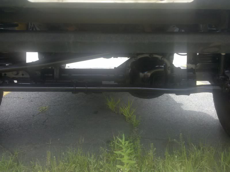

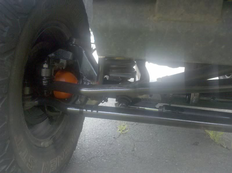

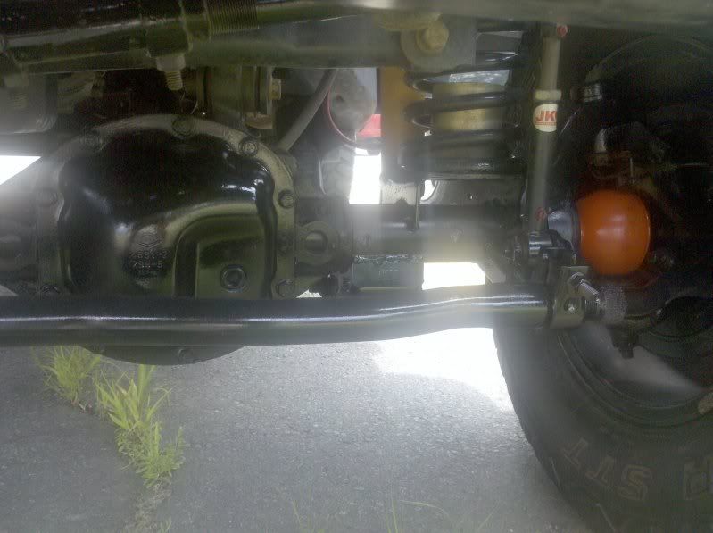

I will have to take some shots with a decent camera later, but, snapped a couple shots on my cell of the finished product.

Looks awesome. Did you just mask and spray bomb it?
Thanks GK. Pretty much. Stuffed rags in the C to wrap around the RCV's, pulled the wheels, brakes and rotors, hosed it down with brake cleaner, and went to town with some high heat engine enamel. Did the axle and all of the new stuff, the knuckles, calipers, etc. Was going to use the flat black grill paint, but, didn't like how it looked after a few months, after the rear was done and wheeled, it didn't clean up well. Will most likely take the ass end apart this weekend and repeat the process. Hell, I might clean up the frame rails too.
I even managed to fix my parking brake while I was under there this past weekend. Feels good to finally have a parking brake after 2 years of not being able to hold my spot on a 1 degree slope.

can someone tell me what the orange things are and what they do? thanks

The orange pluger-looking things are dust covers for the RCV shafts. Basically, I got stronger axle shafts that run a cv joint instead of the standard.
Here is the link to the manufacturer's web page that explains what is underneath that orange cover...
