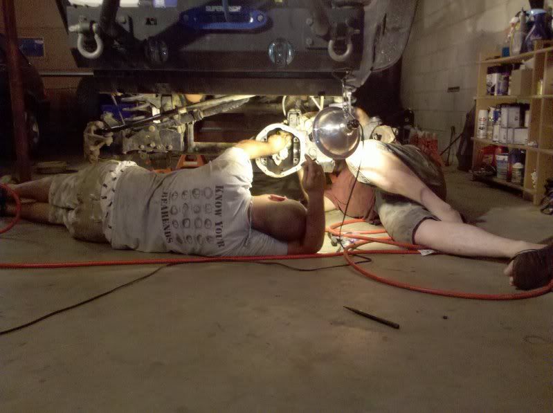

On my phone so they are one at a time
But good progress hoping for alittle better tomorrow
Matt welds sleeves and does front gears while Ryan and I tear down rear axle then swap and put front axle back together while matt does rear gears

Front gears are set rear is torn down
And sleeves are welded on
For tomorrow ryan and I put front axle back together as well as install new steering while matt sets rear gears
Then hopefully wefinish and dot drag on one more day

I was actually wrenching, pulling the dual ss off the tie rod to put it on the currie one(which when I called currie to find out whatsize the nut on the tre was the guy told me I have one of three in existence and they have no idea lol
Front end is put back together
Rear gears will be set after work
Then we should be on the road
jeepnick is offline
