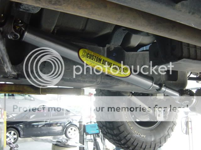

Finally got off my ass and installed the driveshaft and yokes today. Will trail test it this weekend at the event at Hardrock.

What size lift you got and 1310 or 1350?

Also, he's on a lift above so the axles are dropped showing more lift than he actually has...

1310, and I am running a 4.5" BDS lift.
Correct.

How did the EVO rear shock bracket affect your 4.5" lift? Did you have to do anything special to compensate for the higher bottom shock mount location?

Had to change out the rear shocks. The raised lower shock mount made the BDS shock that came with the lift bottom out on the up-travel. Put on a shorter Fox 2.0 shock.
