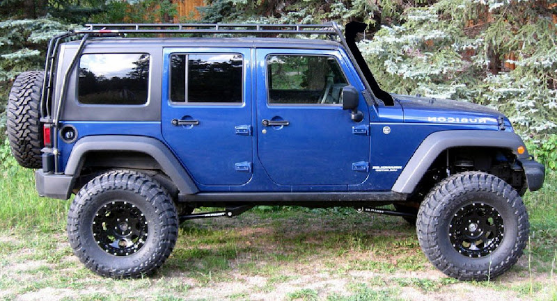

What do you guys think of taking bodyguy's snorkel system and extending the tube up the windshield frame to mount the intake even higher? I like the clean look of where the tube comes out of the top of the hood rather than way down the side of the jeep or hood.
Might look something like this:
Project Blue Bruin Build-Up Blog:
M416 Offroad Trailer Build:
bluebruin is offline
post #10 of 14 Old 01-25-2010, 11:28 AM Thread Starter
bluebruin's Avatar
Join Date: Dec 2009
Location: Conifer, CO
Posts: 216
here is a better version. photochopped.
What do you think?

I think you have a right hand drive Jeep with the stickers on backwords. But I think if you could make it look as clean as the photoshop you may have a winner.

I think this would be the perfect setup combined with bodyguys's inner workings. I'm thinking of using exhaust tubing and getting it bent at a custom exhaust shop to match the countour of the jeep. Seems like a lot better than using pvc plumbing pipe like others have done. Plumbing pipe won't be coming anywhere near my jeep.
The only hesitation I have is once you cut that hole in your hood there is no turning back. scary! I'm used to bolt on mods that are reversible.

I like your idea about the metal tubing but it would nee to be 3.5 to 4 in. tubing I would think....one question to think about is do you ever plan on putting a hemi or a supercharger in? I ask this question only because having the placement there will make it very difficult for anything other then the hesco supercharger.
Second point I would like to bring up and this is not that I do not like the snorkel idea I really do but placing the snorkel where you are looking is one of the most perm. places. as you either have to replace the hood completely and or that metal piece that is right there next to the hinge of the hood. I have already had to replace that piece and it was a huge headache especially to blend the paint to perfectly match after replacing it.
