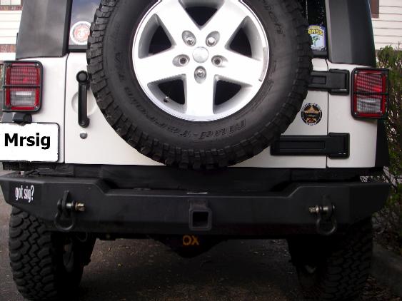

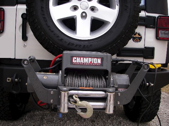

This is what I did??

Two people can move it very easy! It is strapped in like you see in the photo and dose not move at all. I have my cooler on the seat folded down behind me and still have a ton more room in the back. I even have my compressor back there. I have used it a ton of times off road. Many trips I don't even need it and is goes clean back in to the house.
Other time it works it but off!
