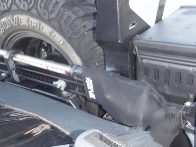

I also added a nice little neoprene coat to keep the winch cozy and out of the elements...
Got one for the Hi-Lift as well, I cleaned it up, gave it a fresh paint job and lubricated it with some dry wax lubricant before zipping the cover on.
