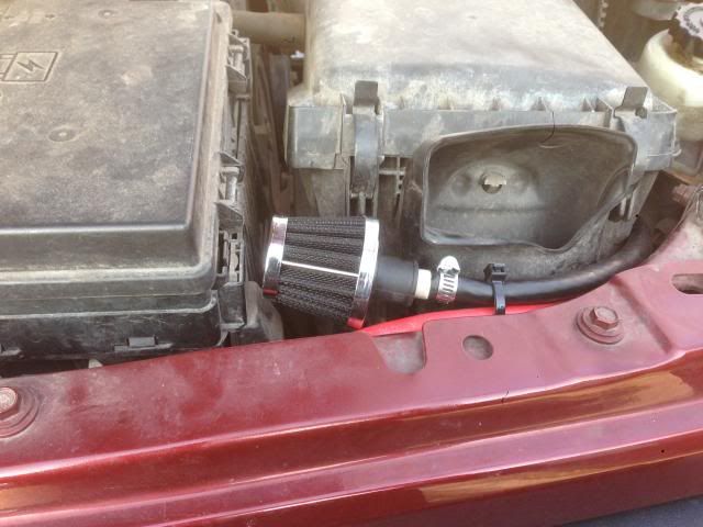

Front Axle breather:
I ran the rear axle and T-case breathers up into the tub and zip tied them behind the tail lights.
