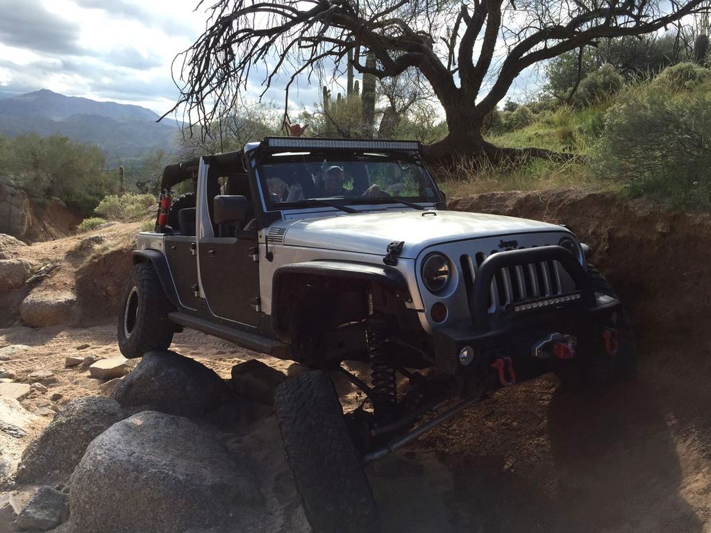

Love my SFZ doors. Had them now for 1.5 years. Light, strong, with latches and releases where they belong.

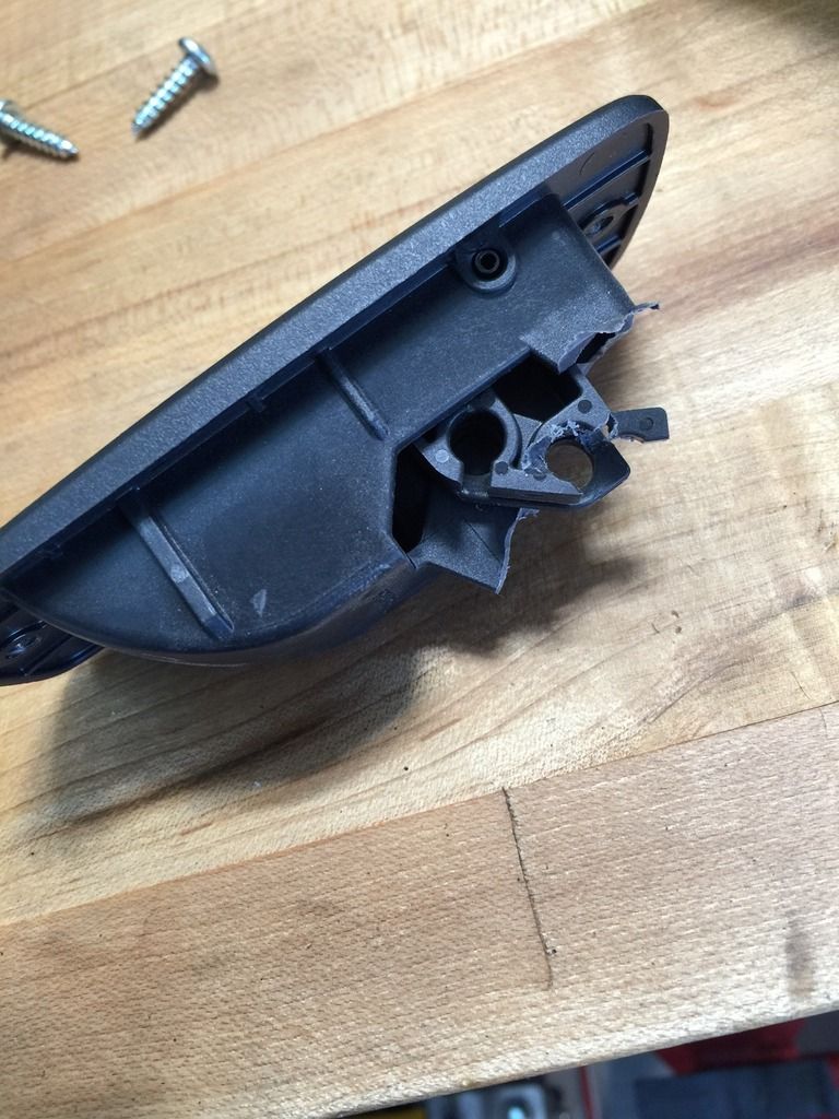

The only problem I've ever had was with the drivers' door interior release latch - the connection point where the bar mechanism that connects the interior release latch with the door latch has broken. Bill Ball (the prior owner) was great about post-sale support and sent me out a new latch. So far, no breakage. He did say that he was looking to engineer a new cable style of connector to alleviate that problem.
Has there been an update made?

Cables did not work out.
We are having the rods bent by a cnc now to alleviate that problem. Hand bent rods sometimes needed more adjustment and caused weak connections like that.
We continue to improve where possible. Thanks for the support.
