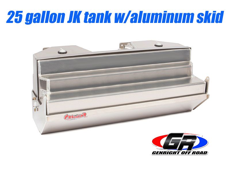

25 Gallon Gas Tank from GenRight Off Road
This is the New 25 Gallon GenRight Crawler™ Gas Tank to fit a Jeep JK (2007 - Current). It is specifically designed to REMOVE the factory tank from under the middle of the vehicle so you can run true Rock Crawling triangulated 4 link rear suspension (yes, no trac bar!).
This tank follows in a line of innovative and trail proven, top quality gas tanks produced by GenRight.
The tank assembly is relocated to the rear muffler area and mounts in a way that still works with your factory gas filler. It even re-uses your factory fuel pump module so can work with all your factory emissions equipment so you won't get any check engine light or have computer issues.
Aluminum Skid:

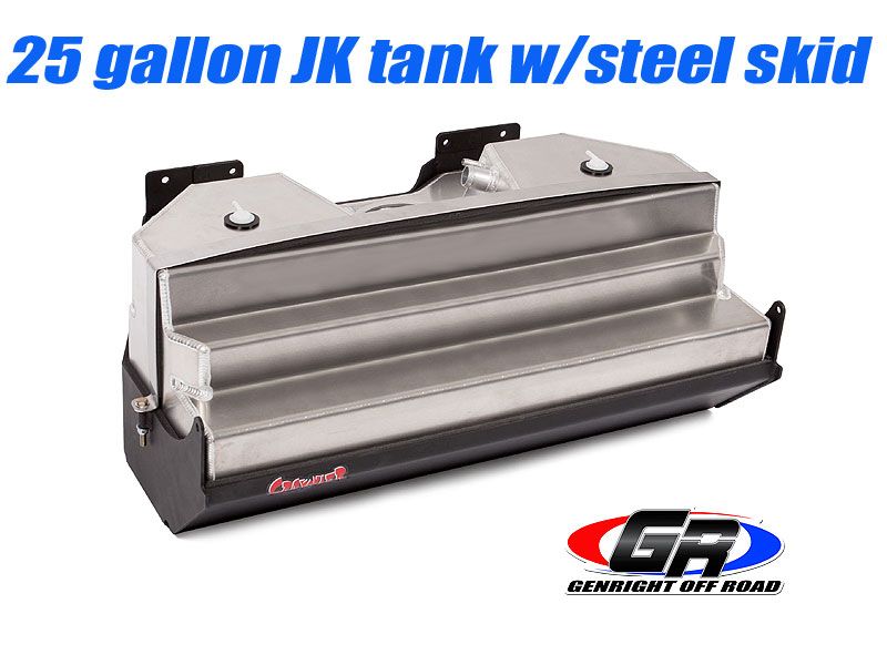

Steel Skid:

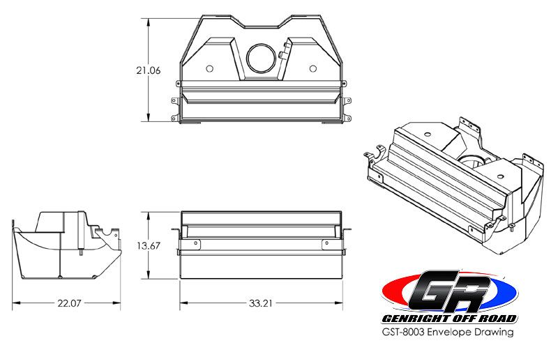

The cad dwg makes it look like you have to remove either the axle or tank to service the diff.
Or does suspension droop usually give clearance?

That drawing is at full stuff.

The picture with the D44 at full stuff looks tight.
Is there enough room for a D60 (Mopar UD60)?

So this is a complicated question…
Only because so many lift kits bolt on a rear trac bar extension and/or reshaped trac bars that stick back toward the gas tank!
That being said, if you are doing a 4 link, then yes you could move the rear axle back.
Here is a measurement you can use with any axle: 20” from the inside of the rear cross member to the diff cover.
That will allow a ½” of clearance between the diff cover and tank skid plate.

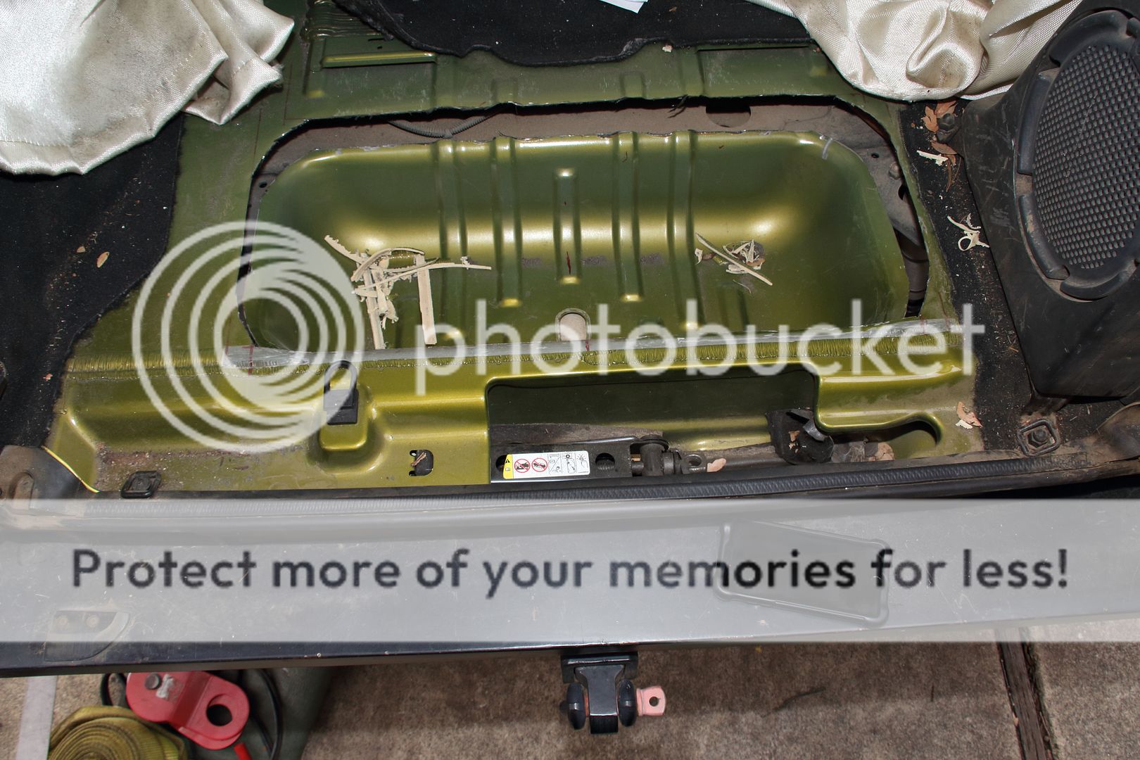

In the process of installing this tank. I was told that I had to buy a new pump or extend my fuel pump to make it work correctly. You guys claim on the website and here that it uses my stock pump. I need this clarified so I can finish this install. I have ran into some bumps on installing the tank but they were issues do to the teraflex long arm and track bar they use. That is all worked out now. I bought the tank so I can do a double triangulated 4 link in the rear with a newer 14 bolt shaved. If it is true that I need to extend my fuel pump what materials would you use and how much longer does it need to be extended? Also would you be willing to do a few photos of that as well. Other then that this tank is a work of ART and wish everyone could see it. It fits snug and very clean. Welds a seamless!!
Here are a couple pics of the install so far
Trunk area needs to be cut out and removed

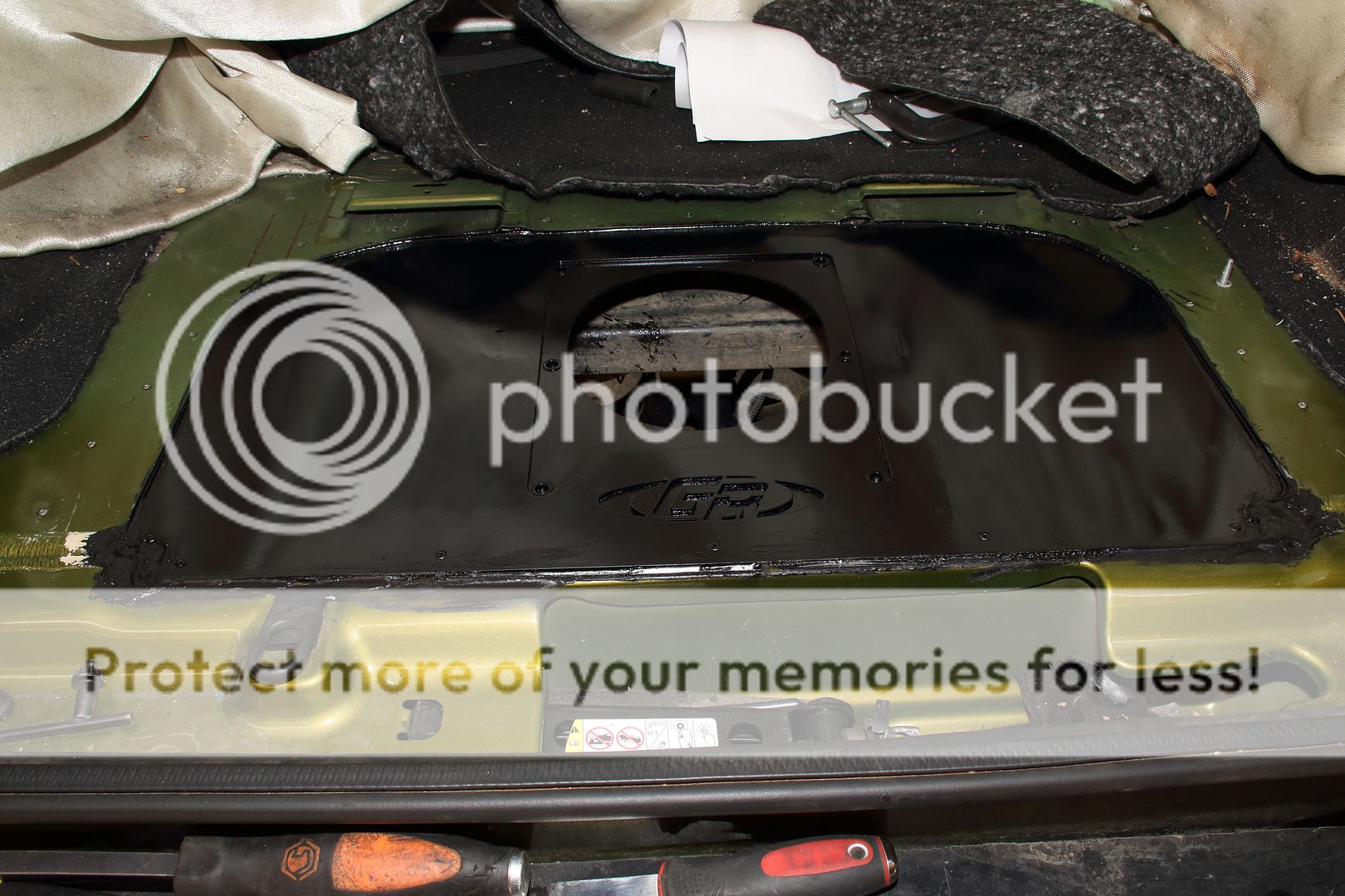

New supplied floor plate with new access hole/plate to service fuel pump--Such a sweet design!!

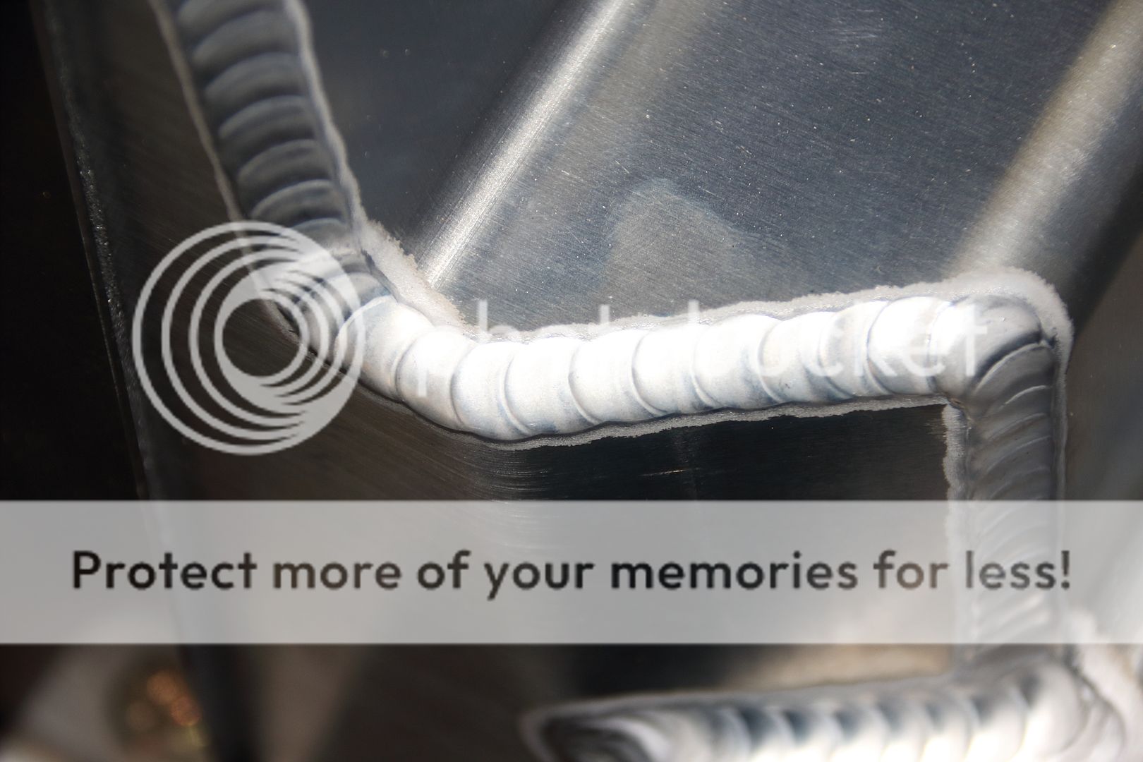

Tank is fully Tig welded

Weld Porn!!! Killer fab work GenRight!
