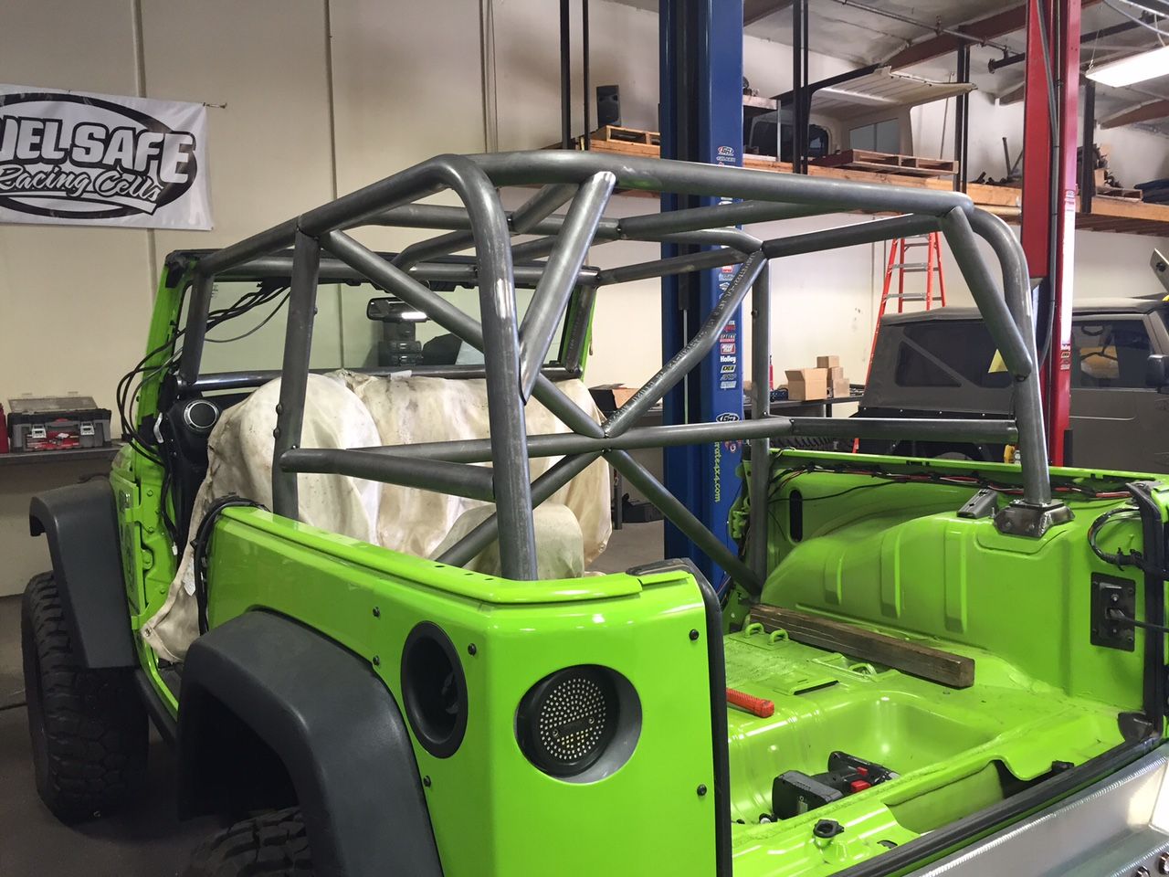

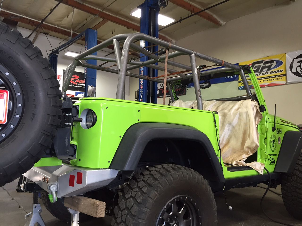

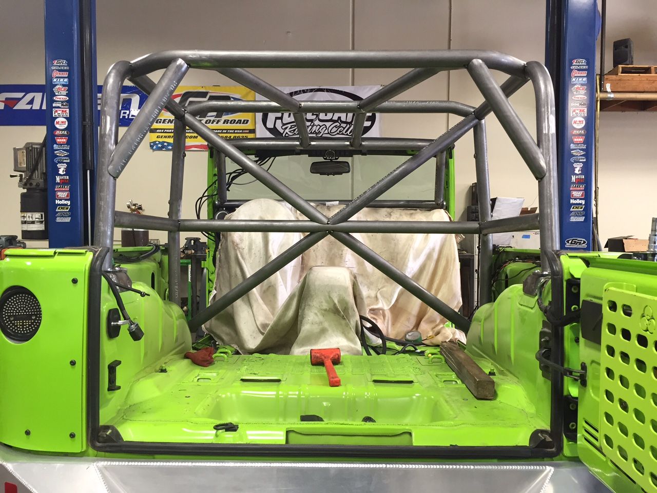

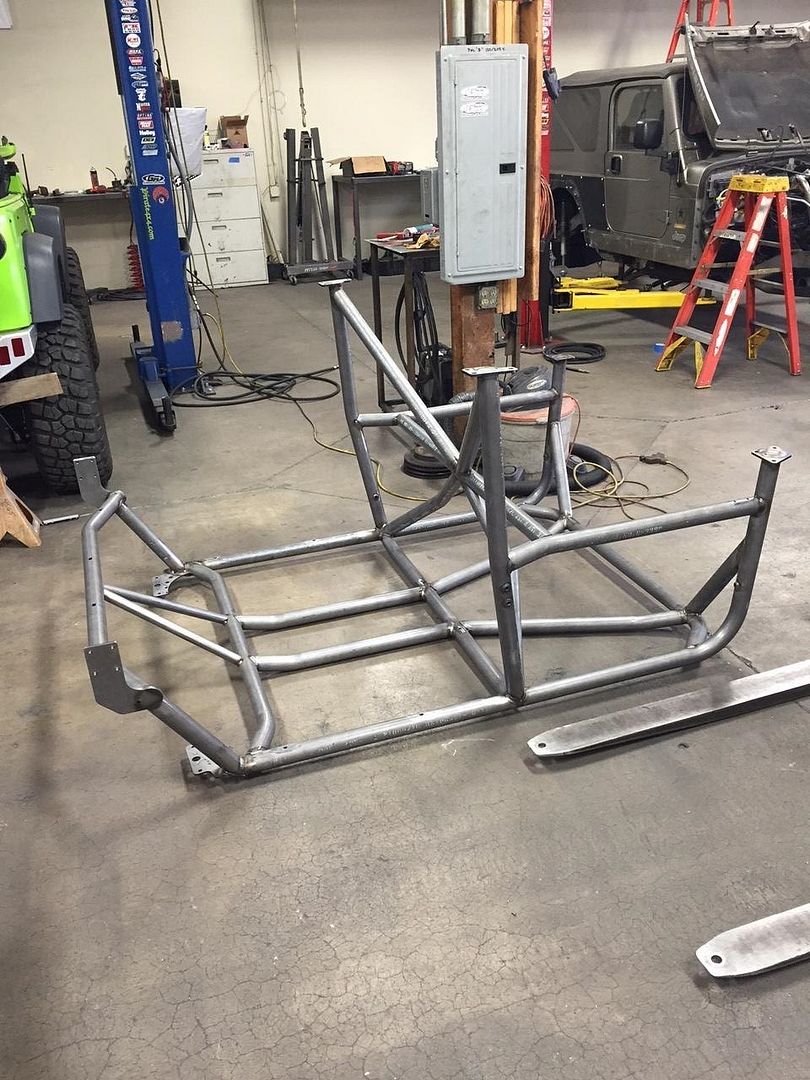

Pics of the new 2 Door JK Cage from GenRight!

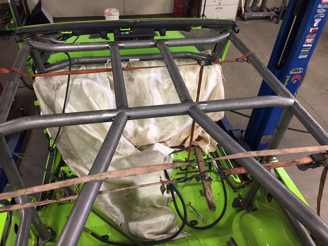

This is the last step before the cage is released! We test fit the cage in a real Jeep!
So if all goes well, this cage should be available in 30 to 60 days!
Questions? Post up!

Will it utilize the two verticle V windshield bars like the 4 door version?
If the windshield is layed down is there a windshield brace sticking out from the top of the A pillar tube or could the brace be removed?

The V is part of the cage, but does not have to be installed if you don't want it.
There will not be anything "sticking out" from the A pillar.

Any plans for real tubes on the front that go through the dash and frame mounts for all 6 down tubes?

Will it the into the frame? Or will there be that option available when ordering?

PS We've had some questions about tying into the frame and the A Pillar design. We worked closely with Engineers from Jeep on this design. That's one of the advantages of our relationship with Jeep!
And as always, you can save 10% on your order of GenRight parts from our website with code "GRCHRISH".

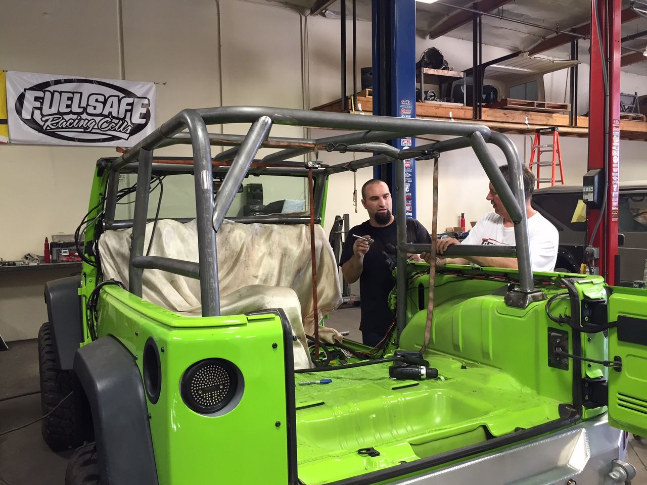

The cage is out for a few of the hard to get to welds and then off to powdercoating on Monday!
Care to elaborate? Just curious.
I was one ... and I haven't seen an answer yet.
Do the engineers from Jeep not recommend tying into the frame and using real tubes through the dash??

Gents,
I'm not an engineer and won't try to imitate one.
I've shared what I know. The guys on the GenRight side have built 4400 class cars that have finished 2nd 2 times at King of the Hammers. We also have a relationship with Jeep that allows us access to their drawings and engineers.
This is the design that they came up with. Is it different? It is. But we believe it is the best possible design.
Everyone will not agree. That's okay. This cage isn't for everyone. You have to give up the factory sound bar and a lot of the interior plastic. But once again, we believe it is the best possible design for a 2 door JK.
If you have other questions, give us a call. We'd be happy to assist.

I just don't get why this doesn't tie into the frame. If you pay someone to build you a custom cage it ties into the frame. And the price...are you kidding me. Just another over priced product from gen right. I will continue NOT buying things from them. Gotta support those KOH teams some how.

I'm not an engineer and won't try to imitate one ...
I am.
The guys on the GenRight side have built 4400 class cars that have finished 2nd 2 times at King of the Hammers ...
Were the cages in those cars full tube and tied into the frame??
It ain't about givin' up some speakers and plastic ... it's about savin' lives. This product should be advertised as a "full sport cage" rather than a "full roll cage". There's a lot of folks buyin' jeeps that are new to the off-road world and should not be led to believe in any form or fashion that this is a protective roll cage. This is a sport cage that looks great goin' topless to the mall.
I would welcome a debate on this issue from either your engineers or the engineers at Jeep.
For a few hun'erd bucks more, a fella can have a true, full roll cage installed at many fine 4wd shops across the country.
I've spoke my piece and I'm done now ... carry on.

This is not a sport cage.
Our owner runs the 4 door version of this cage in our Terremoto JKU. And he trusts it enough to compete in events like RallyVenture with his wife and 2 sons on board.
I've never seen a cage thread on a forum that didn't include a good bit of disagreement. It's expected and acceptable. We all want the same thing..........a safe product.
If you're considering the cage and have questions or concerns, please give us a call.
That's a terrible defense. Lacking frame tie-ins and even the lower part of the A pillar is purposely engineering an Achilles heel into the design. The rest of the cage looks great. Adding tie-ins at the A&B pillars should have been simple.

Difficult. That X behind the seat is important to the cage. With the top down, your best bet would be to hop in over the rear tire.
Does anyone with a 2 door run a back seat?
