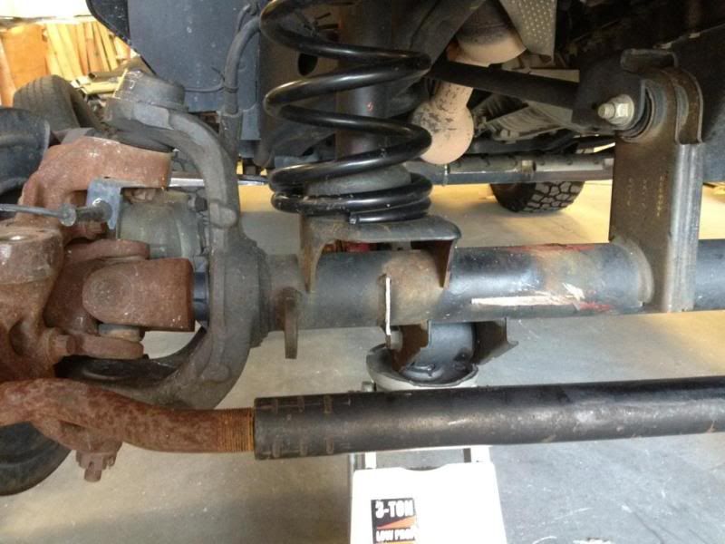

Ordered the parts from Taylor at Rebel Offroad who gave me great prices and service! Free shipping too!! Thanks again
Didn't take too many pics during the install cause I was trying to get it done after working a full day already. Figured I had to get it done cause my next few weekends were booked up.
Off with the stock crappy bracket
New bracket Welded and painted
Sway bar link relocation for drivers side
All bolted up got the Poly Track Bar and Draglink
Ended up using the tapered reamer from this post https://www.jkowners.com/forum/showthread.php?t=13936 instead of the drag link flip adapter.
That's all I got really of the install ended up wrapping it all up about 10:30 last night.

Looks great. Am curious though, what is the advantage of flipping the drag link? Just clearance?

Reduces the force on the steering box, resolves bump steer if you have enough lift to induce it, reduces wander and improves road feel. Also you raise the front track bar mount at the same time, which raises the roll center of the Jeep. Improving it's handling characteristics.

How much lift you have? I have the flip kit but am only using the drag link for now. I know you need like a 3 inch spacer to use the flip kit and I'm worried I'll lose some articulation.

I have the RK 2.5 coils and jks acos spacers up front. Haven't dialed in the bump stops yet though.
